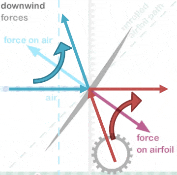

Now I'm no longer disputing the calculation of input and output energy. I'm also not disputing the forces and their orientation in the video. I think the video sufficiently shows that... but:
Concerning frame of reference of the intersection point (seen as the corner made by the blue line in the video), the air does not change speed, just the direction.
In other words, something possessed by the particles of the air, the momentum per air mass, the norm of which gives us the air speed (scalar), does not appear to change here. How then does this cause the kinetic energy of the combined mass of the cart and the ground to increase relative to the intersection point? Maybe it does not!
At 0:52 and 0:53 we see the vectors "force on air" and "force on airfoil", which are both diagonal. The air bounces off the surface of the airfoil at the intersection point. I imagine that the combined mass of the cart and the ground reacts to this air in an equal but opposite manner, as shown by the blue and maroon arrows that I added to the diagram, which are oriented CCW and CW respectively.
So it does not even seem to me that the kinetic energy of the wind even needs to be extracted by the cart in order for this to work. All there needs to be is a deflection of existing energy. After all, if we discount the hypothesis that potential energy is somehow relevant in this system, while at the same time we assume the conservation of energy, then it would stand to reason that "kinetic energy+heat" is conserved both before and after the force interactions. If the air does not lose kinetic energy in the reference frame of the intersection, then neither could the rest of system gain it.
Finally, I would also like to point out that at from 1:07 to 1:22 in the video, the amount that the energy in and the amount of energy out is calculated to be different, even though the friction was not modeled! Clearly the video is not taking into to account the work done tangentially. It turns out that the video as a whole takes into account the work done along the path of the wind and the cart (horizontally that is), but not the tangential work. For example, consider how much faster the prop cuts up through the air than the air itself does. If they took into account the work done by the propeller onto the air tangentially to the wind, it turns out that net work that the wind does on the rest of the system, and vice versa, combining both horizontal and tangential components, is zero from the frame of reference of the intersection between the air and the propeller.
But it does change. I would suggest you research propeller thrust in order to understand what is happening.
Could you elaborate on what you mean by this? It does not make sense to me.
This does not "stand to reason" for me in the sense that it constitutes an argument for the cart using the "deflection of existing energy".
But it does lose energy.

Saying this means you deny that the cart involves the deflection of existing energy. That's like saying that no matter can be changing direction in this system. That has everything to do with blue and maroon arrows in the diagram below:
https://www.physicsforums.com/attachment.php?attachmentid=42518&stc=1&d=1325884076
Your diagram is incorrect. That is what I am trying to help you with. I think talking "deflection of existing energy" in the context of the cart is nonsensical.

Doesn't the angle of deflection of existing energy matter?

By deflection I mean an angular change of the direction with respect to some surface. If by deflection I meant the actual thing deflected, then I should really call this "deflected matter". So what you are taking about is "deflected matter" as seen from the ground point of view.
  • #168
Air is certainly being deflected by the prop. It is being shoved out the back which gives an equal and opposite reaction. That's pretty much the definition of thrust.
This does not help your first post today make any sense however:
Finally, I would also like to point out that at from 1:07 to 1:22 in the video, the amount that the energy in and the amount of energy out is calculated to be different, even though the friction was not modeled! Clearly the video is not taking into to account the work done tangentially. It turns out that the video as a whole takes into account the work done along the path of the wind and the cart (horizontally that is), but not the tangential work. For example, consider how much faster the prop moves cuts up through the air than the air itself does. If they took into account the work done by the propeller onto the air tangentially to the wind, it turns out that net work that the wind does on the rest of the system, and vice versa, combining both horizontal and tangential components, is zero from the frame of reference of the intersection between the air propeller.

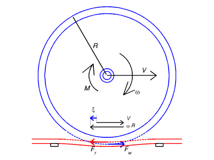

  • #170
A.T. said:
If the frame where the air's KE doesn't change, the carts KE increases while the grounds KE decreases.
Keep in mind that this is strongly simplified picture. The real airflow is quite different, but the result in terms of force on the blade is the same.
See first comment.
Work is done only along the direction of movement, at the rate P = F dot v (the dot product cancels the tangential force component). It is an idealized model that assumes just a short interaction with the blade. The inefficiencies of a real world propeller (like swirling the air tangentially) constitute the losses.
Thank you for spending the time to answer.

I did the animation of spiral track sail to prop.
2 things I think will help people to understand what's going on.
1. Sail carts can frequently "beat a balloon" downwind with a significant factor. Downwind velocity component being 2-2.5 x wind speed. This is well documented and can be studied in many places. People follow their intuition and think that the dw component (for some reason) cannot exceed wind speed. If you argue against this fact then read about it 1st.
2. The wind cart works by using "gearing" and the relative speed differences of the two different interfaces. You can can turn a resisting force to a larger pushing force as long as the speed differences support this.
The breaking power at wheels (ground to wheel) could be for example 10N at 10m/s =100w. Same 100w at 5 m/s apparent wind speed can generate 20N thrust.
Obviously there are efficiencies at play in real application but by using above thinking you can throw different numbers to check what is going on at different wind and cart speeds. You will see that there is plenty of "excess" to be wasted - and thus the cart does work.
