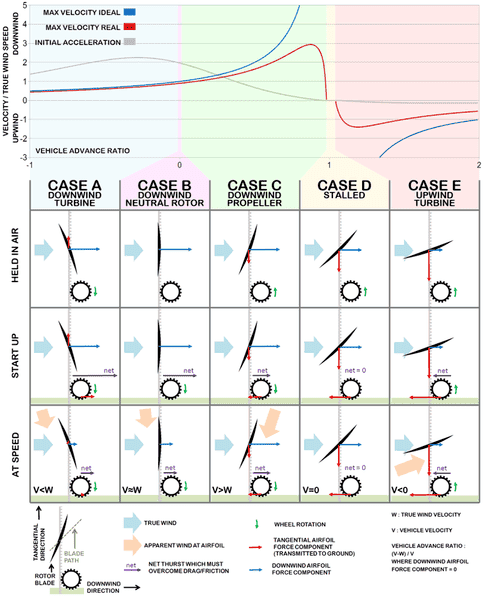

Is there a website with blueprints for such craft?
I want to look at how the propeller is linked to the wheels. I found some photos of Blackbird during construction (on their own website) that shows part of the linkage, but not in full detail. It actually looks to me from the photos that the wheels aid in rotating the prop.
