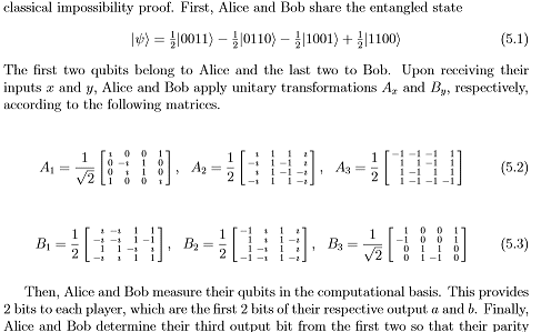

Found the answers on my own.
I found this paper really helpful: http://arxiv.org/pdf/quant-ph/0407221.pdf .
It gives that actual unitary matrices that the entangled bell states must be transformed by (i.e. the gates to apply in each case) in section 5.2. I wrote a program to go through all the possibilities and those matrices are indeed a winning strategy. No idea what they have to do with pauli matrices, though...
Here's a screenshot of the relevant content:
