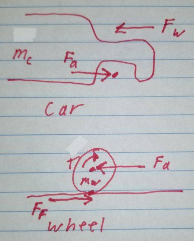

alkaspeltzar said:
This is the best drawing I can muster, I don't know more. Id love someone to fill in the blanks for me. Right now I am just guessing, looking for a real breakdown.
The drawing is a good start. The force on the ground doesn’t belong on the fbd for the wheel, only forces acting on the wheel are included in the fbd for the wheel. The force on the tire is an unknown that you need to solve for. And you are missing the linear force from the car on the axle (not the torque from the engine which you did include).

alkaspeltzar said:
Where does the force from the tires on the road come from? That is my main question
I don't think that's your main question, but the answer is that the axle applies a torque to the wheel, which causes the tire to apply a force to the road and the road to apply a force back.
As for a free body, here is what I have. I am applying a 20 ft-lbs torque to the tire. The tire applies a 20lbs force against the road. The force of friction applies 20lbs back at 1 ft distance...hence aren't torques equal?
Also, how does the static force propel it forward?
You have an extra force and a missing force:
The force the tire applies to the road shouldn't be there and the force the car applies to the wheel should.

  • #36
alkaspeltzar said:
could you draw it out for me? I am just confused.
Hopefully the other mods won't be upset with me, but after several days...
  • #37

  • #48
Here is how you would apply Newton’s laws:
Newton’s 2nd for the car gives
##F_a-F_w=m_c a##
Newton’s linear 2nd law at the wheel is
##F_f-F_a=m_w a##
Newton’s rotational 2nd law at the wheel gives
##I_w \alpha = T-F_f r##
Assuming no slipping we have the constraint
##r \alpha=a##
Our knowns are ##T##, ##r##, ##m_c##, ##m_w##, and ##I_w##. Our unknowns are ##F_a##, ##F_f##, ##F_w##, ##a##, and ##\alpha##. So we have four equations and five unknowns. We need one more equation, such as the wind force ##F_w##. If we are starting at rest then ##F_w=0## otherwise we could have some equation that gives ##F_w ## as a function of the velocity. For simplicity let’s just assume ##F_w=0##. Then we have four equations in four unknowns, which we can solve. When we do that we get $$a=\frac{r T}{I_w+(m_c +m_w)r^2 }$$
We see that this is never zero unless ##T=0##

  • #49
##F_a-F_w=m_c a##
##F_f-F_a=m_w a##
##r \alpha=a##
What force is F sub a? Thanks Dale!
  • #50
Force on or by the axle, from my FBD.
  • #51
