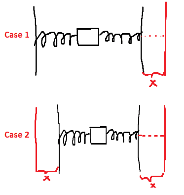

matt that makes sense also but I still can't determine from this whether the force that is exerted on the spring is different in each case.
This is how I think of it:
In case 1 force is applied only from one hand, while in case two from two hands. It's easy to see that in case 2 the displacement of the spring is twice as large, and so the force must be twice as large also, since it's the same spring in both cases, it has the same spring constant. What is wrong about this picture?

This seems different that what you were describing. (I don't know why you have a box and two springs. Can we assume you are still thinking about a single spring?)
In case 2 you have a total compression of 2x, so of course the force you must exert (on both ends!) must be twice as much. (In your previous posts, you claimed that the same force was exerted in case 2, which is not what you are describing here.)
No.
If in case 1 your right hand apply 1 N, and in case 2 both hands apply 1 N, then in your picture of case 2 the distance at each end will be x/2.
Why? Well, I tried to explain it in my previous post.
In both cases, the process of "compressing" (and center of mass moving to the left) in case 1, and "compressing" (and center of mass not moving) in case 2, end exactly the moment in time when the net force on any particle of the spring is zero. And this situation is reached exactly when the distance between left and right ends of the spring has varied a certain amount (you called it x ). And that is because the system is conservative.
Read again my last post and try to visualize what is really happening to each particle of the spring (you can even visualize it better if you imagine the spring is made up of only three particles, 1 2 and 3, separated some distance, and the force between 1 and 2, and the force between 2 and 3, depends only on the distance between 1 and 2, and the distance between 2 and 3 ) both in case 1 and in case 2.
I would gladly put some pictures (with a spring made up of only three particle) with the forces and sure you would understand it much better, but I don't know how to put or make pictures yet.
The thing is that, both in case 1 and case 2, it all ends when (imagine just three particles making up the spring) the force particle 1 exerts on particle 2 (and 2 on 1, and 2 on 3, and 3 on 2 ) is exactly 1 N, and THIS happens (regardless of how it got there, which is different in case 1 and case 2, but it does not matter) exactly when the distance between particle 1 and 2, and the distance between particle 2 and 3, has changed a certain amount (which will be the same in case 1 and case 2 ).
