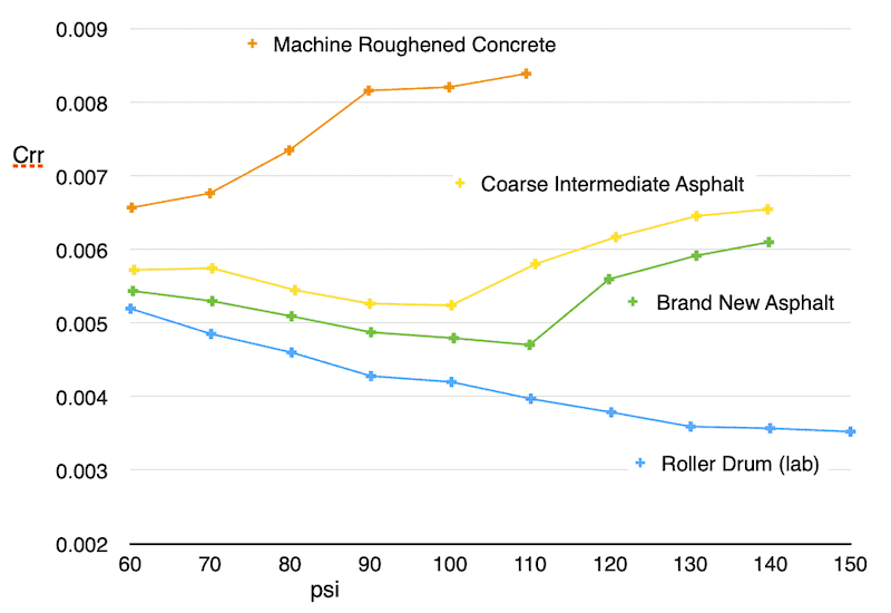

Beings that I used to be an avid bicyclist in my youth, I was really interested in the OP's question.
What I did not expect to find was something I never knew.
According to this article, there is a sweet spot for bicycle tire pressures which varies by surface, where resistance goes up with tire pressure after a certain point.
I digitized the data from one of their graphs as the original was a bit fuzzy.
The Roller Drum is apparently some lab device which is very smooth and is used to generate data which the OP is looking for.
Unfortunately, the real world is a bit lumpy and totally boogers what looks like a very beautiful curve.
Their explanation for this is that at higher pressures the wheels become so stiff that they start transferring energy to the bicycle and bicyclist at increasing rates. Or something to that effect. The last 3 paragraphs in the article try and describe in different ways.
except ... when it gets rough, the cyclist will tend to stand, reducing the energy lost in the bouncing.

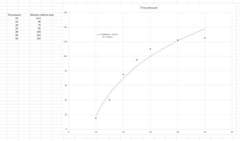

Maybe you just want to do somthing simple lke a regression line fit to some gathered data. The data points I choose ae just made up. "Distance to rolling stop" = 73.888ln(tire pressure) - 151.45.
Your regression might benefit from using an absolute tire pressure, instead of a typical gauge pressure.

I was considering this experiment yes
