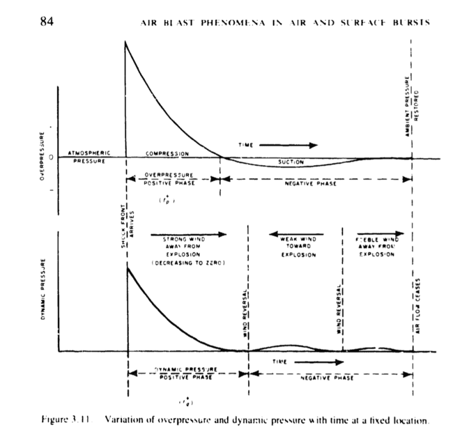

  • #47
Baluncore said:
Look it up in Kinney.
Sorry you've lost me. I can find no reference in Kinney to partial vacuum.
There is a reference to a reversed blast wind:
"These blast wave effects then decrease quasi-exponentially with time until the pressure reaches atmospheric (zero overpressure) after which there is a slight negative phase, as at point C, along with a reversed blast wind."
along with these two diagrams :
to which I referred in my earlier post.
  • #49
It the plural really "partial vacuums" and not "partial vacua"? And isn't this the "end of civilization"?
  • #50
Frabjous said:
What distinction are you trying to make with negative overpressure?
Where did I refer to "negative overpressure"?
  • #52
Kinney et. al. refer to "negative overpressure" only once, in Figure 1.1 C , reproduced in post #53, in the context of the pressure distribution in blast wave where, as explained on p. 90 :
"The overall pressure configuration then consists of an abrupt pressure discontinuity followed by positive and negative pressure phases as indicated by Curve 4 of Figure 6-2. ".
I suspect that the white cloud observed in the Beirut explosion images is the condensation that occurs due to the temperature drop associated with the adiabatic expansion of humid air to below its dew point in the "negative pressure phase" described above. However I can't find any reference to that phenomenon in Kinney or the textbooks I have read.
I would be interested to hear of any source that describes it in a scientific manner.

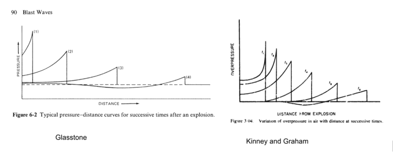

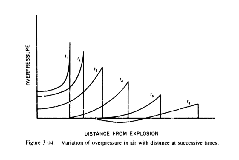

  • #55
I am indebted to Wikipedia for its reference to Glasstone, Samuel and Philip J. Dolan. The Effects of Nuclear Weapons, U.S. Dept. Of Defense/ Dept. Of Energy; 3rd Edition (1977) for its analysis of this cloud (also referred to as a "Wilson cloud").
That paper associates the cloud's appearance to the blast wave propagating through humid air, and the cloud being formed in the "negative phase" of the blast wave where the air pressure drops below the ambient pressure, as illustrated on p.84 :
and, on p.43:
"During the compression (or blast) phase, the tem-perature of the air rises and during the decompression (or suction) phase it falls. For moderately low blast pressures, the temperature can drop below its original, preshock value, so that fi the air contains a fair amount of water vapour, condensation accompanied by cloud formation will occur"
It is left for the reader to connect a) the existence of the temperature drop with that associated with the adiabatic expansion of gas, and b) the formation of the cloud due to the temperature falling below the dew-point of the humid air, but I think the formation of the cloud is well explained.
The mystery for me now is the source of this "negative phase". The presence of the overpressure is easily imagined as the result of the rapid expansion of the hot detonation gases . But what is the source of the negative phase, where the pressure drops for about the same duration as the compression phase, and only starts to appear at some time and distance from the detonation?
It is referenced in both Kinney and Glasstone, but is not explained.

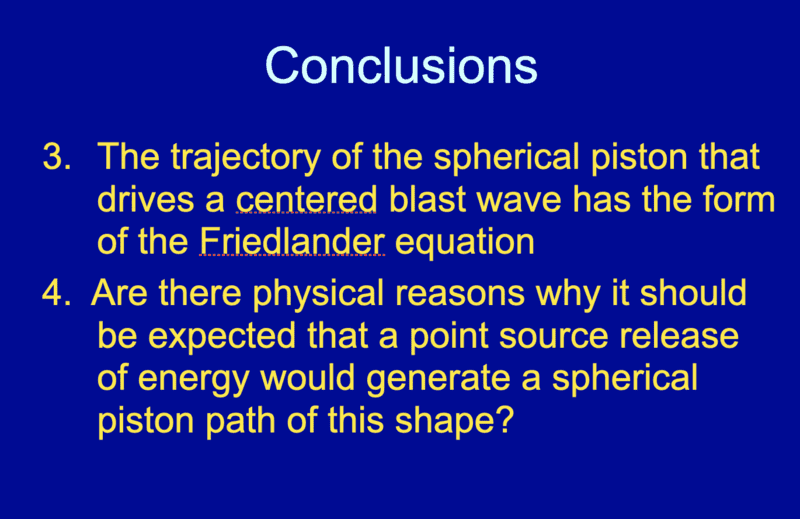

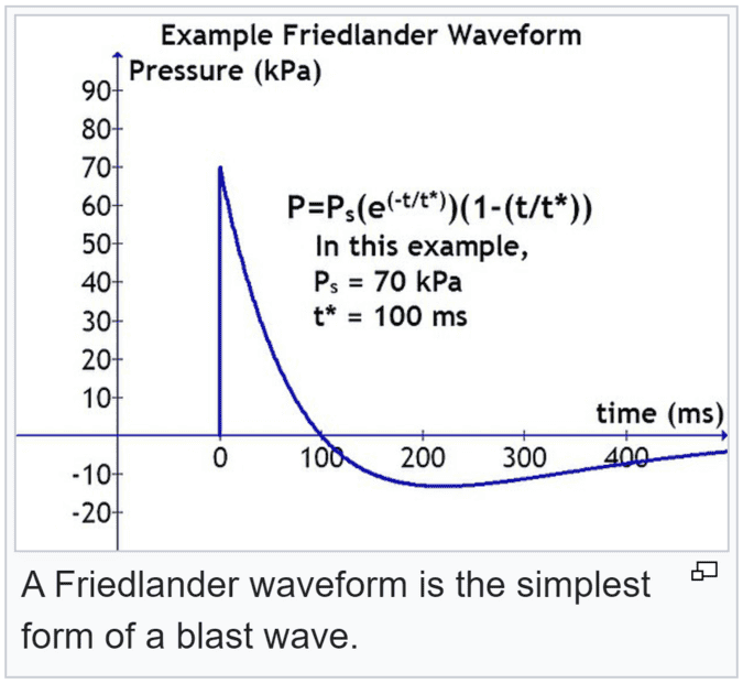

  • #57
renormalize said:
Search for info on blast waves:
https://en.wikipedia.org/wiki/Blast_wave
"In fluid dynamics, a blast wave is the increased pressure and flow resulting from the deposition of a large amount of energy in a small, very localised volume. The flow field can be approximated as a lead shock wave, followed by a self-similar subsonic flow field. In simpler terms, a blast wave is an area of pressure expanding supersonically outward from an explosive core. It has a leading shock front of compressed gases. The blast wave is followed by a blast wind of negative gauge pressure, which sucks items back in towards the center. The blast wave is harmful especially when one is very close to the center or at a location of constructive interference. High explosives that detonate generate blast waves."
I guess my question is along the lines of conclusion 4 of the paper[12] linked in the Wikipedia article :
It would appear that the Friedlander equation provides a close correlation with the experimental data, but it doesn't explain what appears to me anyway, as wholly counterintuitive, why the high pressure zone of the blast wave is followed by this low pressure zone.
  • #58
Atmospheric pressure is greater than zero, so there can be positive and negative pressure excursions. After a disturbance, while an equilibrium is being restored, the pressure can be expected to oscillate about atmospheric pressure. The positive and negative phases have the same periodic duration, simply because they are parts of the same oscillation.
  • #59
Squizzie said:
...but it doesn't explain what appears to me anyway, as wholly counterintuitive, why the high pressure zone of the blast wave is followed by this low pressure zone.
Do you think it's counterintuitive that a region of rarefaction (low pressure) follows every region of compression (high pressure) in an ordinary sound wave in a fluid? If not, shouldn't an impulsive (shock) wave in that fluid similarly have low pressure follow high?
  • #60
Yes, counterintuitive.
Especially as we now have the Friedlander equation that doesn't have any wave-like e{ix}, e{-ix} components.
