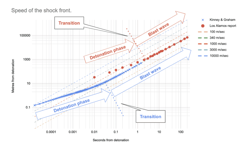

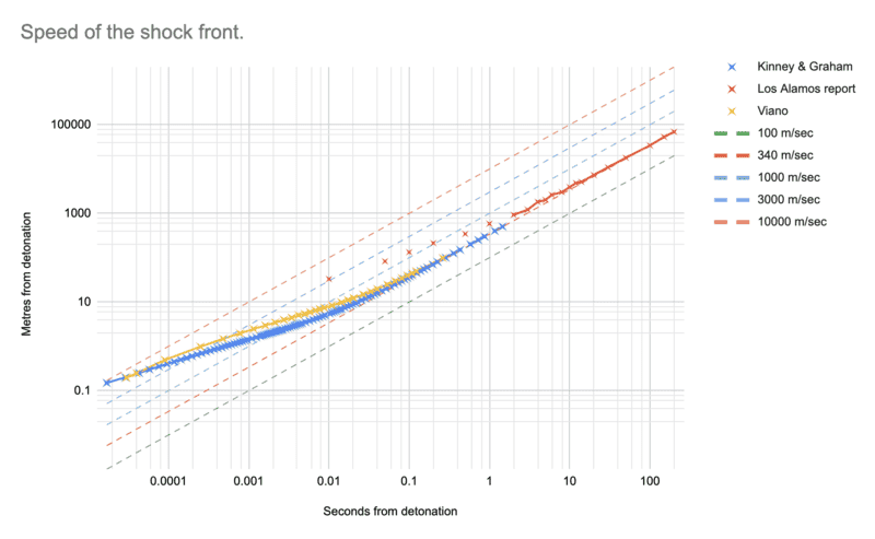

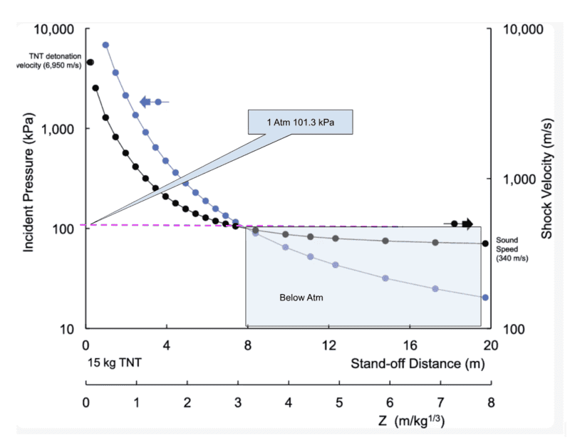

It seems you insist on confusing the back of the shock-front with the back of the blast-wave. Are you a troll?Squizzie said:But don't both Glasstone and Kinney suggest that, if anything, the back of the blast wave travels more slowly than the shock front, causing the back of the blast wave to lag further and further behind the shock front, rather than catch up as the blast wave travels away from the blast?
All your attached plots show the supersonic shock-front as a singular step function of pressure. That maintains its steepness, but the step is reduced in height as energy is lost. Later, things will happen at subsonic speeds.
You need to stop insisting, that the complex system must fit into your oversimplified model. If the theory is too complex for you, then walk away before your head explodes.
