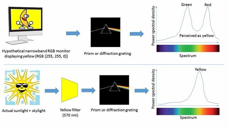

Allow me to explain two sides of the same coin that demonstrate the limitation:
Case A)
Consider a particular, hypothetical RGB color monitor that generates color by combining different combinations of red, green and blue, and that the bandwidth for each fundamental pixel color (red, green or blue) is very narrow. For example, suppose that a given color is produced by using different combinations of narrow bandwidths peaking at 450 nm (blue) 510 nm (green) and 700 nm (red). The monitor would be able to generate very smooth (perceived) transitions between 450 and 700 nm by using different combinations of these three colors.
But this is partially accomplished due to limitations of the human eye. For example, to generate a typical yellow color, the monitor combines 510 nm (green) and 700 nm (red).
The (normal) human eye cannot tell the difference between that combination and an actual, single wavelength at 570 nm. If you were to take a 570 nm, yellow color filter, it would transmit a narrow 570 nm chunk of sunlight that (normal) humans couldn't distinguish from the monitor's yellow color (made by adding two individual wavelengths). And ironically, this 570 nm, yellow filter would completely block out the yellow color from this hypothetical monitor.
But a prism can tell them apart! Separate the colors using a prism or a diffraction grating, and the monitor's light would still form two, separate peaks in the rainbow: one at 510 nm and another at 700 nm. However the 570 nm yellow filter, filtering sunlight, would produce a single peak at 570 nm.
Humans (at least typical humans) cannot tell this apart, but certain other animals can. If we want an instrument to test whether a being can tell the two apart, the RGB monitor alone is not capable of producing both.
Case B)
The bandwidth of a fundamental pixel color (red, green or blue) of a typical monitor is not necessarily all that narrow. A monitor transmitting pure green will produce a spectrum peaking at around 510 nm, but with a wider rolloff, compared with the hypothetical, narrow bandwidth discussed above.
With the wider bandwidths it is conceivable that combining a wide 510 nm spectrum with a widish 700 nm spectrum could sum to a wide spectrum with a single peak at 570 nm (yellow).
But then this monitor would not be capable of producing narrow bands of any particular color; not even the primary, fundamental RGB colors. If we were to test whether a being is capable of distinguishing between narrow wavelengths, again the monitor is not capable of producing them.
Food for thought):

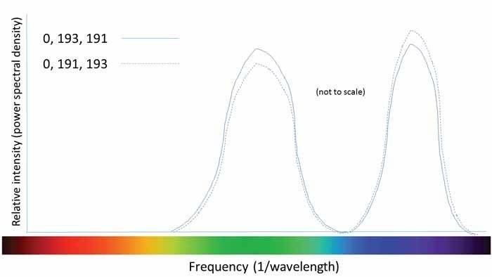

A tetrachromat should be able to distinguish between RGB values 0,191,193 and 0,193,191 (two shades of teal). There's only three colours being transmitted there, but the tetrachromat's extra near-green cones will see the second one as more green and less blue, so they will see two different shades, whereas someone with only one set of green cones will not have enough resolving power to distinguish them.
There's nothing special about their vision when it comes to perceiving narrow frequencies; simply put, they have a ability to distinguish finer gradients of blue-green than others - regardless of how the colours are rendered.
DaveC426913 said:
I think you're over-examining it though.
It might be best explained with a picture.
Figure 1 shows two types of "yellows" that most humans find indistinguishable. If an animal had a type of cone that could detect the 570 nm wavelength in isolation, it might perceive an entirely different color than the yellow humans see by combining red and green light. In that animal, the two "yellows" could be as different of colors as humans perceive green and magenta differently. And that doesn't even address the other possible color combinations with existing colors.
It is not possible for an RGB monitor (narrowband or otherwise) to produce the 570 nm type of yellow in isolation of the Green+Red type of yellow. With narrowband primary colors, the 570 nm type "yellow" is impossible to produce (with RGB) at all. With wider bandwidth primary colors it can be produced, but not in isolation.
This doesn't specifically apply to human tetrachromats only, btw, but rather to color perception in general, to animals limited to certain sets of cones, and how that relates to monitors limited to RGB.
Figure 1. Humans (typical humans) find these two "yellows" indistinguishable.
The yellow used here is just one such example. (Cyan would be the next easiest example.)
There's a whole rainbow of other possible color perceptions for animals having more than three cone types.
[Edit: corrected a typo in the attached figure (originally had 470 nm for yellow rather than 570 nm). Oops. Also, added some text expanding on the ramifications of Figure 1.]
I understand all that.
What does it have to do with RGB monitors making poor test equipment for tetrachromats? (Which was the original issue.)

Sorry if I didn't make this clear before. In order to make a proper "experimental group" you will need a piece of test equipment (in some for or another) that can produce a particular wavelength of light (on the rainbow) that is neither red, green nor blue (nor a linear combination of red, green and blue -- a single wavelength is what we're after).
RGB monitors are great at producing linear combinations of red, green and blue. But they are limited to those.
An RGB monitor is incapable of producing 570 nm yellow in isolation, for example. If you wanted to test for some animal's tetrachomatic perception of this wavelength, an RGB monitor would not be able to produce this wavelength in isolation of red and green wavelengths, making the RGB monitor a poor choice of test equipment for the experimental group of tests.

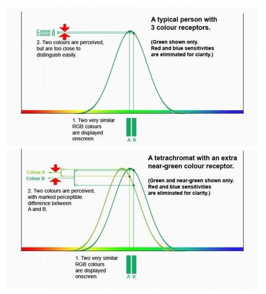

Not true.
"Typical" red cones are stimulated by a wide range of freqs, peaking in the red.
Typical green cones are stimulated by a wide range of freqs, peaking in the green.
Typical blue cones are stimulated by a wide range of freqs, peaking in the blue.
Tetrachromat's 4th type of cones are stimulated by a wide range of freqs, peaking in the green, but not exactly where the typical green cones peak. They don't transcend anything, they merely peak at a slightly different place.
Again, it does not matter how the colours are generated (all cones are stimulated to some degree by all frequencies), they simply have a finer-grained ability to discriminate between them.
Take a look at this, to see how tetrachromats perceive versus typicals:
https://www.physicsforums.com/attachments/84279
Your diagrams are incorrect, when applied to an RGB monitor. You have put two green wavelength peaks (A and B) in your diagrams. And RGB monitor is not capable of producing color peaks so close together. An RGB monitor produces one, and only one, peak of green wavelength. (It also has two other capable peaks in red and blue). (This is neglecting any possible slight overlap in the bandwidth of the RGB monitor's primary color bandwidths. I think that's reasonable, since the primary color bandwidths of RGB monitor are typically much narrower than the bandwidths of our receptor color cones in our eyes).
When adjusting colors, the RGB monitor simply changes the relative amplitudes of these three peaks. It does not and cannot change the actual wavelengths of the individual peaks.
And RGB monitor is capable of producing A, but instead of producing color B, it actually produces color A plus a touch of Blue, not shown in the diagram (the resulting power spectral density function has two peaks -- one at A and other small one in the blue part of the spectrum). But the true wavelength peaks of A and B are both (together) incapable of being produced by the same RGB monitor.
That said, of course our three color receptor cones have wide bandwidths, and even some significant overlap. That's why when we see a rainbow, or sunlight separated by a prism, we can see all the colors, not just narrow patches at red, green and blue.
But those same eyes can still be fooled into thinking we are seeing any particular color of the rainbow by a linear combination of very narrow bandwidth red, green a blue light. That's enough to display a rainbow on a computer screen, and for tricromats, it's indistinguishable to an actual rainbow. It's enough to fool most people into thinking that A + a pinch of Blue, is the same as color B.
Tetrachromats on the other hand, might realize that the rainbow on the computer screen looks a bit bland compared to an actual rainbow. For certain colors, they are not "fooled" by this RGB equivalent of the single color wavelength.
But in order to test for tetrachromatic perception, you need some method to produce both for comparison. An RGB monitor cannot produce both.
If I'm still missing something, it might help if you explain how one could test for a trichromat's green color perception, and how a subject might distinguish green from magenta, if the only instrument around is a defective computer with a broken green channel. (No other instrumentation or tools allowed.)
You're misinterpreting the diagram. I debated how much detail to put in before it got confusing.
Those vertical lines are not narrow light frequencies, they are combined display colours. They are (for argument's sake) RGB 0,193,191 and 0, 191, 193. A monitor is certainly capable of displaying them.
"Combined dispaly" colours? I'm not sure what that means. Perhaps we are talking past each other due to a misunderstanding of how an RGB monitor works.
Below is a more qualitative (not to scale) way of how an RGB monitor produces the colors RGB [0,193, 191] and [0, 191, 193]. Does it make sense now how this is not an adequate tool to use for a tetrachromacy test?
Notice that after combining (neglecting any slight overlap, which I think is a valid approach, given the narrower, primary color bandwidths produced by the monitor), the individual peaks do not change frequency (reciprocal of wavelength), at least not significantly. They only change their relative intensities.
I'm saying the diagram is not depicting two narrow frequencies of light; it is depicting two colours (i.e. 0,191,193 and 0,193,191).
No. I know how they work. Being in both software/.hardware as well as photography, I have a better thna average understanding.
Perhaps this is a place where we can meet. As I said before, it is certainly not ideal to use RGB monitors for study, I was simply making the point that a tetrachromat could distinguish colours better than a typical person, even when looking at a monitor.View attachment 84305
Notice that after combining (neglecting any slight overlap, which I think is a valid approach, given the narrower, primary color bandwidths produced by the monitor), the individual peaks do not change frequency (reciprocal of wavelength), at least not significantly. They only change their relative intensities.[/QUOTE]
Correct. And a tetrachromat will be able to perceive them better.
I'm annoyed, I should have just done the diagram accurately, and damn the information overload.

collinsmark said:
Below is a more qualitative (not to scale) way of how an RGB monitor produces the colors RGB [0,193, 191] and [0, 191, 193]. Notice that after combining (neglecting any slight overlap, which I think is a valid approach, given the narrower, primary color bandwidths produced by the monitor), the individual peaks do not change frequency (reciprocal of wavelength), at least not significantly. They only change their relative intensities.
I have been working on a 2nd diagram, using your example as a basis, if that one makes you happier. It demonstrates the same principle. A tetrachromat's combo of receptors will show a more pronounced difference between 0,193,191 and 0,191,193 than a typical person's receptors will.
I just have a limited amount of time in which to create these graphs.

  • #44
DaveC426913 said:
That's because you ambiguously applied the word: "colour".
You said there's "a fourth colour". There isn't. Colour is a property of a brain.
For a typical human, being a trichromat, there are three primary colors, red green and blue. That's because in trichromats (typical humans) there are only three types of color cones with associated optic nerve connections and brain processing. The brain is able to process these three colors and combinations of them, into what we perceive as other colors (cyan, yellow and magenta are examples of combinations of these three primary colors).
Due to a limitation called metamerism, typical humans cannot distinguish between a single, narrow wavelength in between these primary color wavelengths, and a combination of two primary color wavelengths.
For example, there is significant overlap in the sensitivity of the green and red cones. Filtered light photons with a narrow wavelength around 570-580 nm have an approximately equal chance of exciting the green cones as they do the red cones. This is perceived as yellow. But typical humans can be fooled into perceiving the same color by viewing red light combined with green light.
For tetracrhomats there is a fourth primary color. For them, other colors are linear combinations of these four primary colors. For them, the difference might not be as pronounced as the difference between a trichromat and a colorblind person, but there is a difference.
The human tetrachromat can perceive an actual rainbow differently than a rainbow displayed on a standard computer monitor. Particularly, the difference is in the yellowish part of the spectrum. In a real rainbow, they perceive a color that is not possible to reproduce by a simple combination of red, green and blue light.
Tetrachomats also have a metamerism limitation, but it involves indistinguishable colors involving combinations of their four primary colors, not three as it is with most people.
A single colour can be comprised of a multitude of frequencies.
Yes, due to a limitation (some might call it a weakness) of metamerism.
But they are all part of the same spectrum we are used to, so no extra colours.
Well, there are indeed extra colors for a tetrachomat compared to a trichromat.
Although it might not be quite as pronounced, it's the same idea as saying a trichromatic human can see extra colors compared to a colorblind person.
There is the visible spectrum, all of which we see, through stimulation of our cones that peak in their sensitivity at certain frequencies of light. Tetrachromats merely have a bunch of cones whose peak is more green-yellow than the usual green (ie. lower frequency).
And the tetrachomats perceive that color distinctly -- differently than a trichomat who could be fooled into thinking that a combination of red and green light is that same color.
