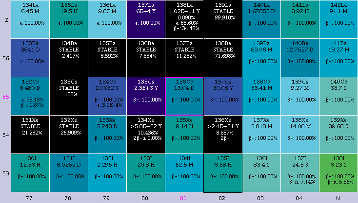

Caesium has a low melting point but a high evaporation temperature. For this reason it should only be found locally after an accident such as Fukushima . Apart from explosions ejecting particulates high into the atmosphere how else is it that it can be found further afield ?

It could be carried with the steam and then deposit on dust. Cs-135, Cs-137 and Cs-138 are also decay products of Xe-135, Xe-137 and Xe-138. Xe is a noble gas, so it is readily transportable in air, and once airborne it decays to the corresponding Cs isotope.
See the attached figure. Stable isotopes are not radioactive.

Has this already happened or is possible it will happen at Fukishima ? How much radioctive Caesium is there a portential to be released and what are the potential affects on the globe ?
