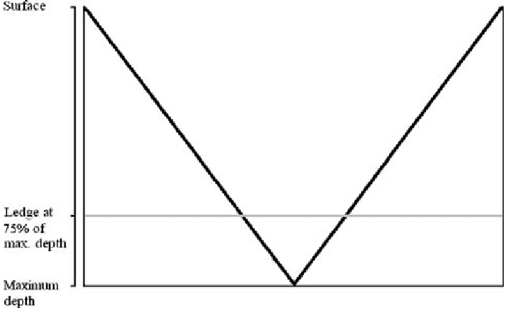

I have a V-shape depression (2-dimensional) with inelastic but deformable material filled.
If the material is pressed atop, how much force will be experienced by the sides?

Schematic-of-a-V-shaped-dive-including-the-ledge-of-the-dive-This-V-dive-does-not-have.png

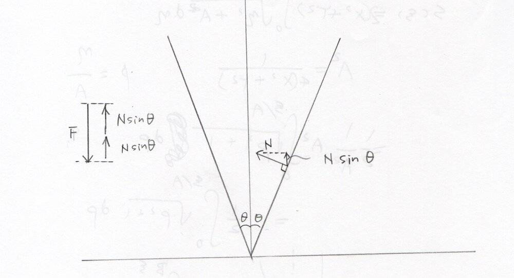

Hi.
Say F is force atop, it is equal to ##2N\ sin\theta## where ##\theta## is angle of both the sides from vertical line and N is force from a side.
N=\frac{F}{2 \sin\theta}

mitochan said:
Hi.
How did you got the result? I am not sure about the \sin \theta, but the force F should be P presumably.
Please find attached sketch to show balance of vertical forces.
mitochan said:
Hi.
Then where does the rest of the force go, for all angles and depths?
N comes from area integration of pressure on a side
\mathbf{N}=\int p \ d\mathbf{S}
