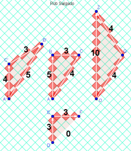

Early in another current thread, I posted some images and applications of the "longitudinal light clock", where the light rays are spatially parallel to the separation of the light-clock mirrors.https://www.physicsforums.com/threads/twin-paradox-help.884180/#post-5558653
https://www.physicsforums.com/threads/twin-paradox-help.884180/page-2#post-5564060
https://www.geogebra.org/m/HYD7hB9v#
For a fuller development,
look at my recent insights
https://www.physicsforums.com/insights/spacetime-diagrams-light-clocks/
https://www.physicsforums.com/insights/relativity-rotated-graph-paper/
