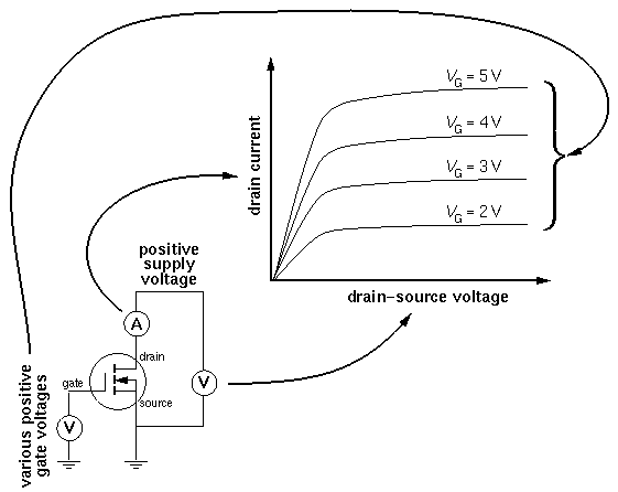

Can i use the circuit suggested in the link below
http://www.maxim-ic.com/app-notes/index.mvp/id/3284
I also found that the FET or BJT resistance varies according to the voltage applied. Do you suggest can i use this principle to achieve my requirement. i have never done this it will be a tough task for me but still i want to try.

Yes you are correct. FETs act like ohmic resistance when not in saturation.
Circuit diagram of an N-channel MOSFET test setup with gate and supply voltage sources, ammeter and voltmeter, beside a graph of drain current against drain-source voltage showing curves for VG = 2 V, 3 V, 4 V and 5 V.
This is probably fastest, cheapest option, but will have to make your circuit very sensitive, you don't have much of a "window" of usable resistance.
http://www.datasheetcatalog.org/datasheet/vishay/70598.pdf
Link included, google for some more :)

Being an Engineer and, consequently, a pragmatist, I would not go for your solution (except to prove that it could be done that way!).
I should find out what the input circuit to the board consists of (can you just not look at the components and the tracks on the board?) and use my common sense to choose a voltage range and appropriate series resistance to drive that input with.
The instructions for using that board will have been written for the convenience of users of one particular application. They make easy for that particular application and harder for another. Get inside the design and go for the more workmanlike solution to your problem.
BTW, how would you provide the FET with the limited range of conditions needed for it to behave as a variable R, bearing in mind that it will be connected to an, as yet, unknown piece of circuit?
