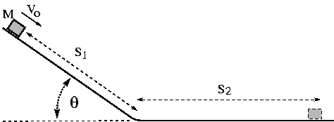

When mass M is at the position shown, it is sliding down the inclined part of a slide at a speed of 1.99 m/s. The mass stops a distance S2 = 2.5 m along the level part of the slide. The distance S1 = 1.18 m and the angle θ = 27.70°. Calculate the coefficient of kinetic friction for the mass on the surface.

The figure you refer to doesn't show up. Can you upload it?
ok, does it show now?
Yes it does. Thanks.
It looks like conservation of energy is the way to approach this. You're given two distances and you should be able to find expressions for the frictional force for each section (leave the mass as a variable, M. It'll cancel out eventually). When the mass comes to rest, all of its kinetic energy will have been given up to work done by friction.

I think you're dissecting the problem too finely as you try to work through the minutia step by step. Let's take a step back. In the broadest picture you've got sources of energy and sinks for energy. At the start there are two sources for energy: The initial kinetic energy of the object and the initial potential energy of the object. At the end all the available energy from the sources has been given up to work done by friction.
So start by adding up your assets. What's the initial total available energy?

Not to harsh your buzz or anything :smile: but you should keep the division between the two sections of the trajectory since they will each experience a different amount of energy loss per unit length. Note that S1 is along a slope so it will have a lower normal force (to cause friction) than the horizontal section S2.
On S2 the normal force is just Mg, so the friction there is μkMg. On the slope it'll be different. You can still equate the starting mechanical energy to the energy lost to friction, but you'll need to take these two sections into account.
The energy lost on the horizontal section is F*d = μkMgS2. What is it on the slope?
if energy lost on the horizontal section is F*d = ukMgS2
I suppose on the incline the normal force would be 9.8M*cos(27.7deg) which means f^k would be 9.8M*cos(27.7deg)*uk
so the energy lost on the incline is 9.8M*cos(27.7deg)*uk*S1?
and that just leaves the energy gained on S1, which would be (5.37*mass)J which is what was the potential energy prior. And, of course, the initial kinetic energy of (1.98*mass)J and I think that leaves me with enough to solve the problem.
Yup. So the total energy lost on both sections is:
[tex]\mu_k M g S_2 + \mu_k M g cos(\theta)S_1 = \mu_k M g (S_2 + cos(\theta) S_1)[/tex]
Equate this to your initial mechanical energy and you're home free.
