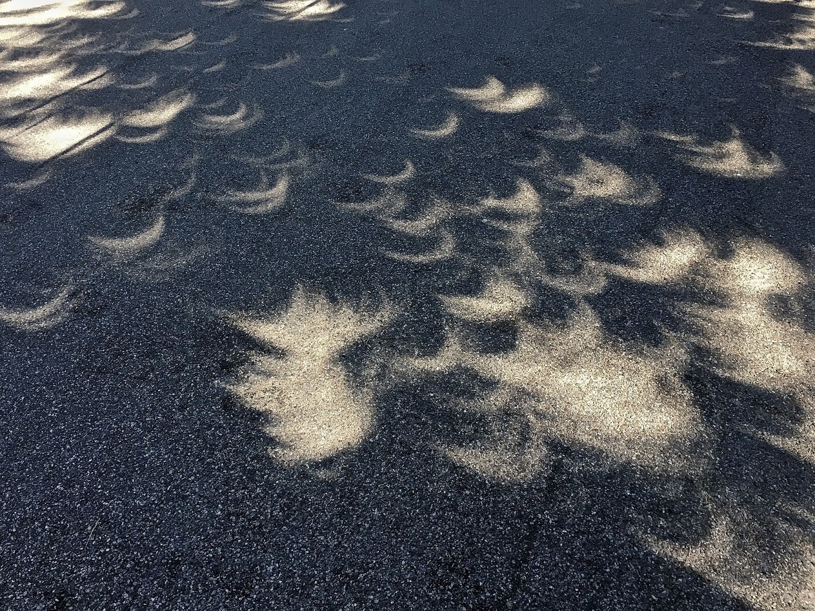

Don't forget that pictures of the crescent shaped shadows, such as caused by "pinhole" gaps between leaves on a tree are also fun. Some of the cameras should point away from the sun to see those fun images also.
A few years ago, I posted some pictures here of those crescent shadows on the body of our beloved late @jim hardy.
Unfortunately it's all buildings around me. There are trees, but not ones that I can go near (the trees are in other people's property; you will not want to mess with those people). We do have a small roof garden, but the plants have lost most of their foliage in the wake of winter. Photos like what @jedishrfu posted is impossible for me to capture.

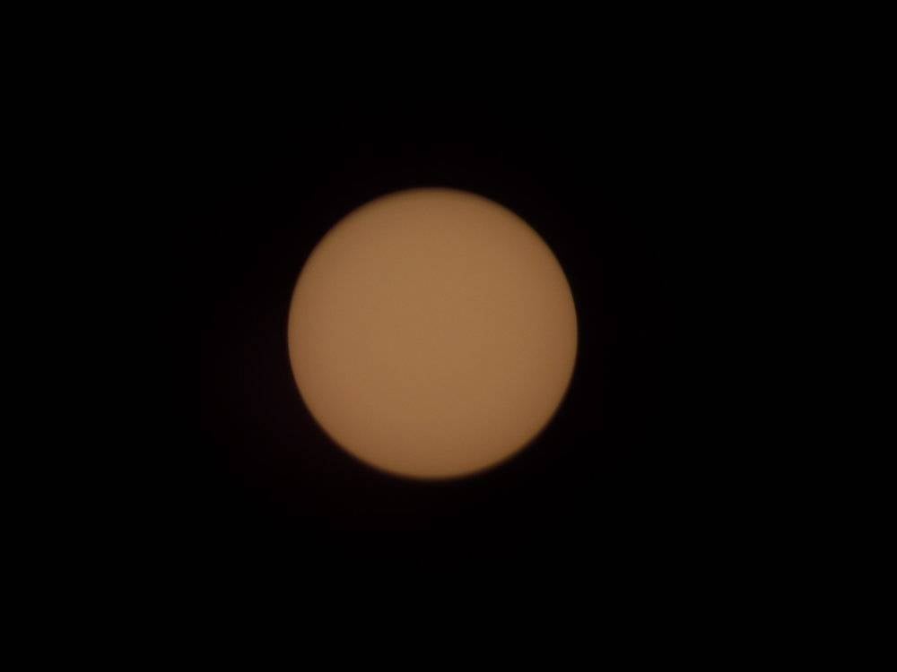

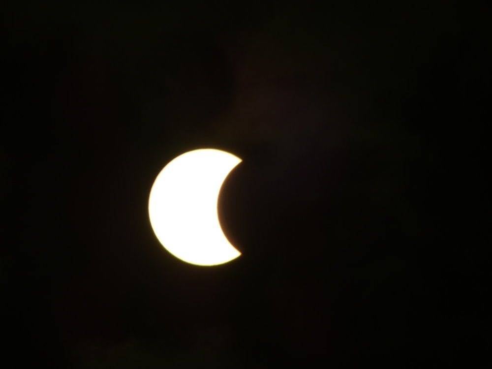

This afternoon I took a risk and shot a photo of the sun. It was around 2pm local time; the Sun was losing its mirth. The settings were as mentioned in the OP. The UV filter was nearest to the lens, and the ND filters were stacked randomly. The circular polarizer was not used.
Before clicking the above photo, I took one snap of the surroundings with the same settings. It was pitch black.
Even window shades or venetian blinds can do the same thing. Prepare for being surprised by having cameras that can look all around you.
Did you use all 4 of the ND filters for this?
When I photograph the sun, I use an OD 4 reflective filter (partially silvered glass). This is important! If your filters are absorptive, you are going to burn them. Similarly, do not use the circular polarizer- you will torch it. And you probably don't need the UV filter since you have the ND filters. For me, using the OD4 filter let's me expose at (IIRC) f/4 and 1/2000s when the sun is high in the sky. Fast shutter speeds are required to freeze atmospheric distortions.
It's also worth mentioning that an OD 4 filter transmits 10^-4 of the incident light, while (for example) an ND 16 filter transmits 1/16 of the light. Use of all 4 ND filters results in a net transmission of 10^-3, so I'm not surprised that your image is overexposed. If you haven't, stop the lens down more.
As a rule of thumb, just briefly look (bare-eyed) through your stacked ND filters at the sun, that should give you an idea about how much light is incident on the sensor.
One advantage you have with stacked filters is that you can remove filters as the sun is occulted to more-or-less maintain the same exposure settings. Regarding the order of the filters, it's hard to say what is 'best practice'. Again, if they are absorptive filters you need to really limit the time you are actively observing the sun.
Yes, all four.
I will not point the lens towards the sun for anything more than the minimum time required to take a photo - zoom, focus, click. I generally use MF rather than AF, especially for shots like these. Depending on the image quality, I will change the exposure values (without pointing at the sun), and then take another photo. Maybe 5s per click. Will this damage the filters?
I reduced the ISO and increased the shutter speed, but did not play with the aperture. Maybe a lower aperture value would have resulted in a slightly better shot.
I think this is unnecessarily pessimistic. ND filters left out in the Sun will not frazzle - neither will most other materials - if exposed for only a few minutes. Not many things will do more than get hot to the touch after prolonged exposure.
Filter damage arises when you place filters in the path of light that's been concentrated by a light gathering lens or mirror. (Near the eyepiece of a telescope for instance)
Of course, at the focal point of a camera lens, the attenuation by front end filters needs to be great enough to protect the sensor (or even the focal plane shutter)

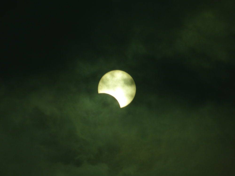

Took another snap today. Settings: Shutter speed 1/2000 s, Aperture f/5.9, ISO 100. Four ND filters stacked together, with a UV filter. Local time: 3-12pm.
One silly mistake that I have made is that, I have not used a timer. The photo seems to be out-of-focus.

Sorry but I don't understand what a timer would be for if you are using an exposure of 1/2000s.
Manual focus is pretty important as the camera will have little information to go on in that scene if it is trying to autofocus. I have found the same problem with astro pictures. The sharpness of focus is subjectively different in a normal scene in which 'some' parts can be in focus and others not, without the picture looking particularly blurry. Solution is to take a lot of exposures and to make sure the image in the finder is not too bright; the eye is not used to focussing on single bright images on a dark background (just like the camera's brain, I suppose). Live view can help if you have it on your camera. Zoom lens controls can be very 'loose' and the ∞ on the scale means not a lot. A stack of ND filters can cause flare if the source is very bright and the flare in the first filter of a stack won't be undone by subsequent filters - unlike with a purpose built high attenuation filter - which will do a much better job of suppressing multiple internal paths.
Ever so slightly, it takes practice and a steady camera. And of course manual focus is essential.
Don't even try with AF. A solid mount for the camera is essential and preferably a cable release
so that you are not physically touching the camera and bumping it. Tho, this last bit, is more
essential for longer astro photos.
Over all it's a great effort :smile:
Just increase you exposure a little, it's a bit on the dark side.
Something between 1000th and 2000th of a sec if the cam will do that
otherwise up the ISO to ~ 200. It will have the same effect

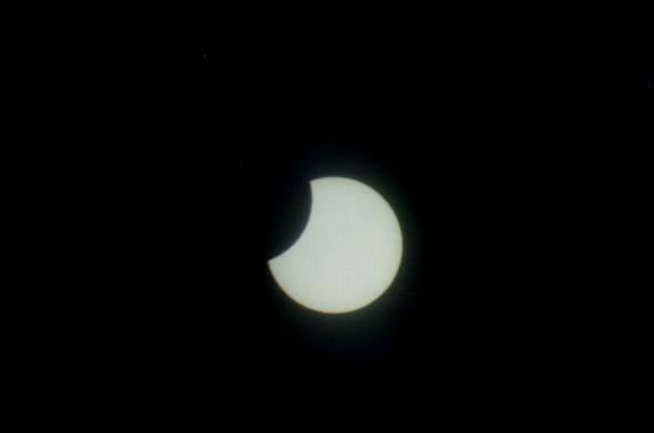

Before buying commercial solar filters for my camera and scope, I always relied on 2 or 3 layers of
mylar film. This stuff is easily obtainable from your local camping store, sold as survival blankets.
It gives the sun a bright white to blue image.

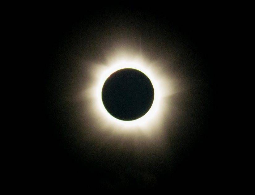

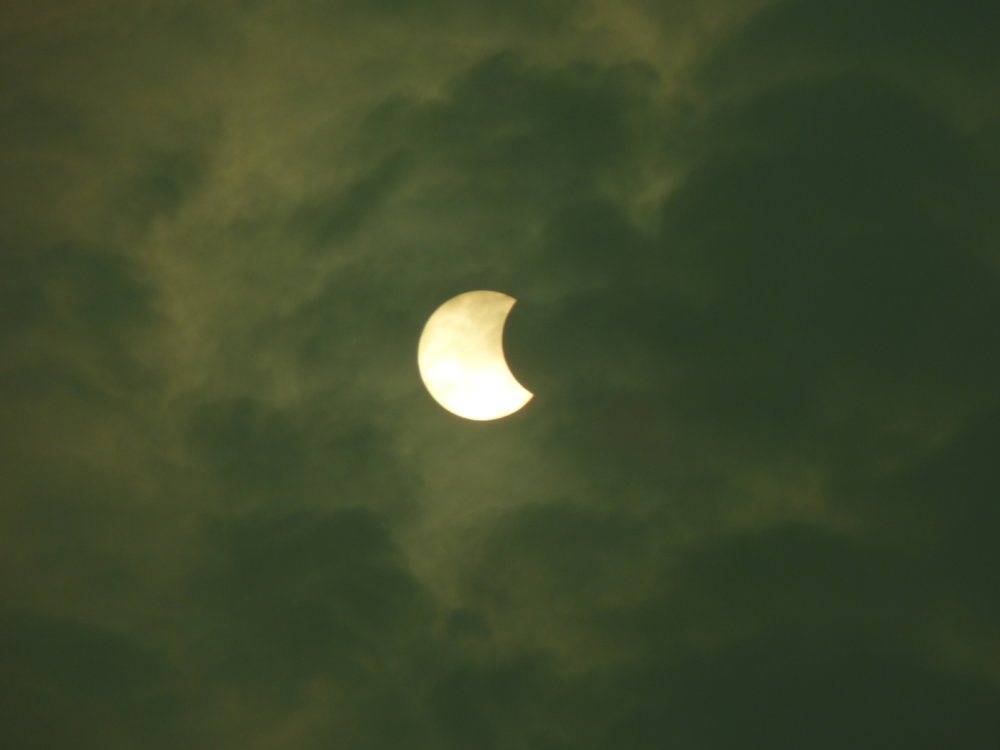

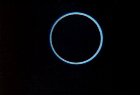

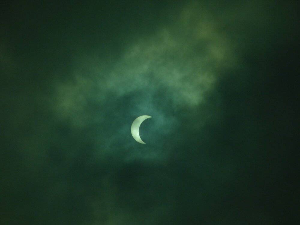

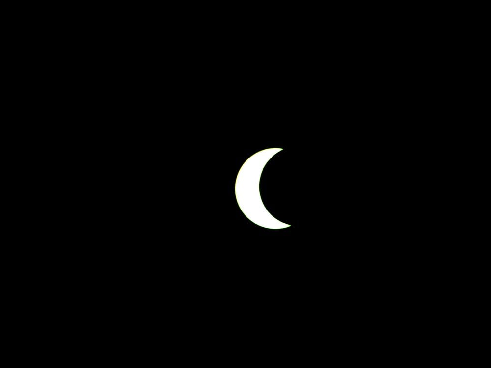

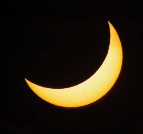

Some of my many eclipses I have photo'ed over the years
1991 annular solar eclipse ...
1998 partial solar eclipse ...
proper solar filters usually give a yellow - orange colour
this is the partial stage of a total eclipse I traveled to NE Australia for in Nov 2012
You can even see some sunspots
Totality (as some one said earlier) requires NO FILTER.

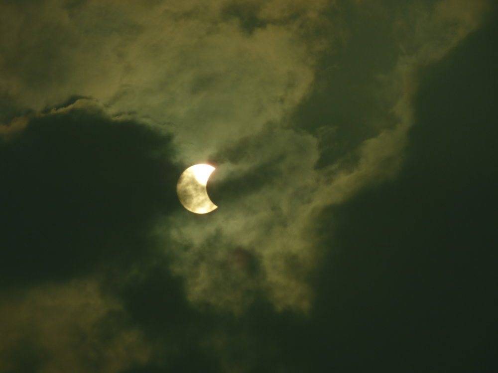

Another couple from Cairns, NE Australia 2012
Totality .. no filter ... diamond ring effect -- 1/100 sec, ISO100
