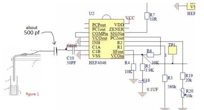

The voltage waveform of the PLL circuit VCOin is shown(The PLL can lock).I need to get the stable voltage.If I change C18 from 0.1uF to 10uF, PLL cann't lock phase,the VCOin is always 5V,How to select C18/R5/R6 of the filter.How to calculate?
  • Schematic of a PLL circuit with HEF4046 and HEF4024 chips, RC loop filter (R5 3.9K, R6 39K, C18 0.1UF) at the VCOin pin, and an oscilloscope screenshot of the TP1 sawtooth-like output waveform.

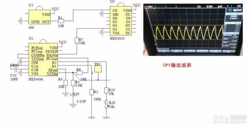

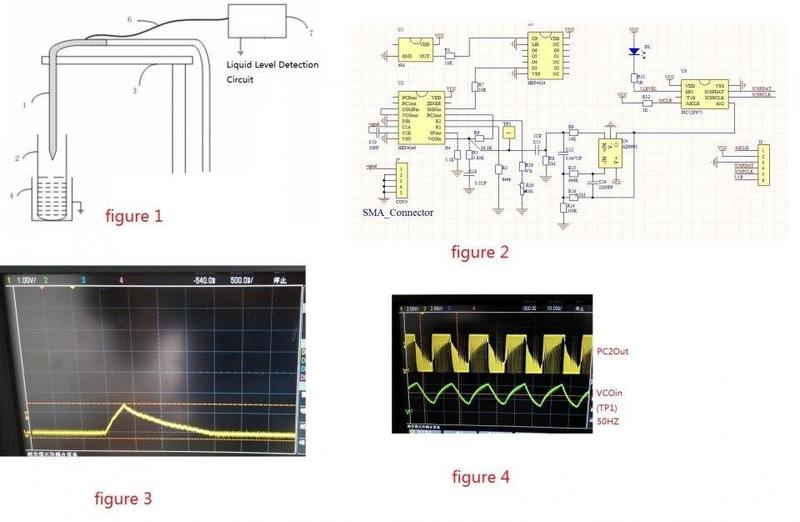

First,I illustrate the application of this circuit,as shown in Figure 1.It is called capacitive liquid level
detection.When the needle touches the liquid level,the capacitance value will become larger.So using phase locked loop
to detect the change of capacitance.My schematic diagram is shown in Figure 2.Network named signal is connected to the
needle.Normally,the voltage of TP1 is 2.5v,if the neddle touches the liquid level,the voltage of TP1 will change,as
shown in Figure 3.However, When the needles are filled with ionized water, the voltage will become unstable,as shown
in Figure 4.The frequency of the TP1 point voltage is 50Hz.It will affect the judgement of the waveform.Now I have two
solutions,one is change the low pass filter parameter of PLL,so it can filter out the interference of 50hz, but to
consider the timeliness of change.Another is to add a notch filter.where to put the notch filter,I want to put it in
the output of OP U4,so the signal is passed through the notch filter before it is passed to MCU.
Now my question is that which will be better,and how to make it.If you have some advice,I will appreciate it very
much.Thank you very much.

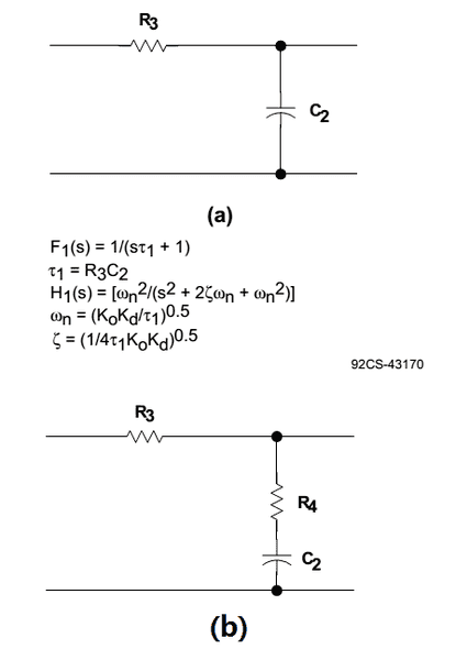

Well slowing the loop filter reduces capture range.
Scanned textbook page titled Capture Range Control, discussing how a large low pass filter time constant in a PLL reduces capture range and lengthens the capture transient.

I just want the VCOin to be DC Voltage. I don't understand why this voltage could fluctuate? (PS:my AC power is 50 HZ).
I feel not very well informed.
What is the frequency you are trying to lock to, i think at HEF4024 Q3 ?
Is fig 3 a scope trace when pll can lock, 0.1uf, and fig 4 when it fails to lock, 10 uf ? What are sweep speeds ?

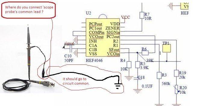

Could be you're picking up 50 hz at pins C1A and C1B from your probe. It looks from figure 1 rather like an antenna. I think those pins both need DC isolation and 50 hz isolation(if you can get it) from signal common.
First thing i'd do is set scope trigger to LINE, if trace stands still then your 50 hz is power line frequency not loop natural frequency. I suspect strongly that's what you'll find.
Next i'd try hooking my probe up like this so it's got some Z in series at low frequency
Circuit schematic of an HEF4046 PLL with a sensing probe on the left feeding signal into pin C1B via a 50 pF capacitor C10, plus R3, R4, R5, R6, R7, R19, R20, C18 and TP1 labelled.
500 pf at 50hz is 6 megohms, what is it at your operating frequency ?
Next thing i'd try is, since your frequency setting resistors R3 and R19 go to signal common and so does your probe capacitance, try connecting your probe to them in turn.
Got to push at this thing and figure out how it behaves.

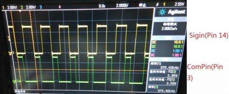

I'm trying to lock to HEF4024 Q3,the frequency is 375khz. But if the needles are filled with ionized water,the PLL can not lock, as shown in figure. It is strange that if I put the ground of the machine to the earth(the real ground),no any changes,the PLL can lock again,put it off the earth,unlock again.
I will connect a capacitor between needles and C10 on your suggestion.Right now I don't have 500pf,is it ok to use 200pf?And you said that"Next thing i'd try is, since your frequency setting resistors R3 and R19 go to signal common and so does your probe capacitance, try connecting your probe to them in turn". I can't see your point.Is the probe capacitance to be C10?what's the meaning of "in turn".
  • Oscilloscope screenshot of two square-wave traces at about 375 kHz, a yellow trace and a green trace, labeled Sigin (Pin 14) and ComPin (Pin 3) in red text beside the screen.

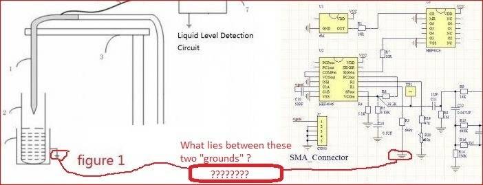

Schematic-style figure with a liquid level detection probe dipping into a beaker, labelled Liquid Level Detection Circuit, beside a PLL circuit board schematic with two ground symbols and a hand-drawn question about what lies between them.
Any voltage between them is injected right into your PLL's C1A ,if i read correctly the image attached to post #1.
Might be that 'earthing' the signal common on circuit board removes any voltage between it and the beaker of deionized water.

"Ground" is a much abused term. Usually it means 'signal common' or 'zero volt reference point' as in right part of your drawing . It means "earth" only if physically connected to earth, which clearly in an airplane or rocket it's not.
Is your beaker connected to Earth by a wire or metal counter top ? Is your "signal common" connected to Earth through the oscilloscope probe ? Is there any voltage between them?

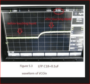

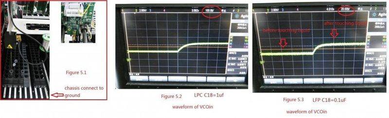

Thank you a lot.Figure 5.1 shows the neddle connects to the circuit and the tube. The gnd of circuit is connected to
the gnd of machine.
Today I try to change C18(the low pass filter cap) from 0.1uf to 1uf.The waveform of VCOin can be stable,as shown in
Figure 5.2,the figure 5.2 shows that the waveform of VCOin before and after touching the liquid level.But the response time will be longer.This will cause the needle to overshoot at the level of the liquid.Now solved a problem and lead to another problem.I am going to crash.
Looks to me like you've solved your problem. It appears to never lose lock ?
Fig 5.3 also locks . I am unable to read what is the time per division on your 'scope
but there's no more line frequency.
That "hash" at VCO in is at your operating frequency hundreds of khz?
If you measure at capacitor C18, other side of R5, you'll see DC without the hash. Then you'll be able to reduce C18 for faster loop response.
I would try a 0.01uf C18, too. It's only 1 ohm at your frequency. That'll speed up the loop, and you can begin exploring those closed loop equations.
I hope you'll try wiring your needle to R3 and R19 , just to see what happens.
Looks to me like you've solved your problem. It appears to never lose lock ? Fig 5.3 also locks . I am unable to read what is the time per division on your 'scope
no,i don't solve my problem.using 0.1uf (C18) ,the VCOin can not be stable, the frequency of the hash is 50HZ,you can watch the figure 4 at 3# where I posted.If using 1uf,the VCOin have no hash,but the rising time will be 5 times before. It is unacceptable.
Well then , what's figure 5.3 attached to post 13 ? It says C18=0.1 uf and there's no 50hz.
Oscilloscope screen photo showing a waveform of VCOin with a flat low section that steps up to a higher level on the right; labelled before touching and after touching regions, Figure 5.3 LFP C18=0.1uF.
i am confused.
Sorry about that,because i put the ground of the machine to the earth.
Looks to me like that solved it.

To what did you connect your oscilloscope probe reference lead ? See post 21.
