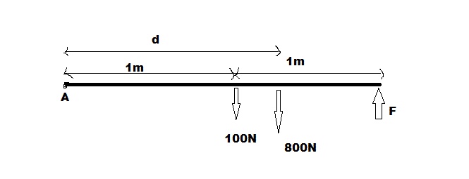

1) Two men are carrying a 2m long 10 kg pole which from which is hung a 80 kg deer that they have shot. How far from the end of the pole should the deer be hung so that the weaker of the two men only supports half the load of the stronger?
Answer is (63 cm)

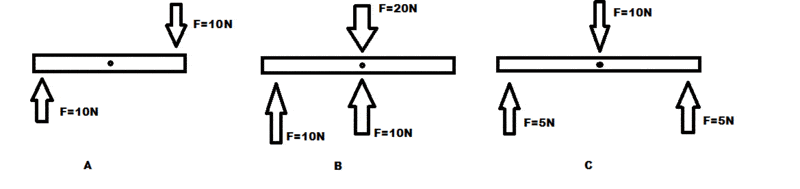

For an object to be in equilibrium,you need two things:
1-Net force is zero
2-Sum of the clockwise moment about any point is equal to the sum of the anticlockwise moment about that point
Moment=F x perpendicular distance
Try to draw a Free Body diagram.
Look at Diagram A,Here Net force is zero,but 2 doesn't apply-Not equilibrium
Diagram B,again net force is zero,2 doesn't apply-Not equilibrium
Diagram C,Net force is zero,2 apply-Equilibrium
If Net force is not zero,It will be accelerating
If Sum of the clockwise moment about any point is not equal to the sum of the anticlockwise moment about that point,It will be rotating
  • Three free-body diagrams labelled A, B and C, each showing a horizontal bar with a pivot dot and vertical arrow forces. A: 10N down at the right end, 10N up at the left end. B: 10N up at the left end, 10N up at the centre-right, 20N down at the centre. C: 10N down at the centre, 5N up at each end.
Answer is (63 cm)
Object is in equilibrium
Firstly,find the two forces,weaker man gives F/2 and stronger man gives F.Together these two forces support the weight of the pole and deer.You can find the force this way.-Net force is zero
To find the distance,you have to make use of the "Sum of clockwise moment of any point is equal to sum of anticlockwise about that point.
The clockwise moment of the point, weaker man(A), should be equal to the anti clock wise moment about that point.The force given by the stronger man provides the anticlockwise moment.Clockwise moment is provided by the weight of pole and deer.
τ=F x d
Look at the free body diagram.Once you find the force F,You can find the anticlockwise moment.Using the weight of the pole and deer,clockwise moment
Then you can solve for d
Even if you find the moment at point,stronger man,You will get the same answer because sum of clockwise moment about any point is equal to the sum of anticlockwise moment about that point
  • Free-body diagram of a horizontal beam labelled A at the left end, with a 100N downward force and an 800N downward force along it, an upward force F at the right end, and lengths of 1m and d marked above.
