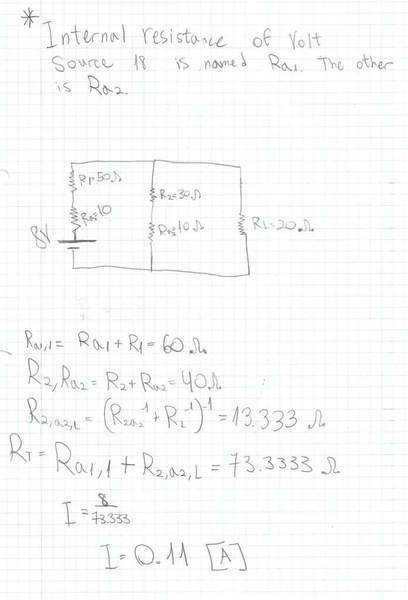

I got my scanner now :) and I quit goofing around with my webcam (*coughs*) and am ready to solve B.
How did I fare? (attached)
Sorry, but you can't replace the 2 batteries like that. ;)
[edit] They'd have to be in series to do that, and they aren't. [/edit]
The way I'd do it, is to apply Kirchhoff's laws.
First make a round from the 18 V battery through RL back to the 18 V battery (voltage law).
This will give you an equation with I1 and IL.
Then make a round from the 10 V battery through RL back to the 10 V battery (voltage law).
This will give you a second equation with I2 and IL.
Then look at the crossing of the wires where current in must equal current out (current law).
This will give you a third equation with I1, I2 and IL.
Solving 3 equations with 3 unknowns will give you the solution.
Ain't that 3 unknowns in this equation?
So, I'm ignoring the parallel portion in the middle? In that case, it turns into a series circuit. Shouldn't there be only 1 I?
No, only 2 unknowns.

Sorry no.
R1 and RL are not in series, so you can't add them.
What you have is I1 going through Ra1 and R1, and IL going through RL.
The corresponding voltage differences must add up to 18 V.
The unknowns are I1 and IL.
And yes, actually it's a lot like mechanics, were you separate the system in subsystems, and each subsystem must be in equilibrium, yielding a couple of equations.
So here it's like the sum of moments (read: voltage differences) that must be zero.
A moment is a force times a distance.
A voltage difference is a current times a resistance.

Perhaps I should show you how the first equation is set up.
The current I1 goes through Ra1.
The corresponding voltage difference is I1 x 10
The current I1 goes through R1.
The corresponding voltage difference is I1 x 50
The current IL goes through RL.
The corresponding voltage difference is IL x 20
The battery gives a voltage difference of 18 V.
So the equation is:
18 = I1 x 10 + I1 x 50 + IL x 20
Vtotal (for that section) = I2 x 10 + I2 x 30 + IL x 20Yes?

Femme_physics said:
By the way, is the full equation for the voltage:
I1 x 10 + I1 x 50 + I2 x 30 +I2 x 10 + IL x 20 = Vtotal?
Nope. There's no such thing as Vtotal for the entire circuit (since there are 2 batteries). ;)
Yes?
Yep! :smile:
But what is "Vtotal (for that section)"? :confused:
Hmm, come to think about it, it should be equal 10V! I believe.

http://img839.imageshack.us/img839/7600/90440798.jpg
So sum of all I on "crossroad A" = I1 -I2 -IL = 0
I think I got my 3 equations. Unless you stop me halfway pointing out an embarrassing error, I'm solving it!

Btw, I solved for the 3 equations earlier with the original signs as I wrote them through the thread and got a minus:
I1 x 10 + I1 x 50 + IL x 20 = 18
I2 x 10 + I2 x 30 + IL x 20 = 10
I1 -I2 -IL = 0
This gave me
IL = -0.3158
I assume you mean the product of current and resistance, which is the voltage difference across the resistor.
Since the voltage goes down in the direction of the current, this would be a minus.
Ah, excellent. And I love the fact you don't just answer, but you give a logical explanation. :)
So my 3 equations really ought to be
-I1 x 10 - I1 x 50 - IL x 20 = 18
-I2 x 10 - I2 x 30 - IL x 20 = 10
I1 -I2 -IL = 0
Right?

Let's start with the first equation again.
I didn't expect this question and actually I set up the equation the same way you formulated the voltage law a number of threads ago.
To set up the equation according to the voltage law as you formulated it in this thread, you would need to set it up so that the sum of all voltage differences is zero.
That is, 18 should be on the other side of the equal sign (=).
And the result should then be zero.
