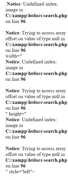

I tried it but it doesn't work. (Sweating)
For the first line I get:
For the second line I get:
:unsure: :unsure:
  • #160
It says that we cannot index the "products" with "image". Can we check \$content and see why that is? (Wondering)

I corrected it and it works now! (Nod)
As for the image, I saved the images in the htdocs directory, or do we not have to? But this still doesn't work:
Code:
<img src="<?php $product["image"]["src"] ?>"  width="<?php $product["image"]["width"] ?>" height="<?php $product["image"]["height"] ?>" style="left">
:unsure:

  • #165
Klaas van Aarsen said:
What does it do? (Wondering)
Nothing, the images are not displayed at all. (Sweating)
Btw, style="left" is invalid syntax. 🧐
Do I have to write this in the css part? 🧐
  • #166
What if you add a couple of lines in the php script and "echo" the parts that make up the image? (Wondering)
The syntax is wrong. A style attribute must be of the form style="key: value". 🧐
As it is now, it can't do anything other than generate errors.
Either way, an attribute that is suppose to align an image to the left won't do anything on the image itself.
It must typically be an attribute of the container of the image, which is in this case a <td> element.
Still, the default alignment of a <td> cell is "left" - it is already left aligned.
If we want to change it to, say, "center", we can change the <td> to <td style="text-align: center">. (Nerd)

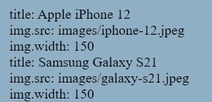

  • #168
evinda said:
What do you mean?
If <img src="<?php $product["image"]["src"] ?>" width="<?php $product["image"]["width"] ?>" height="<?php $product["image"]["height"] ?>" style="left"> does not work, we need to gather more information.
How about we add:
Code:
<?php
echo "title: ", $product["title"], "<br>";
echo "img.src: ", $product["image"]["src"], "<br>";
echo "img.width: ", $product["image"]["width"], "<br>";
to gather more information? (Wondering)

  • #170
Okay...
... so we confirmed that \$product actually refers to the correct product, since otherwise we wouldn't get its title.
... and we confirmed we can get the \$product["image"]["src"] as well as intended...
... do we have "images/iphone-12.jpeg" available in the htdocs directory? (Wondering)
