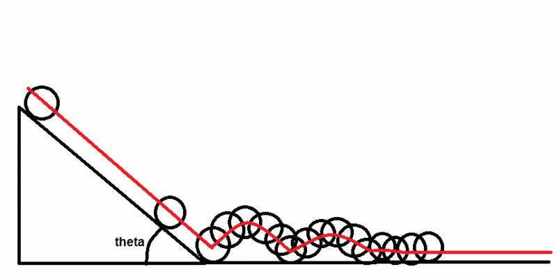

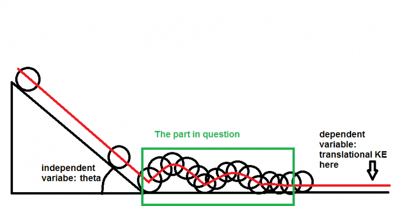

I suppose my question is a broad one. I am writing a Physics Extended Essay for the IB program (approx. 4000 words). My research question is "How does the angle of an inclined plane impact the horizontal translational kinetic energy of a solid cylinder [after it impacts and bounces across a horizontal surface, probably a wooden table, given no slipping]?", though this is not the question I need answered.
I am struggling to figure out how one might figure out theoretically how much KE the cylinder will lose due to the collisions (experimentally I can do this with a high speed camera).
Is the KE lost to the collisions solely based on that of the vertical component, or is some of the horizontal component lost as well, or even the angular? Does the number of collisions matter?
I do not have an experiment done yet, nor should I for this essay at this point, thus I have no numbers.
If someone could direct me to a source, that would be fantastic.

The slipping cannot be ignored, but it can be quantified. For any gain (or loss) in linear momentum due to friction there will be a corresponding loss (or gain) in angular momentum. The final state of motion will be that unique state of motion where angular momentum and linear momentum match up for rolling without slipping.

As I tried (and perhaps failed) to convey in post #4 above, you do not need to know the friction and you do not need to know the change in kinetic energy. You can and should know the initial values for horizontal linear momentum and angular momentum. You can compute the ratio between how much linear momentum can be gained due to friction per unit of angular momentum that is lost due to friction. If you wish, you can do that the obvious way -- figure out how much change in each quantity will result from a frictional impulse of 1 kg meter/second.
Depending on exactly how you set up your variable naming conventions, that should lead you to two [or more] simultaneous linear equations in two [or more] unknowns.
One equation will assert the relationship that you calculated above between angular momentum and linear momentum. It may be convenient to write that equation using starting linear momentum and starting angular momentum as named parameters. The other equation will assert the condition that must apply for rolling without slipping.
Solve for final linear momentum and divide by mass. Or solve for final angular momentum, divide by moment of inertia and multiply by radius.
