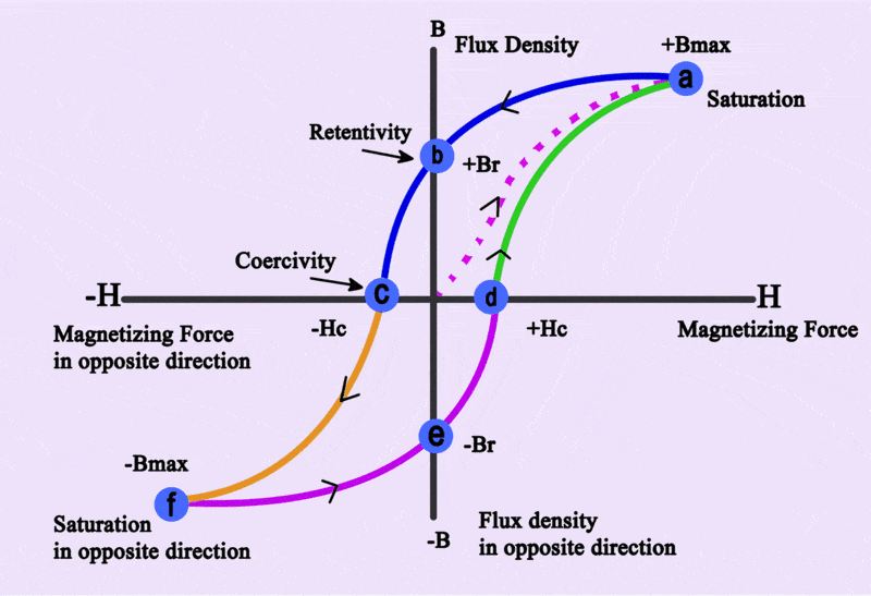

Why does the BH curve need more current to reach saturation from origin than from point d?
24 replies · 9K views
Zahid Iftikhar
121
24
Please help in the explanation of BH curve (See attached file).
At the starting point, more current is required to bring the material to its magnetic saturation point( in fig form origin to pt.a shown by purple line ) as compared to when the material is fully demagnetized and then brought to same saturation point (in fig from point d to point a, shown by green line). At the origin and point d of the graph the material is totally demagnetized with B=0, then different current is required to reach the saturation point?

Could the answer to your question just be that you have to look at the Arrows on the diagram? The green line shows the current / applied field to achieve a value of B. When the H is reduced, the B just 'hangs on' until H is lower than on the way up. That's just a description of what the graph is telling us, of course. An 'explanation of why this occurs will be that an increasing H will be doing work on altering the domains and, when H is decreased, work is done by taking Energy from the domains as B reduces.
There is a direct analogy with a spring laying on a friction surface. Energy is dissipated as the spring is stretched and when it returns to its unstressed length.
It seems to me that the origin point is different to point d.
If we were generating this curve, say with a current in a coil round the iron sample, and we reached point d, then, instead of continuing to increase the current, we reduced the current to 0. I don't think the iron would move to the origin. I'm not sure that it would return to point e, but I think it would return to a point near to e.
That seems to imply to me, that the material is in a different state at d than at the origin.

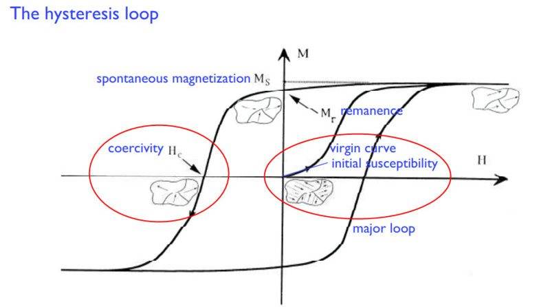

The dashed purple line in the figure represents the virgin magnetization curve. The origin point and point d differ in the sense that the material exhibts different microscopic domain structures. Have a look at the graph on page 2 of
Chapter 7 Micromagnetism, domains and hysteresis

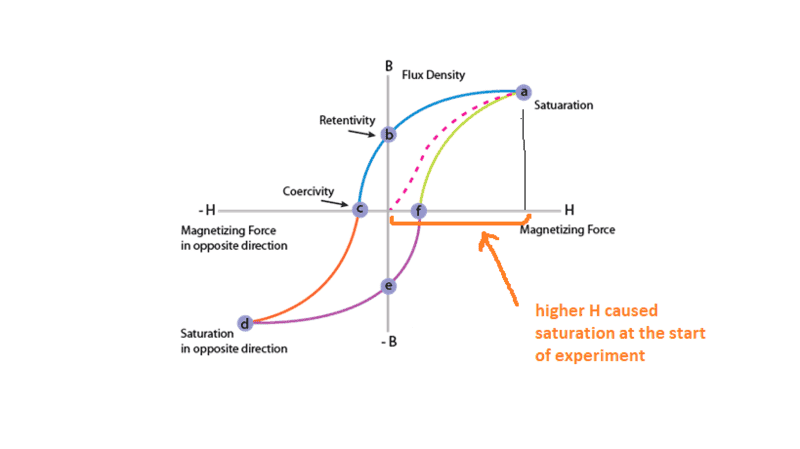

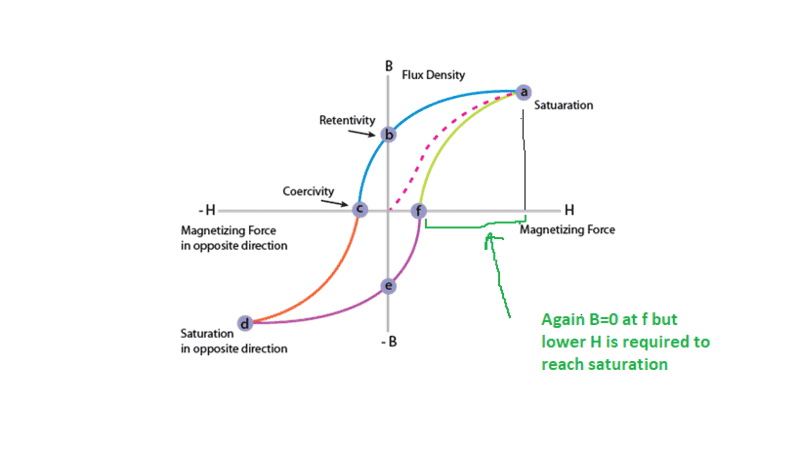

Thanks dear Sir for your time and answer. I d like to argue on this part of your answer.
"An 'explanation of why this occurs will be that an increasing H will be doing work on altering the domains and, when H is decreased, work is done by taking Energy from the domains as B reduces."
I have no problem in understanding what happens when H decreases. I have issues with a) when H increases and B reaches to saturation at the very beginning. It is shown by dotted path in the figure 1 I have just added. It talks about higher H needed to get to saturation. b) when the cycle of H completes and completes and we have to apply coercive H to bring the material to zero B (point d). You see from the graph this time less current or H makes the material saturated.

I see it this way:
Reaching the saturation point requires the same H whenever. That's what the graph says; it's not ΔH but H that's involved. There are two options on the existing graph - either the H max takes B from 0 to the saturation point or from the negative retention value. When you release the B from that value and take it to the saturation point, a different amount of Energy is needed. But H and Energy are two different things when there is Hysteresis present. Go back to my spring analogy again and see that Energy is put into the spring and actually stored until released by unlocking the friction that's sticking the spring in a partly deformed state.
sophiecentaur said:
etc.
I see it this way:

Can't agree more and that's what the attachment shows which was extracted from @Lord Jestocost's provided reference.
sophiecentaur said:
If the sample had been heated and annealed, it would also have B=0 but, once you apply an H, it will follow the dotted path and B will be non-zero, even if you put H to zero. You can stop at any value of H and return B to zero but only by applying some negative H (following a curve that lies inside the outer curves in the diagram.
Thank you for the reference. I found it really helpful.
