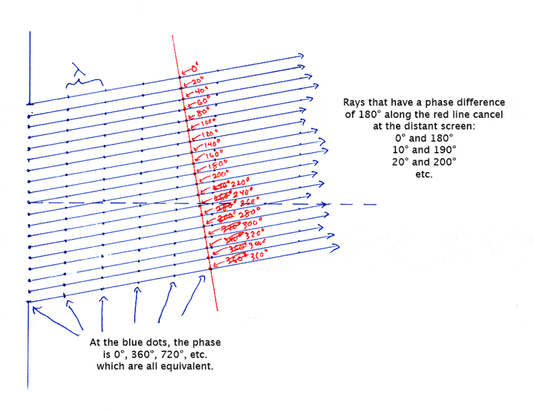

Here's the page that I would have you refer to to understand how the formula for the minima condition is derived: http://hyperphysics.phy-astr.gsu.edu/hbase/phyopt/sinslitd.html#c1
Look at the wavefront at the aperture. Rays 3 and 4 meet at the minima; their difference in path length (and thus phase) must equal [itex]\lambda/2[/itex] if they are to be out of phase and thus cancel. Note that 3 starts at the top of the aperture while 4 starts at the middle. If those rays are out of phase, then the points just below the top and just below the middle will also be out of phase.
Follow this line of reasoning and you'll see that all rays (from all points along the wavefront at the aperture) leading to that point on the screen will cancel, making the point a minima. Express this mathematically (http://hyperphysics.phy-astr.gsu.edu/hbase/phyopt/sinslit.html#c1) and you'll have the formula for the minima.
As I've said several times, the formula is for minima. The condition for maxima is much harder to specify mathematically; similar logic applies except that you want to maximize constructive interference. Of course the central maxima is trivial: [itex]\theta = 0[/itex].

Think of the rays heading for any point on the screen as being in parallel (to a close approximation). The only reason for the rays to destructively interfere is if some are out of phase with others. But all the rays going towards [itex]\theta = 0[/itex] are in phase--they travel the same distance.
(Those rays don't look like they are in parallel in the diagrams because the diagrams are not drawn to scale. The screen is much farther away than show in the diagram. Of course, if drawn to scale, the angles would be too small to see.)
At any other angle, some of the rays (near the top of the slit in the diagram) have less distance to travel than other rays (near the bottom of the slit). Since they start out in phase, by the time they meet up at the screen they are not necessarily still in phase. At certain angles (the minima) the rays cancel out almost entirely; but at other angles, they don't.

What's messing you up is thinking of the "rays" as being real chunks of light. No, they are just a mental construct to help visualize what's going on. So whether you represent a slit as having 10 or 10 million "rays" is arbitrary.
So if ray 1 and 6 000 000 are in phase, the rays 2 999 999 and 300 000 are also in phase, but out of phase with 1 and 6 000 000, so they destructively interfere? Ok, a few more things about this, instead of saying rays 3 000 000 and 2 999 999, wouldn't it be better to use rays 3 000 000 and 3 000 001? This way ray 3 000 000 and 6 000 000 would have a difference of 3 000 000, and so would rays 1 and 3 000 001, or do you have to do it the other way? Also, in this example, you mentioned the constructive interference of 2 pairs of rays, then how those rays desconstructively interfere, right? I take it if you apply the destructive interference first, then there is nothing left to constructively interfere, right? So regardless of how you approach it, the resulting effect is complete destructive interference, right? Also, is this really complete destructive interference, or just really close to it?
Sounds like you are getting the idea. You can add the interference of the various "rays" any way you like, you'll get the same answer. As far as whether you have complete destructive interference, that depends on the accuracy of your model. For example, we are ignoring the slight variation in intensity of light from the bottom of the slit compared to the top. (Since the bottom is further away from the screen, the intensity will be a little less, so the destructive interference cannot be "complete".) Within the model we are using, the interference is complete. (As opposed to the maxima where the constructive interference is far from complete--that's why the brightness of the higher order maxima decrease rapidly compared to the central maximum.)

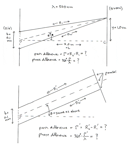

Take a look at the diagram shown on http://hyperphysics.phy-astr.gsu.edu/hbase/phyopt/sinslit.html#c1". Note the length of the line drawn from the top of the slit compared to the length of the line drawn from the bottom of the slit. The line drawn from the bottom of the slit is longer, thus the light is further away from the screen.

So then was the site's explanation wrong? It assumes that because the slit is so small, that all the rays in the gap are essentially on top of each other, and thus always interfere, but what about cases when the slit is much wider? Your explanation seems to hold true all the time, while the one I read on another site seems to hold true only if size of the opening is small, which isn't always the case, right? Is the explanation on that site a reasonable one, when the gap is small?
I don't know what site you are looking at, but I don't know what a statement such as "because the slit is so small, that all the rays in the gap are essentially on top of each other, and thus always interfere" is supposed to mean. Better to realize that light from every part of the slit is capable of reaching every part of the screen; to find the pattern, study the phase difference of light from different parts of the slit.
Also, you have to assume that the rays aren't parallel, so that they can meet, right?
Technically, sure. (Parallel rays won't intersect, right?) But the screen is so far away that the rays are as close to parallel as you want.
But you can still treat the rays to be parallel, for the sake of analyzing phase differences, and still achieve roughly the same answer, right?
Yes.
How does this relate to he fact that the screen is far away from the source?
Imagine light from different parts of the slit hitting a screen that was very close. No way to treat those rays as parallel. But as the screen gets further and further away, the rays become closer to parallel. (That's the small angle approximation.)

Byrgg said:
Doc Al said that the angles are the same because the triangles are similar, why is this true?
It's certainly true that two right triangles with the same angles must be similar, but that might not have been very helpful. Instead, think of this: Imagine a T-shaped object, with a vertical segment and a horizontal segment. If I now tilt the horizontal segment so that it is some angle above the horizontal, then the (formerly) vertical section will be an equal angle away from the vertical. Examine the diagram to see how this relates: The horizontal segment corresponds to the ray from the center of the slit.
Also what is the difference between these 2 explanations, or are they related somehow?
You need the small angle approximation to make use of those two similar triangles: without the small angle approximation, you can't treat all rays as being parallel.

That's what we've been doing all along. (Think of each segment of light at the slit creating its own "ray".)

In order for the light in the top half to cancel with the light in the bottom half, they must be exactly half a wavelength out of phase, but how is this achieved exactly?
Perhaps the attached diagram will help to clear things up. The slit is at the left, and there are a bunch of parallel rays coming out at an angle. Imagine a wave with wavelength [itex]\lambda[/itex] traveling along each ray. We assume that all the waves are "in step" with each other, and we "freeze" their motion at a point in time when they are all at the beginning of their cycle at the slit (phase = 0 degrees). Then, all the points on each of the rays that are a multiple of [itex]\lambda[/itex] away from the slit, along the ray, also have phase = 0. I've marked these as blue dots along the rays.
I've drawn a red line perpendicular to the rays. Along that line, I've labeled the phase of each wave at the point where it crosses the line. I set up the diagram so those phases turn out to be 0, 20, 40, 60, ... 360 degrees. I usually think in terms of sine waves, so the "height" of a wave is zero at phase 0, 180 and 360 degrees, is a (positive) maximum at 90 degrees, and a (negative) minimum at 270 degrees.
Each pair of waves that is 180 degrees different in phase along the red line, will cancel at the screen. The waves that have phase 0 and 180 degrees along the red line will cancel, the waves that have phase 20 and 200 degrees will cancel, etc. [You may want to calculate sin (20 degrees) and sin (200 degrees), for example, to verify this.] You can also fill in the "in-between" waves if you like: the waves that have phase 47 and 227 degrees along the red line will cancel, the waves that have phase 103.1415926 and 283.1415926 degrees will cancel, etc.
You may be wondering, why did I draw the red line at an angle (so that it's perpendicular to the rays) instead of vertically? This has to do with the approximation that we're using here.
If the rays really were exactly parallel, they'd never meet, and therefore wouldn't interfere with each other! The rays must actually converge so that they meet at a single point on the screen. Nevertheless, if that point is very far away, well beyond the right edge of the diagram, the portion of the rays that are visible in the diagram appears to be very nearly parallel. The distance from the red line to the convergence point on the screen is very nearly equal for each ray, so the phase differences at the convergence point are very nearly equal to the phase differences along the red line.
I don't know why, but your diagram isn't showing up.
I posted it just a little while ago. Attachments have to be approved by one of the moderators. Notice that above the attachment it says "pending approval".
In that diagram, there's one ray which doesn't cancel. This is why I'm confused, since Hootenanny mentioned earlier that the model assumes complete destructive interference.
