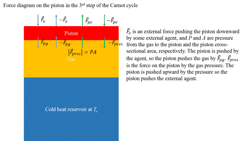

Hello.
First, look at the figure describing Carnot's cycle.
In 1st step (A → B) and 2nd step (B → C), I fully understand that the work done on the pistol (surrounding) by the gas (system) is dW = pdV where dV = Adl since F = pA is the only force on the pistol from the gas (I assumed there are no other forces). So far so good. However, in 3rd step (C → D) I have a confusion about the work on the pistol by the gas. In this step, external force Fe applies on the pistol downward direction to compress the gas, so eventually, Fe applies on the gas from the pistol. And according to Newton's 3rd law (action-reaction law), the gas also applies the force -Fe on the pistol. As a result, the gas applies not only the force associated with the gas pressure (Fp = pA), but also -Fe . So. I think the work done on the piston by the gas must be (-Fe + Fp)dl, instead of only Fpdl = pdV.
Am I wrong? If it is, could you please point out exactly what I am wrong with?
Thanks for reading this post and I'm happily waiting for your response.

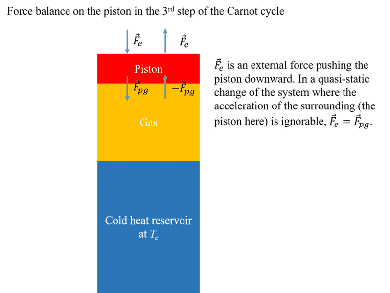

Hello.
I think you suggested me a way to break through my confusion. Yes, the piston is receiving forces from two things simultaneously; one is the external agency pushing the piston by the force Fe, and another one is the gas pushing the piston due to Newton's 3rd law Fgp (external agency pushes the piston → the piston pushes the gas → the gas pushes the piston according to the Newton's 3rd law ). If Fgp = - Fe , then a sum of these forces is zero so work done on the piston by the agency is zero (Fgp is also essentially from the agency).
Can I have a further question? At this moment, I'm not 100 % convinced that Fgp = - Fe . I'm not able to clear prove this. I think you mentioned "quasi-static" to justify this relation. Could you please tell me how "quasi-static" is related to Fgp = - Fe ? What does "quasi-static" actually mean?

I think I finally got the right answer. Thanks for all of you to guide me along a right track!
I attached the summary of what I've learned from your answers and I hope this would helpful for other guys who have similar question.

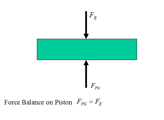

The arrow on Fpg is pointing in the wrong direction, if it represents the force that the gas exerts on the piston.
Here is the proper force balance on the piston (assumed massless and frictionless):
So, the differential work done by the gas on the piston is:
$$dW=F_{PG}dx=F_Edx$$where dx is the differential upward displacement of the piston. If dx is negative, it means that the displacement of the piston is downward, and the work done by the gas on the piston is negative (i.e., the piston does work on the gas). The change in volume is given by dV=Adx. Therefore, $$dW=F_{PG}\frac{dV}{A}=P_{PG}dV=F_E\frac{dV}{A}=P_EdV$$So, in summary,$$dW=P_{PG}dV=P_EdV$$It's as simple as that.

When you do a force balance on an object, you only include in the free body diagram the forces that other objects exert on it. You don't include the forces that it exerts on the other objects. And you only include the forces acting by direct contact.
In my diagram, the gas exerts a force ##F_{pg}## on the piston (and this is included in the force balance on the piston). Of course, the piston exerts and equal and opposite force of ##-F_{pg}## on the gas, but this is not included in the force balance on the piston; it is included in the force balance on the gas. Similarly, the external agent exerts a force of ##F_E## on the piston (and this is included in the force balance on the piston). Of course, the piston exerts and equal and opposite force of ##-F_E## on the external agent, but this is not included in the force balance on the piston; it is included in the force balance on the external agent.
When you do a free body diagram, you only include the forces acting on the body by direct contact.

I really don't want you to be bothered; But..why is -Fpg same to Fpres ? I think they're different entities. Fpres is from the collisions of gas particles on the piston bottom wall, while Fpg is from the state that the piston is pushing the gas downward. Their origins are different, so they're different ones, I think.
Can you tell me why they're same?
If, in an inertial frame of reference, a body experiences a force, then that force must be exerted on it by another thing. Your Fpres on the piston is a good example – the force on the piston is exerted by the gas molecules. But what external thing, are you supposing, exerts –Fpg ? I'm afraid that "from the state that the piston is pushing the gas downward" doesn't answer this question. If you can't pin down the external thing, then the force doesn't exist – or (as in this case) you are just re-naming a force that does exist (Fpres).
[When you say "their origins are different", your interpretation of 'origins' is not a useful one. For 'origins', read 'external bodies exerting the force' and you do now have a useful interpretation. In this case, of course, the origins are the same, because only one body exerts an upward force on the bottom of the piston, namely the gas. Note that this force would have almost the same value, for a given gas volume, if the piston weren't moving.]

Hm...I got some idea right now. The force –Fpg may not be taken into account in a calculation of the work done on the piston since the origin of this force is the piston itself; the work with –Fpg on the piston may be the work done by the piston itself via the reaction force. It is reminiscent of the situation that a person A pushes the hard wall. His upper body will be pushed back due to the reaction force from the wall, however, in this case, the wall doesn’t do work on A, no energy is drained from the wall, it is just that A works on himself via the reaction force.
So...there may be a rule that reaction forces must not be included in the calculation of the work. I hope I finally got on a right track.
If –Fpg is a force on the piston, then its origin can't be the piston itself. Please read post 16 carefully, and think about what it means.
