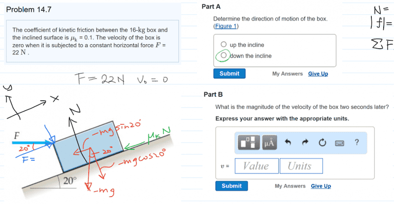

Yes, I have something to ask.
First, the y-component of F is part of the force contribute to the normal force, right?
I want to know if I need to consider the friction when the box is pushed up to the inclined plane, which gives: F cos 20 - mg sin 20 -f...
then when the box is sliding downward, there's another friction against the motion... then the sum of force in x-dir will be:
[F cos 20 - mg sin 20 -f] +f = F cos 20 - mg sin 20
Am I correct? so then, I use this divide by m to get a, and integrate to get v
Thanks a lot

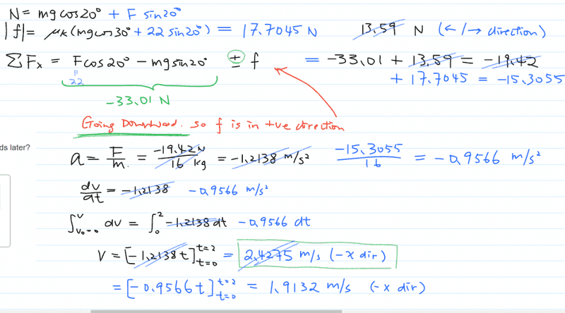

It looks like your method for finding the net force acting along the slope is okay. But you may want to recalculate the friction force; The result doesn't match what I think it should be. Perhaps a calculator slip? I see that you've made one of the angles 30° in your work, but that's probably just a typo, right?
Once you've found the acceleration you shouldn't need to integrate if you know your basic kinematic formulas.

Oh hey, I made an mistake, as you said, wrote 30° instead of 20°... and the answer for f is actually wrong.
What is the formula for the sum of force in x -direction (my x coordinate is not horizontal) ??
Cuz, I need to find v, what will be a better way if not integrating acceleration?
Thanks a lot

You've been finding the components of the various forces along the x and y directions using the trig functions. So you already have them in hand. The friction force is directed along the slope, for example.

If you have the net force acting on mass M along the direction of the slope, what's the acceleration of M in that direction? Knowing acceleration the rest is basic kinematics.
It is force applied - weight - friction? but the mass's motion is actually opposite of the direction of force applied
I mean: net force = force applied - weight - friction,

That's right, assuming you mean the components of F and g force that are directed along the slope. It's the net force that causes the mass to accelerate. Note that it's entirely possible that F will be insufficiently large to prevent the mass from sliding downslope rather that upslope! You should check the magnitudes of the upslope F component against the downslope g component prior to "adding" you friction. Friction always opposes the direction of motion.

As we push the box, up the slope, there is a friction opposing, but the force applied is not strong enough, so the box slide down. Is there a friction (in -x direction) opposing the motion?

If the box slides downslope then the friction will oppose that motion. There's only ever one friction force operating between surfaces and it always opposes the motion that is taking place (or, in the case of static friction, trying to take place).
If the motion is downslope, the friction will oppose this and be directed upslope.

So the true net force equation will then be: Fx = Fcos20 - mgsin20 +f
That looks good.

Then I can divide mass to get a..
and then integrate a = get v?
which dv/dt = F/m
∫ dv/dt *dt= ∫ F/m dt
v-v0 = a*t
which v0 = 0 (at rest)
so v(t=2) = a*2 m/s

Sure, but it's easier to apply standard kinematics equations. Remember SUVAT?
Nope, Like a= vr +vθ thingy?
OHH v=u+at
Like v = vo + at. You know the acceleration, you know the time. The initial velocity is zero. So...

I got it!
Thanks!
