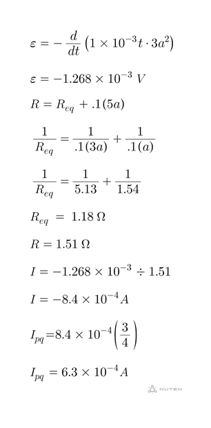

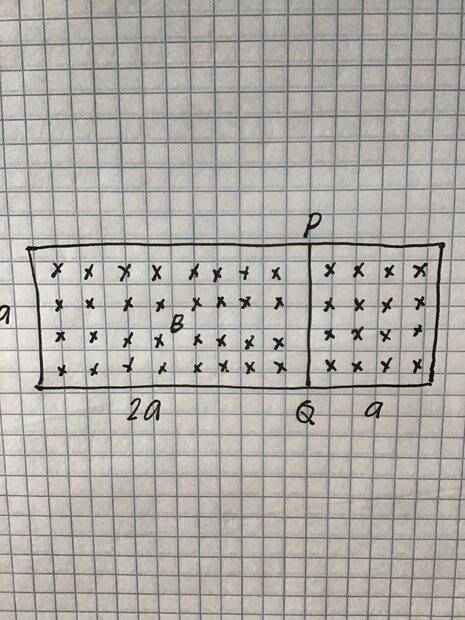

Find the current through section PQ of length a = 65 cm as shown in the attached picture. The circuit is located in a magnetic field whose magnitude varies with time according to the expression B = (1.00 x 10 ^-3 T/s)t. Assume that the resistance per length of wire is 0.100 ohms/m.
E = d/dt BA cos theta
I think there is an arithmetical mistake in the 5th line (I simply don't get ##\frac{1}{5.13}+\frac{1}{1.54}## if I put ##a=0.65m##), but there is something more important:
Why do you calculate the total R in that way and not as follows
$$R=R'_{eq}+0.1(3a)$$
$$\frac{1}{R'_{eq}}=\frac{1}{0.1(5a)}+\frac{1}{0.1a}$$
You didn't give explicitly an equivalent lumped circuit model, but I think that model you have in your mind and in which you base the calculation of total R in that way, is wrong. And the above way is also wrong I believe.

The difficulty I see in approaching the problem is that opposing emfs in PQ due to the circuits either side effectively reduce the resistance of PQ.
So I represented PQ as two resistors, one in each loop. Their resistances are so as to make the potential difference across PQ the same in each circuit, and consistent with the net current through PQ.
Necessarily, this will make one of these virtual resistances negative.
Writing V for ##\dot B.a^2##, this gave me a current from Q to P of ##I=\frac V{23\Omega}##. Correspondingly, the current through the right hand three resistors is 8I and that through the left hand three is 9I.
Edit: I may have all current directions reversed, but the magnitudes should be right.
Edit 2: I forgot the resistances are only ##0.1\Omega##, so I should have written of ##I=\frac V{2.3\Omega}##.

As you saw, I treated the model as a “lumped” circuit. The square on the right consists of 2 resistors in parallel, one of .1(.65) and one of .1(3*.65) ohms. The remainder of the circuit on the left consists of 5 resistors in series, 5*.1*.65. The current in the circuit is continuous at a particular time. I did look at the alternate of two separate magnetic fields and EMF’s with Ipq being due to the difference between the oppositely directed EMF’s. I didn’t get the right answer (although I may have made a mistake) and can’t reconcile the idea of separate currents.
But your method in post #1 is clearly incorrect since it ignores the field in the square on the right.
Do you know what the answer is? If so, does it match my resultin post #3?

Ignore resistance for the moment. We can consider the effective PD around each loop - rectangle on left, square on right - separately. This considers two copies of PQ, one in each of two unconnected circuits. We would then be able to merge the two copies of PQ, summing the two currents and two PDs along it. In each case they would partially cancel in the same way, leading to a consistent result.
When we try to reintroduce resistance, the same method would overtax the flows in PQ. It would impede currents that aren't there because they cancelled.
To resolve that, I allowed the two copies to have lower resistances. In particular, because the actual flow in PQ is opposite to what results from only considering the square, the resistance of the right hand copy would be negative.
Once you accept that model, it is a matter of writing down the usual equations and solving.
HOWEVER, I can see another way that gives a different result.
Considering each loop separately, there is a voltage 2V around the left circuit, spread over six sections length, so V/3 across PQ. On the right, V/4 on each section.
Since these oppose on PQ, the net PD along PQ is V/12.

I believe I did include the field in the square on the right because I used 3a^2 for A in the formula.
The answer is 283 x 10^-6 A. Ba^2 = 1 x 10^-3x(.65^2) = 4.225 x 10^-4= your V so your answer would be V/23 = 18x 10^-6.
Thanks for your patience, I still don’t understand why my attempt didn’t work.

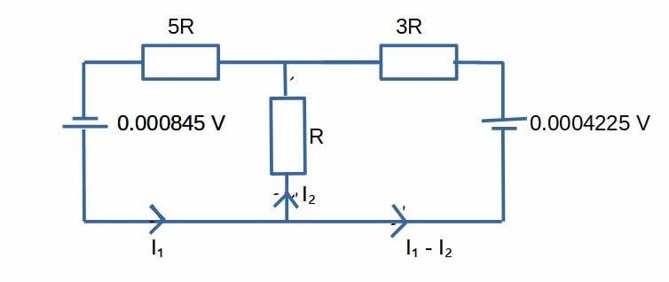

Using @Delta’s 'lumped model' approach (Post #2) we can treat the system as having 2 sources of emf – one generated by the loop left of PQ and the other generated by the loop right of PQ.
|Emf induced in left loop| = A|##\frac {dB}{dt}##| = 2*0.65² * 0.001 = 0.000845 V
|Emf induced in right loop| = A|##\frac {dB}{dt}##| = 0.65² * 0.001 = 0.0004225 V
Applying Lenz’s law + right hand rule, the emfs’ polarities are as shown below.
Let R be the resistance of a 65cm length of wire (R = 0.065 Ω). We can represent the circuit as follows:
Kirchhoff’s 2nd law, left loop: 0.000845 + 0.065I₂ + 5*0.065I₁ = 0
Kirchhoff’s 2nd law, right loop: 0.0004225 + 3*0.065(I₁ – I₂) - 0.065I₂ = 0
Doing a bit of algebra and using an online ‘solver’ for simultaneous equations gives
I₂ = -0.000283A (so I guessed the direction of I₂ wrongly).
