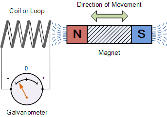

MarkoniF said:
Leads don't form anything and have nothing to do with induction loop(s) where induction takes place.
My comments about a voltmeter were with respect to your original suggestion that you measure the induced voltage in a section of a conductor. You had posted:
"The circuit would be closed by connecting voltmeter at the ends, but loop is fine too."
I simply observed that measuring the induced voltage in a section of conductor like that will not give you induced voltage between the two ends of the conductor. It measures the emf around the whole loop comprised of the conductor and the voltmeter leads. That is why I suggested you use loops.
In the above example, the magnetic field enclosed by the voltmeter leads is not significant so a voltmeter will measure the induced emf across the ends of the coil, which is a function of the rate of change of the flux through the coil loops.

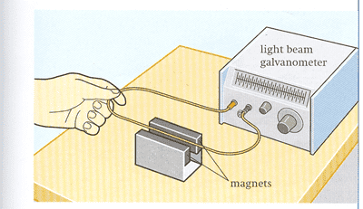

If you were replace the coil with a single straight conducting wire and pass a magnet in a direction perpendicular to the direction of the wire (replace the coil with a straight wire and have the magnet moving perpendicular to the page) as you were suggesting, a galvanometer connected as shown in your diagram would not measure the induced voltage in the conductor. That was my point.
You are mixing inductor coil with induction loop. First one is to be substitute for moving magnet, you don't induce electric current in inductor coil but supply it and induce magnetic field. We are talking about the second one, induction loop, where the current is not supplied but induced with moving permanent magnet or inductor coil, and the fact that it then creates magnetic field as well is irrelevant for the question which is only about electric current induced as compared between induction loop made of copper and iron. This is not addressed by Faraday's law, and if it is addressed anywhere at all it would be classical electrodynamics, not quantum mechanics.
Answers, not physics. Physics always makes me happy, but answers can make me sad.
You are talking about inductor coil while the question is about induction loop. Faraday's law has nothing to do with magnetic permeability of induction loop, but only with external magnetic field or inductor coil which then induces current in induction loop. Forget inductor coil and iron cores, we don't need any of that as we have moving permanent magnet.

I does not matter, just the same. Take that same image, it could be no loops up there, just a wire bent in 'U' shape, and leads of the whatever meter could be little horizontal wires at the bottom, far away from the magnet.
I didn't say wire is straight, or that it has to be. But even if it was straight, there would again be induced current and galvanometer would measure. Try it.
Faraday's law is a fundamental part of classical electromagnetic theory. To progress any further you will have to study Faraday's law and induction. Your comments show that you are not inclined to do that. You seem to want answers that fit with how you already view things, so I am afraid I cannot help you.
As I said, you were mixing two different types of induction loops. I's exactly how I told you, check it out.

Here's an example of a current being induced in a straight wire in an experiment by Faraday. The straight wire is part of a circuit but the only effectively moving part is the straight wire. The sides and bottom don't "cut" the field lines as the wire is flipped over. The magnetic field is, in this case, supplied by the earth:
This is an illustration of Faraday's law but it is also easily explained by the Lorentz force or Lorentz field (v x B) because you are moving the free charges in the top wire in a direction that is not parallel to the direction of B so v x B is non-zero. Since the charges are free to move around the circuit, the v x B E-field produces current in the wire which is detected by the galvanometer.
In the situation proposed by MarkoniF the wire is stationary and you draw a magnet past the wire. So there is no v x B electric field. Explanation requires Faraday's law. When applying Faraday's law, it becomes apparent that the length and orientation of the other wires will affect the reading on the galvanometer. So the galvanometer or voltmeter cannot be used to determine emf induced in the straight section of wire. The galvanometer reading reflects the induced emf in the entire loop.
AM
Don't you have a voltmeter, piece of wire and a magnet? Try it out and you will see. How else do you expect anyone shall convince you? I already gave you two links that confirm current can indeed be induced in a straight wire. You think people around the world just hallucinated that and came up with the same equation? Here is some more:
