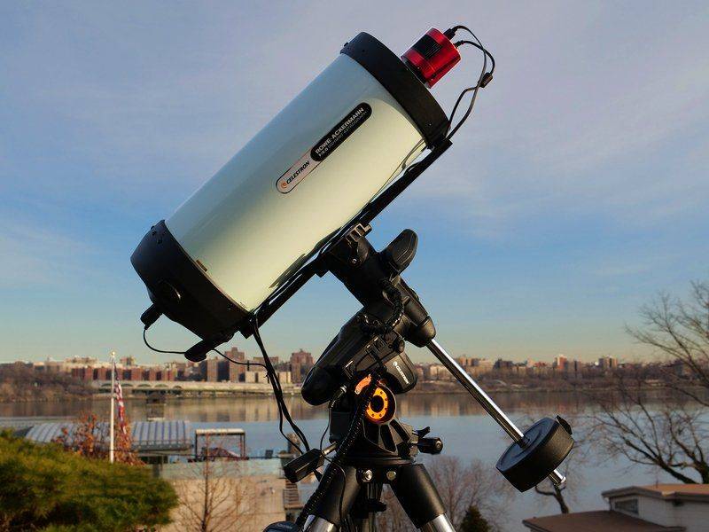

  • #61
Just as a solar panel diode uses the photovoltaic effect to create electrical current from incoming visible light, the HgCdTe diode uses the photovoltaic effect to create electrical current from incoming 3.5 micrometer infrared photons.

  • #62
Devin-M said:
How would the fact that the HgCdTe diode emits some infrared black body light of its own (at 300k) prevent it from converting some incoming infrared 3.5 micrometer photons from an external source into current through an external electrical circuit?
It's not just some infrared blackbody light that it emits. It's the same amount of blackbody light as it absorbs.
When it absorbs photons it generates emf that can be used to generate current in the external circuit. When it emits a photons it produces an emf with opposite polarity, which acts in the opposite way. Both are always happening to some degree. But when the detector is in thermal equilibrium with its surroundings, they happen at equal amounts and the effective emf, when all is said and done, is zero. No net current is produced for the external circuit.
