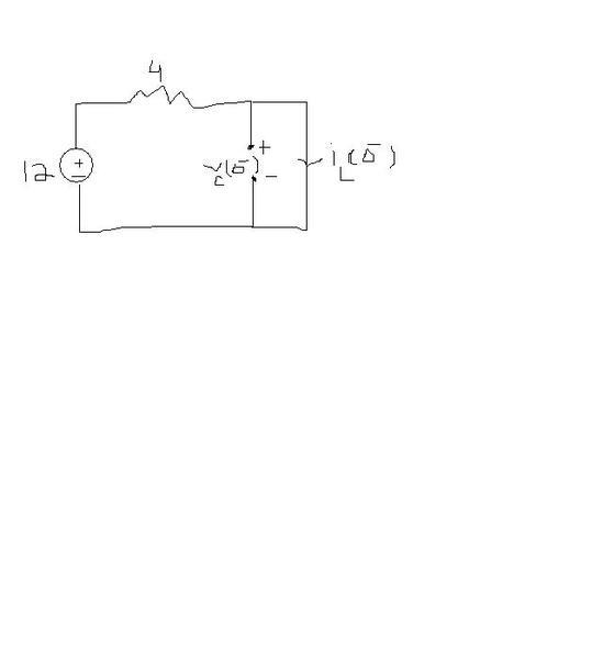

This is the circuit at t(0-); Initial conditions need to be determined:
Capacitor is replaced by an open circuit and inductor is replaced with a short circuit:
These are the initial conditions I get:
I through inductor (0-) = 3 A
V across capacitor ( 0-) = 0 ( in parallel w/ SC)
Am I missing something? This is not making any sense to me.
Sorry this is the circuit:
