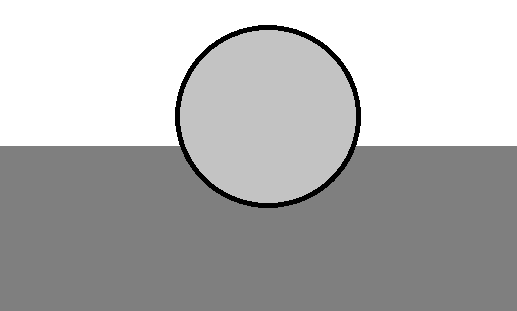

Suppose you have a long metal cylinder rolling across the surface of a smooth bowl of jello. The deformation of the cylinder is negligible compared to the deformation of the jello. In the cross section shown below that line of contact is a point. Can you do the analysis?
I am sorry not following what exactly do you want me to do? You want me to check if last point of contact on the right gives the same velocities as if we analyze it over the center of mass? How can that point be still though?
Sure. You said you wanted to figure out the dynamics part! Do you know how to use the rotational version of Newton's Second Law?
It's not still. It's instantaneously at rest, like when a ball reaches the highest point after having been thrown vertically upward.

Yes, But just one question. If it rotates about that point, wouldn't that mean that the center of mass momentarily goes up? (if that point can withstand without deforming more)
https://i.imgur.com/nPQKVVu.png
and how do you take into account that the jello is constantly deforming while the cylinder is moving?
Can you find an expression for the net torque about that point?

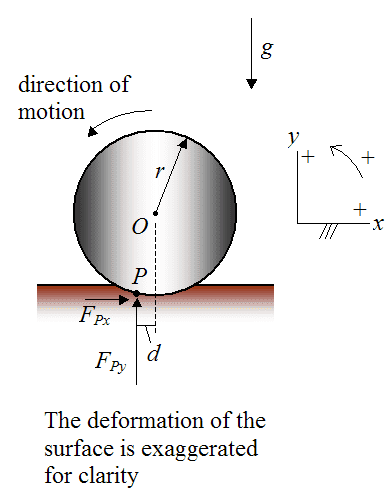

In statics we took that if you have for example a rectangular shape object The resultant of the normal force will be shifted x to one side (Because all of the normal forces are pointing up but different magnitudes) and the frictional forces all point to one side so we just sum them up.However, Here I have normal forces point up tangentially to the surface of the cylinder with different magnitude plus I have frictional forces pointing perpendicular to the tangent at a point and pointing in the other direction of the rotational motion.
In one site (ref below), They place the resultant forces on a point on the perimeter. Why is that? Why it must be on the perimeter?
Sorry again asking a lot of questions :c. Is there is a good book about this point?
