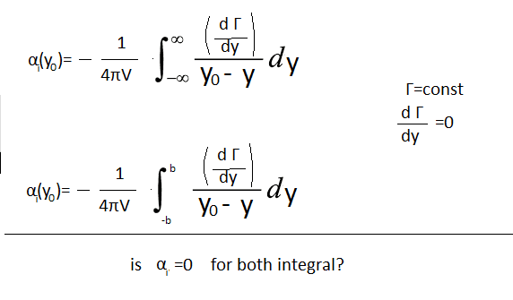

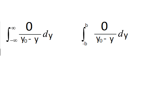

Homework Statement:: I have problem to solve this tasks.
Relevant Equations:: Calculus, infinity
Are both integral on picture below equal zero?
I think both are zero, area of zero section under function must be zero.
Where did these integrals come from? Are they from a textbook? I don't understand why someone would write an expression as ##\frac 0 {y_0 - y}##. Clearly that equals zero for all y such that ##y \ne y_0##.

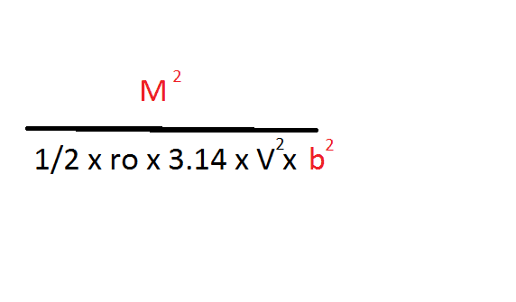

Jurgen M said:
For second case, what is result if use limes?
Here is a lime:
The word you're looking for is limit.
The expression you showed is $$\frac{M^2}{1/2 \rho \pi V^2 b^2}$$
In your image you have "ro" which I assume you mean the Greek letter lowercase rho (##\rho##). Also, 3.14 is a very crude approximation for ##\pi##.
It's impossible to say what the limit here is without knowing whether there is a relationship between M and b.
You need to be a little careful. The integrands are zero when ##y\ne y_0##, but what about when ##y=y_0##? That point is clearly in the interval of the first integral. It may or may not be in the second integral. The quotient ##0/0## is undefined, so you have to figure out how to handle that complication before you can give a definite answer.

Yes I mean on numerator.
Γ is const, so dΓ/dy=0
here is full integrals
ro is density
b is wingspan, M is lift force, when wingspan go to infinity it is logical that M(lift force) go to infinity as well..
So I put ∞ in numerator instead M..
What mean in physical sense undefined, I must know is alpha induced zero, when circulation Γ=constant, for infinity wing and finite wing?
I would start with one of your first integrals,
$$\frac 1 {4\pi V}\int_{-b}^b \frac{\frac{d\Gamma}{dy}}{y_0 - y}~dy$$
First, is ##y_0## in the interval [-b, b]? If so, the integral is undefined.
Second, you say that ##\Gamma## (uppercase Greek letter gamma), the circulation, is constant. Since the integral has the derivative of ##\Gamma## in it, that suggests that ##\Gamma## might not be constant.
It would be helpful if you showed where this integral comes from, by posting a photo of the textbook where this integral is discussed.
That makes no sense. You can't just plug in ##\infty## into an expression. In addition, if your logic is correct, you have b being infinitely large as well, so the expression you're trying to evaluate is the indeterminate form ##[\frac \infty \infty]##. I showed three examples earlier in this thread of this type of indeterminate limit, all with different values.
In the case of an infinite wingspan, it makes more sense to talk of lift per unit length along the wing, rather than the total lift which is indeed infinite.
Effectively you have reduced the spatial dimension by 1, and whatever results you have for a finite wingspan might not be applicable.
It would be helpful if you showed where this integral comes from, by posting a photo of the textbook where this integral is discussed.As already mentioned, "ro" should be "rho", the lowercase Greek letter ##\rho##. Density is often represented by ##\rho##.
Yes for wing(3D) gama is not constant, but in book write for airfoil(2D) is constant so alpha induced=0, because airfoil dont have induced drag....
It not clear why book say it is zero if integral is undefined like you say.
What indeterminate integral mean in reality, not possible?
Also what is difference in undfined and indeterminate?
I'm not up on airfoil mathematics, so I can't say anything meaningful about gamma (##\Gamma##), alpha (##\alpha##), or induce drag. I'm curious as to how the integral you showed was developed.
I didn't say the integral was indeterminate, but rather the expression you showed, where both M and b were infinite. Any time you have an expression of the form ##[\frac \infty \infty]## or ##[\frac 0 0 ]## (and a few others), these are indeterminate forms. They need to be evaluated using limits.

If y ≠yo, integral is zero, if y=yo is undefined?
That was already touched on by @vela in post #7.
By "first integral" he means the one with integration limits of ##-\infty## and ##\infty##. The other integral is the one with limits of -b and b.
Why? isnt integral undefined only when y=yo?
Yes, but if ##y_0 \in [-b, b]## there's a problem.
