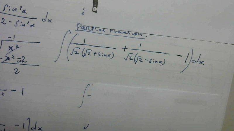

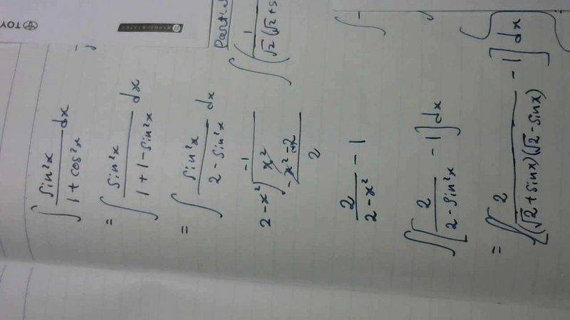

I have uploaded my attempt at the solution.
I don't usually read handwritten solutions, and I never read ones printed sideways. Regarding your integral, I would suggest suggest using the double angle cosine formulas for your squared trig functions. This will give you a rational function of ##\cos(2x)##. Then the tangent half angle substitution will help you out. See:
https://en.wikipedia.org/wiki/Tangent_half-angle_substitution
Partial fractions and trig functions usually don't go together. Partial fractions are typically used to simplify rational expressions of a single variable.
For integrating rational expressions of trig functions, a typical approach is to simplify using a trig identity of some sort first, and then try to use either u-substitution or integration by parts, if those techniques might be useful.
