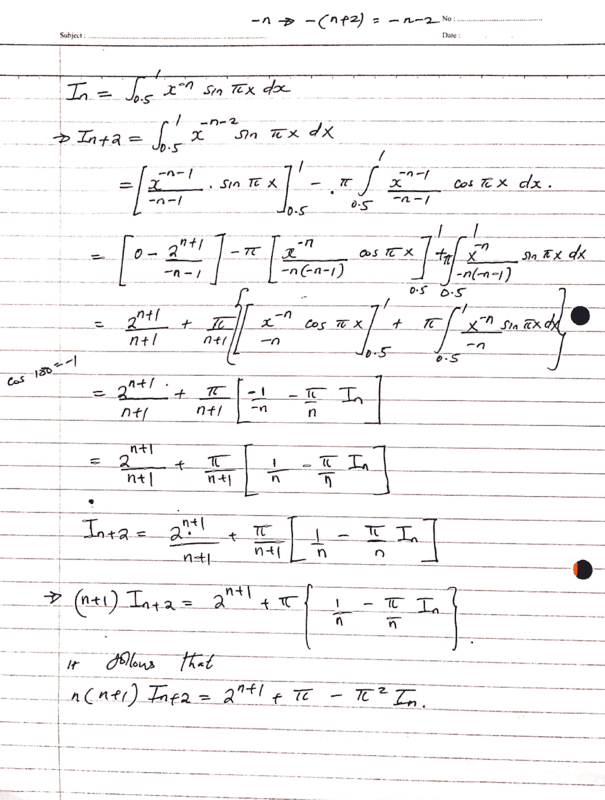

The integral ##I_{n}##, where ##n## is positive is given by ##I_{n}=\int_{0.5}^1x^{-n} sinπx\, dx##
show that,
##n(n+1)I_{n+2}=2^{n+1} + π-π^2 I_{n}##
integration by parts...
Handwritten derivation of a reduction formula for I_n = integral from 0.5 to 1 of x^(-n) sin(pi x) dx using integration by parts, ending with n(n+1)I_{n+2} = 2^(n+1) + pi - pi^2 I_n.
i would appreciate alternative method...
You can differentiate to check it, but watch out for the integration limits, as differentiation isn't exactly the opposite of integration.
hi fresh...long time...ok you may direct me...i am trying to refresh in this things...
Let's define ##f(x)=n(n+1)I_{n+2}-2^{n+1}+\pi - \pi^2 I_n##. Then show that ##f'(x)=0## which means ##x \longmapsto f(x)## is constant, say ##f(x)=C##. At last calculate ##C## from the definition of ##f(x)##, or show that only ##C=0## is possible.
I haven't done it. so I don't know how it will work. The entire question is a standard example for integration by parts. Another possibility could be using a Weierstraß substitution, but I don't think this would change a lot.
[itex]I_n[/itex] is the imaginary part of [tex] J_n = \int_{1/2}^1 x^{-n} \mathrm{e}^{\mathrm{i} \pi x}\,dx[/tex] and you can establish the result* by interating this by parts once to get a relation between [itex]J_{n+2}[/itex] and [itex]J_{n+1}[/itex], and you can then substitute for [itex]J_{n+1}[/itex] in terms of [itex]J_n[/itex] before taking imaginary parts.
*So far as I can tell, there should be an [itex]n[/itex] multiplying [itex]2^{n+1}[/itex]. chwala's work agrees with this until the last line, where it mysteriously disappears upon multiplying [itex](n+1)I_{n+2}[/itex] by [itex]n[/itex].
