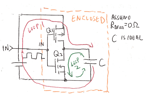

I am not a power engineer. Please explain from my drawing what is the power drawn from the battery. Assuming capacitor C is ideal and lossless, assuming the on channel resistance of the MOSFET is 0Ω so no ohmic loss.
When IN is low, Q1 turns on, voltage from the battery is connect to the C and charge it up as shown in Loop1. When IN switch to high, Q1 turn off and Q2 turn on, the C is discharged by Q2 through Loop2.
Q1, Q2 and C are inside an isolated enclosed place in the dashed box in . Battery and the IN driver is outside of the box.
1) What is the power input to the box when IN is pulsing to charge and discharge the cap continuously?
2) If there is real power input, how is heat generated inside the box as there is no resistance?
3) If there is no power input, do we expect the battery to last forever in this ideal case?
why not assume it has negative resistance?
the issue is, yung, that when that cap discharges, the energy stored in the cap ends up somewhere. where do you think it goes?
better clip on some heat sinks to the MOSFETs.
My name is Yungman or Alan
I am using an ideal case, there is no ohmic loss as a start to look at whether there is power involve in an ideal case.
For real case, you can use a MOSFET with very low output impedance to sink or source large current with very little heat. eg, if on channel resistance is 10mΩ, 1A only generate 10mV and power dissipation is very low even if charging a cap to 10V.
In computer, almost all circuits are MOSFETs, the biggest biggest problem is to charge and discharge the input and the line capacitance to achieve the logic level. Input capacitance and drive is THE single major issue of the speed limit. They get away with higher and higher speed inside the CPU only when they shrink to transistor down to lower the input capacitance. That's the reason they manage to run GHz inside the chip. But any external bus is still slow because of the trace and input capacitance need to be driven. The output has to be buffered over and over so the speed goes down. I want to see how driving a cap don't consume power.

Alan, no matter what you want to assume, when the transistors are ON, their resistance is at least as much as a wire of short length. when Q2 discharges the capacitor, if there is no other resistance in the loop, that energy will be dissipated in whatever resistance that current sees. in the wires, even those inside the capacitor, the soldered nodes, and in any other conductive element in the loop (i.e. Q2).
specifically, getting back to the original question, a computer consuming 1 kW is rather unlikely, but a computer left on that continually draws W watts will dissipate nearly the very same amount of heat and heat the room just as well as a space heater that also consumes the same W watts. only energy that somehow crosses the boundary between what is inside the room and what is outside (sound leaking out, light going out a glass window), only that energy will not heat the room.
a battery charger (drawing W watts) will heat the room less if energy is going into and stored in the battery. an electric motor (drawing W watts) with a shaft going through the wall to the outside will heat the room less than a space heater consuming the same W watts.

I know your argument, I am just confused about the current need to charge and discharge the cap. I just take everything ideal and look at one part. Assuming there is no ohmic loss, is there power deliver into the box?

If there are no resistances anywhere in that circuit. The circuit will not consume any energy.
The charge stored in the capacitor will "return" to the flow when the capacitor is discharges and then charged again. We we were talking about positive charges moving, they would first move onto the positive part of the capacitor (charging it). Then they would move around loop 2 and end up on on the bottom (discharging the capacitor).
When the capacitor is charged again, these positive charges would flow from the ground node and through the voltage source.
So the circuit would be a perfect, forever circuit (if your voltage source was ideal also).

I don't see how, the current that charge the cap is from the battery with voltage, the current discharge the cap is by Q2, nothing to do with the battery. Far as the battery concern, it only see the charging cycle time after time.
I need to be convinced that there is no power transfer from the battery into the box using an idea case. Then worry about the real resistance that cause power loss and heat.

Actually it's not so easy at all. You would have infinite currents somewhere and its generally stupid to think about it this way.
There WOULD be resistances everywhere, and because of this, the energy is dissipated in these resistances.
As Russ has stated several times, almost all energy in a circuit will be dissipated as HEAT in that same circuit. A little bit of energy will perhaps be radiated as radiowaves, but again, these will turn into heat when they hit the walls of the house.
So for all practical purposes, the energy consumed by a computer will be dissipated in that computer as heat because of resistances in that circuit.
  • #42
As soon as you add a resistance in the wires all these problems dissapear, and all power equations will be satisfied.
The power in supplied by the voltage source, will be dissipated by the resistances.
By wanting to have no resistances you present an impossible scenario with infinite current. Infinite current means the electrons move infinitely fast. They will bang into stuff when they reach the end of the wire and be dissipated as heat.
But as soon as you add just 1 Ohm of resistance in the wires everything becomes apparent = The power is dissipated in the resistances.
Setting aside the issue of infinite current, if the capacitor is ideal and there is no resistance elsewhere, there us no power either used or dissipated.
But how does that help us?
  • #44
If you write a conservation of energy statement to calculate that, it reduces to 1=0 or gives a divide by zero error, so that's why assuming no resistance doesn't clarify things:
I^2R=VI
Set R=0...
  • #45
With non-zero R value in the cap charge/discharge network, the power lost is the same regardless of value, as long as the RC time constant is short compared to the period of switching. An Rdson in the FET of 0.10 ohm, 0.010 ohm, or 0.001 ohm results in the same power dissipation.
If the Rdson is actually 0 ohm, the current is still limited, as it cannot be infinite due to the inherent inductance present. Since the energy stored in the cap is not returned to the battery it is either dissipated or radiated. In the R=0 case it is radiated. The parasitic inductance value of the FET, herein "L", forms an LC network with the capacitor. When the cap is fully charged w/ the FET off there is energy W = C*V^2/2. Then the FET turns on. The cap discharges into L, the FET inductance, which results in L storing energy. When the cap energy is depleted, V=0, but I continues through L charging C negatively. This is a resonant LC network.
Oscillation takes place & energy is radiated. The small value of L results in a high resonant frequency. If the energy is not dissipated as heat, as in the nonzero R case, then it is radiated due to LC resonance. It does not recharge the battery because there looks to be no path for that to happen.
A real world FET will have nonzero Rdson, so I don't think we should dwell on radiated power. The energy in the cap is dissipated in Rdson on a per cycle basis. Anything unclear can be explained if needed.
