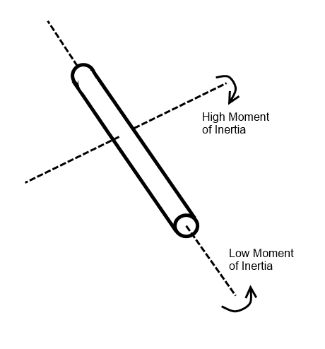

Perhaps it helps to understand that an objects moment of inertia can depend on which axis it is being rotated about. For example a long thin rod will have a low moment of inertia when rotated about an axis that goes down the centre of the rod and a high moment of inertial when rotated about an axis through the middle of the rod. This is because mass further from the axis increases the moment of inertia more than mass close to the axis (think leverage).
I suggest reading up on how the moment if inertia is calculated for objects of different shapes. Basically you have to break the object down into small parts and then sum (integrate) the moment of inertia of all the component parts, each of which might be at a different radius from the axis of rotation.
If the object is rigid then all parts are rotating at the same angular velocity so when working out the angular momentum it doesn't matter if you do...
a) Calculate the angular momentum of it's component parts and add them up
or
b) Calculate the moment of inertia of it's component parts, add them up, and then multiply by the angular velocity.
