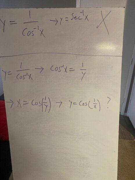

Im confused about what 1/arccos is equal too.
Im not sure what 1/arccos is. I looked online and all I have found is y=arccos(1/x) and I am not sure if that's the same thing. I tried to make a triangle to decipher the answer. However when I looked at the answer when I finished it was incorrect. I got 1/xsqrt(x^2-1) and the answer is 1/(arccos)^2 sqrt(1-x^2)

You could try putting some angles into a calculator or spreadsheet and checking whether ##arcsec \ x = \frac 1 {\arccos x}##.
Alternatively, if we let ##y = \arccos x## and ##z = arcsec \ x##, then ##\sec z = x## ... Can you finish it from there?

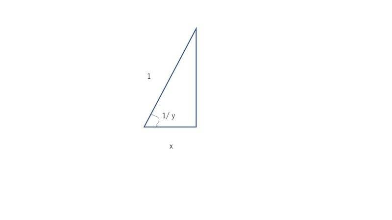

You seem to confuse reciprocal and inverse function. Say
[tex]y=\frac{1}{\arccos x}[/tex],
[tex]x=\cos(\frac{1}{y})[/tex]
Are you saying reciporal and inverse functions do not equate to one another? So 1/arccos(x)≠ arcsec(x) ?

I am not used to arcsec function in RHS. I assume it means
[tex]x=\sec y = \frac{1}{\cos y}[/tex] right ?
LHS function means
[tex]x=cos(\frac{1}{y})[/tex]
They are different functions.

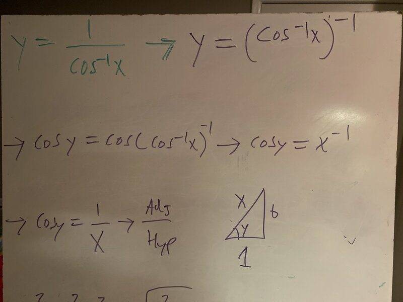

I guess what I am asking is how to find the derivative of y=1/arccos with a triangle. I am not sure how to put x=cos(1/y) on a right triangle to find the Hypotenuse, Opposite and Adjacent like I did for this problem.
An interesting idea. If you differentiate ##y = \frac 1 {\arccos x}##, you must get an ##\arccos^2 x## term in the denominator. It's not going to come out as a polynomial in ##x##.

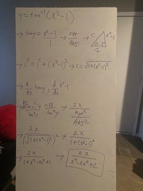

Yes, that's what I don’t understand how that came to be. The answer I get is 1/xsqrt(x^2-1). Did you do the quotient rule or did you do the power rule and bring arccos to the top then take the derivative?
That can't be right. That's the derivative of ##\arctan(\sqrt{x^2 - 1})##.

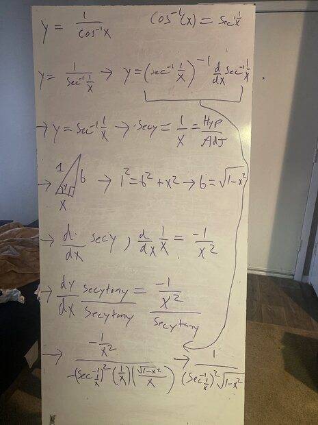

Yes, I made a mistake because supposedly 1/arccosx ≠arcsec. I will try to write out my thoughts again and show you
There's no supposedly about it. They are definitely not the same thing.

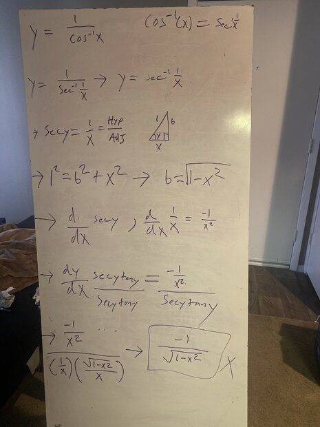

I figured it out
You have the wrong sign there. The derivative should be positive.
Yes the negative on top and the one at the bottom cancel. I just didn’t show it canceling. Thank you for the help.
