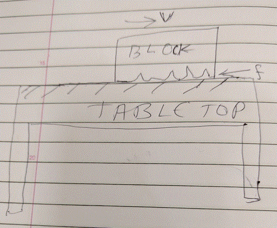

I am trying to understand the law of conservation of energy from a very general perspective but coming across some issues. I am using the equation mentioned at end of this post, which is true for a system with no heat flows into or out of the system.
In two situations described below,if the applied force and friction force are both non-conservative then using the general equation below, the change in internal energy of block should be negative of the sum of work done by applied force and friction force. This makes sense in situation 1 where internal energy increases but not in situation 2 where I am getting that internal energy of block decreases. I am sure I am making a mistake somewhere but cannot see it.
SITUATION 1 ( without applied force)
A block of mass 1 kg moving at 10 m/s on a rough horizontal surface with a coefficient of friction of 0.25 is brought to rest by friction. We will focus from initial instant when it's speed is 10 m/s to when it comes to rest.
SITUATION 2 ( with an applied force)
A force of 200 N is applied to a block of 1 kg mass on a rough horizontal surface with a coefficient of friction of 0.25. This causes the block to move in the direction of force. We will focus on first 10 m of the block's motion.
Question
Does this reasoning for situation 2 sound correct if it's assumed that no heat flows into and out of the block?

For situation 2 you didn't calculate the work done by friction correctly. (Either you didn't calculate the normal force correctly or you forgot to include the distance.)
Have you taken into account the change in KE for situation 2?

You have two non-conservative forces in your situation 2: The applied force of 200 N and the friction force. As in section 8.5 of your link, you can start with the work-energy theorem: Wnet = ΔKE. Thus,
Wapp + Wfric + Wgrav = ΔKE. You don't have any work done by gravity, but I included it for generality.
Note that the change in internal energy is due to the work done by friction: Wfric = -ΔUint. The work done by gravity can be written as Wgrav = -ΔUg. So, you get
Wapp = ΔKE + ΔUg +ΔUint
If you take the block, table, and Earth as the "system", then this says that the work done on the system by the applied force equals the change in the total energy of the system.

Let's focus on Situation 1. With all due respect to your reference, let's take a step back to freshman physics. What is your equation for the force balance on the block in Situation 1?

I was thinking more of $$ma=m\frac{dv}{dt}=-f$$where f is the magnitude of the friction force and "a" is the acceleration of the block in the +x direction. Do you agree with this? If so, what do you get if you multiply both sides of this equation by v = dx/dt, where "v" is the velocity of the block in the +x direction?
Yes, I agree with the equation. If both sides of the equation are multiplied by v then
$$mv\frac{dv}{dt}=-fv$$
So, $$mv\frac{dv}{dt}=-f\frac{dx}{dt}$$If I integrate this from 0 to time t, I get:
$$m\frac{v^2}{2}-m\frac{v_0^2}{2}=-f(x-x_0)$$where ##v_0## is the velocity at ##x_0##. What is your physical interpretation of the left- and right sides of this equation?

Right. So, from mechanics considerations, we've shown that:$$\Delta (KE)=-W$$ If we combine this with the equation:$$\Delta (KE)+\Delta (PE)+\Delta U=-W$$we obtain:$$\Delta U=0$$

So, you are saying that no change in internal energy occurs in situation 1? I thought friction will cause dissipation which will produce heat in the block i.e. increase of internal energy happens.
The dissipation occurs outside the block (at the interface). Since the block is insulated, none of this heat can enter the block to increase its internal energy. So, all the heat has to go to the table and the rest of the surroundings to increase their internal energy. If the block is not insulated, then the heat can distribute itself between the block and the surroundings (but most will go to the surroundings).

I feel a need to correct my previous post.
In my previous post, I started with an application of the “work-energy” theorem as applied to the block. But at the end of the post, I said the final equation applies to the block-table-earth system. So, I must have done some “fudging” (i.e., what I did was wrong!).
It turns out that the “work-energy” equation that I wrote for the block needs careful interpretation. Start with the general law that the net external force acting on any system equals the total mass of the system times the acceleration of the center of mass of the system. Taking the system to be the block alone, this gives Fapp – f = M aCM . Taking the applied force Fapp and the friction force f to be constant, and letting dCM be the distance that the CM of the block moves, we have
Fapp dCM – f dCM = M aCM dCM = (1/2)MVf,CM2 = Δ KECM.
The next to last inequality follows from simple kinematics. The first term on the left can be interpreted in this case as the work done by the applied force because the point of application of the force and the CM move through the same distance. (But for a deformable object, this would not necessarily be the case.) KECM represents the KE due to the translation of the CM.
The second term on the left is often called the “work done by friction”. But it is not the true work done microscopically by the forces that the table exerts on the block at the points of contact between the block and the table. This true work cannot, in general, be calculated directly. So, people who are careful with all of this will call the term (– fdCM) the “pseudo-work” done by friction to distinguish it from the true work done by friction. This pseudo-work done on the block is negative. Its magnitude does not equal ΔUint of the block. However, as will be seen below, the positive quantity fdCM does happen to equal, in this case, the total ΔUint of the block and the table!
So the equation Fapp dCM – f dCM = ΔKECM is not a true work energy equation, it is just a rewriting of the 2nd law applied to the motion of the center of mass of the block. It is sometimes called the “center of mass” equation, or the COM equation.
Introducing the notation Wapp = FappdCM and Wf, pseudo = -fdCM, we can write the COM equation as
Wapp + Wf, pseudo = ΔKECM for the block alone.
But, again, this should not be thought of as a true work-energy relation.
The true energy relation is a separate relation representing the law of conservation of energy. It states that the change in the total energy of a system equals the amount of energy transferred to the system.
If we now take the system to be the block and table, energy conservation would state that the work done by the applied 200 N force equals the change in total energy of the block-table system:
Wapp = ΔKE + ΔUint.
For the block-table system, ΔKE is just the change in KE due to the translation of the CM of the block.
Comparing the energy equation with the COM equation, you can see that the magnitude of Wf, pseudo in the COM equation for the block must equal ΔUint for the total block-table system.

This is followup to TSny's post #22 regarding Situation 2. In his post, TSny addresses the total change in internal energy of the block and surroundings. I would like to address the determination of the change in internal energy of just the block, under the constraint indicated in the OP, to wit, the heat generated by friction at the boundary cannot enter the block.
TSny derived what he called the "center of mass" equation for the block. I call this equation the "mechanical energy balance equation" for the block. The mechanical energy balance equation is obtained by multiplying the equation of motion by the velocity and then integrating with respect to time. So the mechanical energy balance equation becomes: $$\Delta (KE)=m\frac{v^2}{2}-m\frac{v_0^2}{2}=(F-f)[x(t)-x(0)]=-W$$where W is the total work done by the block (i.e., our thermodynamic system) on its surroundings. If we combine this with the equation:$$\Delta (KE)+\Delta (PE)+\Delta U=-W$$we obtain:$$\Delta U=0$$
So here again we find that, if the heat generated at the interface is prevented from entering the block, the change in internal energy of the block is zero.

Here are a couple of references:
http://www4.ncsu.edu/~basherwo/docs/Pseudowork1983.pdf
http://www4.ncsu.edu/~basherwo/docs/Friction1984.pdf
I think the catch/trick in applying First Law of Thermodynamics to situations is to include within the thermodynamic system all objects experiencing the dissipative force, rather than just one of them else one would end up calculating an inaccurate figure for work done by friction. In this case both table and block are involved with dissipative friction force, so by taking both as a system we eliminate the need to consider work done by friction. Does this sound correct to you? If we take just the block as our system and not a particle, then we will end up with friction work > actual friction work.
Also, it seems the friction work ( < f x d) is actually less than the friction work for a single particle ( f x d) due to surface imperfections along the area of contact. I drew the diagram below to illustrate this point. Due to surface imperfections along area of contact the friction force does work only when friction force acts which is when valley parts of the block's surface touch the table; so actual distance of friction force when determining work is less than distance traveled by the center of mass.
So when applying law of conservation of energy to a block ( not particle) as a system we could say the following:
Truly speaking, in situation 1 all the kinetic energy is not used by friction work, but a part of original KE is transformed to internal energy and the remaining part for doing work against friction.
Imperfections on friction surface
None of this sounds correct to me.
If the block was not an insulated body then what would be the internal energy change for the block in situation 1?
At final thermodynamic equilibrium (when the block and surroundings equilibrated), during the motion, or, at the end of the motion (but before the block and surroundings equilibrated)?
At end of motion when the block just comes to rest.
If I do a thermodynamic 1st law energy balance on the interface (as a system, which has no mass), I get:
$$f\Delta x-Q_B-Q_S=0$$where ##Q_B## is the heat that has flowed into the block and ##Q_S## that has flowed into the surroundings. The split between the two heat flows cannot be determined unless we do a more detailed analysis, which includes transient heat conduction to the block and surroundings, based on the thermal properties of these entities.
So, internal energy would not change according to the thermodynamics equation you gave. Is that true?
