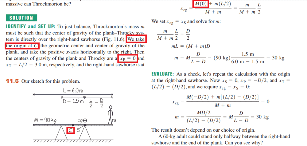

sjogosk
Summary: So we are just going to ignore the distance between C and the left support point (-D/2)? If the origin is at C, doesn't this mean M is -D/2 from the origin? In the evaluation, they clearly acknowledged that there is a distance between C and xp which is (-D/2)...
You wish to discuss a solution to a problem without stating or displaying the problem?
If the origin is at C and the center of mass of the plank (M) is at C then this means that M is 0 from the origin, surely.
Oh okay yeah I misread the question..the M is the mass of the plank not some other object. Thanks
