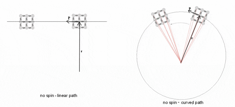

pervect said:
I think it would be useful to illustrate the difference between "rotating" and "orbiting", the two seem to be conflated in this thread.
I will do this by exhibiting a diagram of two orbiting bodies. Several "snapshots" are taken throughout the orbit to show the position and orientation of the body at different times. There is a "black mark" on the body to allow its orientation to be determined. While both bodies are orbiting, only one body is rotating, which clearly (to my mind at least) illustrates that the concept of "orbiting" is distinct and different from the concept of "rotating".
I haven't included examples of non-orbiting bodies in a state of rotation and non-rotation, but I hope such can be easily imagined without a diagram. Thus we see that orbiting and rotation are different concepts, a body can have any of the four possible combinations of rotation/non-rotation and orbiting / non-orbiting.
In the attached diagram, the body on the left is orbiting and rotating (with respect to the fixed stars). The body on the right is orbiting and not rotating (with respect to the fixed stars).
I hope this will be helpful and will prompt a more coherent explanation of what the question(s) are. At least some of the posters in this thread seem to be interested more in Newtonian ideas ('instantaneous action at a distance") than GR ideas ("following a geodesic").
The diagram itself is basically Newtonian as it uses the Newtonian idea of "rotation relataive to the fixed stars".
I wouldn't mind talking some about the difference between the Newtonian and GR views, but I'm not actually sensing any interest in the GR point of view ("follwing a geodesic") at this point in time. Or perhaps the interest is there, and there's a language barrier.

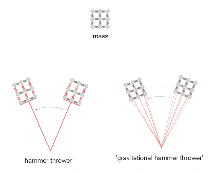

Let me reply with my own diagram
consider a hammer thrower who is rotating around his own axis, keeping a mass attached to a string in a circular orbit around him. In this case, the force that keeps the mass in orbit acts directly only on the part of the mass where the string is attached. The rest of the mass is just passive mass, and thus an internal stress force (i.e. an electrostatic force) must be set up in it to keep it together (this internal stress force is what we feel as 'weight' when we accelerate e.g. in a car).
Now, in contrast to this consider a 'gravitational hammer thrower', who keeps the mass in orbit by means of the gravitational force rather than a mechanical connection. In this case, the force acts directly on all atoms of the mass, so no internal stress force is set up. Ignoring tidal effects, all parts of the mass should orbit the center of force on their own account, maintaining the same orientation with regard to the local radius vector. The point is that this rotation is also inertial like the linear orbital motion, so it would not be detected by an accelerometer. It is simply a consequence of the spherical gravitational potential (in contrast, in the case of the non-rotating orbiting planet in your own diagram, the accelerometer would actually measure a rotation, as that rotation is not an inertial rotation).
So it is obvious that a purely local measurement can not only provide no answer to the question whether one is actually accelerating or not, but neither to the question whether one is actually rotating or not. The interpretation of any accelerometer measurement can only be unambiguous if the global situation is taken into account.
Which means the mass will *not* move the way you say it will, since tidal effects are what would make it "rotate" as you have drawn it. See below.
No, it isn't. Here's how you know it isn't: the way you drew the mass moving in the gravitational case is *not* the way the mass would actually move, if it were moving completely inertially (i.e., zero accelerometer reading everywhere). It would only move the way you drew it if it were tidally locked to the planet it was orbiting, as the Moon is, to a fairly good approximation, to the Earth. But orbiting satellites are *not* tidally locked; their spatial orientation is not in any way tied to the direction the Earth is in, because tidal effects are simply way too weak, over the size scale of a typical satellite.
In other words, a satellite, like, say, the International Space Station, that was really moving completely inertially around the Earth would look like the diagram on the right in pervect's post, *not* the diagram on the left. A satellite that was moving like the diagram on the left would be experiencing tidal effects and so would *not* be moving completely inertially.
No, you have it backwards. See above. The only feature of the motion that is a consequence of the "spherical gravitational potential" is the orbital motion of the center of mass of the satellite.
Look carefully at your picture of the gravitational hammer thrower - it's not correctly describing the rotational behavior of an object in gravitational orbit. The way you've drawn it, the side that is facing the top of the picture now will be facing the bottom of the picture when the object has gone 180 degrees around the orbit as the object keeps the same side facing inwards. That's an object rotating on its own axis once per orbit, and that rotation will be detectable with a local accelerometer.
If the orbiting object is not rotating about its axis, then it will be inertial and the accelerometer will just tell you that it is in free fall, not accelerating... and the accelerometer will be correct. An object in orbit is not accelerating even though it is following a curved path in three-dimensional space.
You seem to forget that we are not dealing with a homogeneous gravitational field here. Its direction changes through 360 deg over one orbit. So a detector co-rotating with this should be in an inertial frame and not detect anything.

Ignoring tidal effects means ignoring the gravitational force change dF from front to back of the mass compared to the force F itself.
Agreed; but that's not the only thing determining how the object's individual parts move. See below.
Fantasist said:
It is not a tidal lock, on the contrary: if you ignore tidal effects (in the sense as defined above), then you can as well assume that all parts of the mass orbit independently of each other.
No, you can't, because the object's parts are held together by non-gravitational forces: in your model, the springs. Forcing the object to rotate as you drew it will cause the springs to stretch, because the outside pieces of the object are moving faster than the inside pieces. It doesn't matter how small you make the object: it's geometrically impossible for the object to rotate as you drew it without inducing forces in the springs.
In reality, as I noted previously, gravity will determine the motion of the object's center of mass; the motion of the other parts of the object will be determined by the springs. If the springs stay in equilibrium, which is what I understood you to be stipulating, then, as I noted, the object's motion will look like the right side of pervect's diagram.

Seriously, this is such a trivial issue that you're trying to augment into something non-trivial. Nugatory gave the resolution already and it complements pervect's original drawing.
If we have an observer in free fall in some space-time geometry, an accelerometer carried by the observer will obviously measure zero acceleration: ##\xi^{\gamma}\nabla_{\gamma} \xi^{\mu} = 0## where ##\xi^{\mu}## is the observer's 4-velocity. An isotropic mass-spring system carried by the observer (of ideal size) would not be displaced from natural equilibrium during the free fall trajectory.
The observer can also carry with him an apparatus consisting of a sphere with beaded prongs attached isotropically. Clearly if the observer had non-zero spin then the beads would be thrown outwards due to centrifugal forces; if the observer had vanishing spin then the beads would remain in place. For observers in free fall this is equivalent to ##\xi^{\gamma}\nabla_{\gamma} \eta_{i}^{\mu} = 0## where ##\eta_{i}^{\mu}## are the spatial axes of the observer's frame.
These are all obviously local measurements-no global measurements are necessary.
Finally and most importantly, there are both mathematical and operational ways of differentiating spinning from orbital rotation. See pp. 221-224 of the notes I linked to yuiop earlier in this thread: http://www.socsci.uci.edu/~dmalamen/bio/GR.pdf
In a nutshell, an observer can always Fermi transport the spatial axes of his frame along his worldline. This immediately gives us the second of pervect's drawings i.e. the one in which the black marker on the particle "always faces the same direction"; we have thus determined a non-spinning frame for our observer before even talking about orbital rotation. If we now consider an observer who is possibly in a circular orbit in a stationary axisymmetric space-time, such that for simplicity the circular orbit has as its tangent field the axial killing field ##\psi^{\mu}## (not to be confused with the 4-veocity of the observer), then the observer can test to see if he is actually in a circular orbit simply by seeing if ##\psi^{\mu}## rotates relative to the spatial axes of his non-spinning frame i.e. he just has to see if ##\psi^{\mu}## changes angle continuously relative to said spatial axes along the worldline of the observer. If it does then the observer is in the circular orbit described above and if it doesn't then the observer is not in such a circular orbit. This is proven mathematically in the notes I linked above.
  • #42

My suggestion with respect to tidal effects - keep them in the analysis, but use a simple, circular shape, then demonstrate there is no net tidal torque due to tidal forces.
I hope it's already obvious that there is no net force due to tidal forces - that by definition the center of mass moves in such a manner that the tidal forces sum to zero.
I wasn't originally going to do this here, but the argument for zero tidal torque is simple enough that I'll give it a shot. Using the approach suggested by Goldstein in his textbook "Classical mechanics", IIRC called potential theory, one adds up the total potential -GmM/r of the shape to the central mass (which we will assume is a point). Goldstein is an advanced undergraduate/beginning graduate level text IIRC, but the argument is simple enough to present here.
If the summed potential changes when the orientation of the shape changes, there are tidal torques. It's apparent from the circular symmetry that this potential will not change for a disk when it rotates. Therefore there can be no net torque on a disk due to tidal forces.
If one insists on using a "hammer" shape, one will find that there are tidal torques. But there is no compelling reason to use such a complex shape. It obscures the arguments rather than illuminates them.
Using the simper circular shape, because there is no net tidal torque, the angular velocity of a rotating disk will not change. The rotation of a circular disk around its axis of symmetry is completely independent of its orbital motion.
One sees numerous examples of this in astronomy, planets all rotate at different and mostly constant rates. There are some small effects that make the rate of rotation non-constant in the real world, these are due to the lack of perfect spherical symmetry.
In astronomy, the rate of rotation of a celestial body relative to the fixed stars is called the "sidereal day". This is the absolute rate of rotation. The sidereal day can have any value.
Lets consider now a planet orbiting the sun. When the sidereal day is equal to the solar day, the planet will have one side always facing the sun, as per one of my earlier diagrams. The other example on my diagram had no rotation relative to the fixed stars. Not shown on the diagram are the infinite number of other possibilites corresponding to other rotational rates.

Since astronaut B is in an orbit with 2 meters higher altitude, his orbital velocity is slightly slower; so the effect of tidal gravity will be to make B slowly fall *behind* A. In other words, when A has completed exactly one orbit, B will have completed slightly *less* than one orbit. So a line drawn between them will no longer be exactly radial (and its length will be a bit longer than 2 meters)--but the *direction* in which it is turned is *opposite* to the direction in which you drew the masses turning in your "gravitational hammer thrower" drawing.
Yes, an object in the outer orbit will fall behind, and an object in a lower orbit will advance in its orbit relatively to the center of mass. That's why you have to accelerate the former and decelerate the latter to preserve the spatial configuration, i.e. you have to rotate the whole system forward (as indicated in my diagram).
Of course, for a rigid body, its constituents would be kept together anyway due to the electrostatic force, but the tendency for the parts to drift apart would create a stress force in the body. You can eliminate this stress force by rotating the body forward synchronously in its orbit. So the bound rotation of an object should correspond to an inertial state (or something close to it anyway, as I don't think the stress force can be completely neutralized through simple rotations or translations other than in first order of r/R, as the orbital velocity is ~1/sqrt(R+r)).
PeterDonis said:
All this was taking tidal effects into account: but the only way tidal effects appeared in the analysis was in the small force that the spring had to exert to keep A and B's separation constant at 2 meters. Ignoring tidal effects therefore simply means ignoring that small force. It does *not* mean changing the motion of A and B; otherwise ignoring tidal effects would not be a good approximation.
I realized now that it was wrong to assume the absence of tidal effects here, as the whole issue in fact is about tidal effects.
Even for perfectly spherical bodies, the inclusion of tidal effects (i.e. the variation of the gravitational force inside the body) is actually already implied by the 'Shell Theorem' (i.e. Gauss's law), so it would be a contradiction in terms to neglect them.
  • #58
*If* they are both moving freely. But if they're connected by springs, they're not moving freely.
Yes, that's what the spring does--but that just maintains the system's orientation in the *original* radial direction. If the spring were not there, a line connecting A and B would rotate *backwards* relative to the original radial direction. So this...
...is not correct. The spring just counteracts the *backward* rotation that would be present if A and B were moving freely. It does not add any forward rotation.
Which the parts of the body would move, if possible, to eliminate, just as A and B move to eliminate the stress in the spring. The equilibrium configuration of the body is still unstressed; you can't keep it stressed in equilibrium if the body as a whole is in free fall (in the absence of tidal effects--see below).
No, you eliminate the stress force by *not* rotating the body at all, instead of letting it rotate backwards due to tidal effects. See above.
Yes, in the absence of tidal effects. See below.
In the absence of tidal effects, there is zero stress force if the body as a whole is in free fall. If tidal effects are included, then yes, there will be small internal stresses present due to tidal effects. However, those by themselves won't cause the object to rotate; you need dissipation as well. See further comments below.
No, there are two separate issues, as the discussion between yuiop, Nugatory, and myself in this thread shows. Tidal effects will *eventually* cause the orbiting body to rotate once per revolution, as per your "hammer thrower" drawing; but this happens on a much longer timescale than a single orbit. And the mechanism of tidal locking involves dissipation, so it requires damping in the springs in your simplified model; idealized perfectly elastic springs would *not* cause tidal locking, and so would *not* cause any forward rotation.
Huh? The "Shell Theorem" talks about variation due to the object's own self-gravity; it has nothing to do with variation of the gravity seen by a small object orbiting a much larger one.
