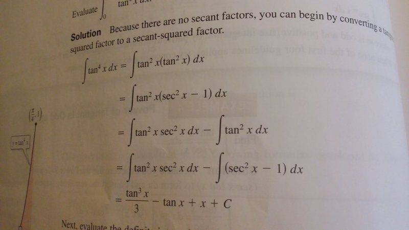

Doesn't the integral of sec x tan x equal sec x?

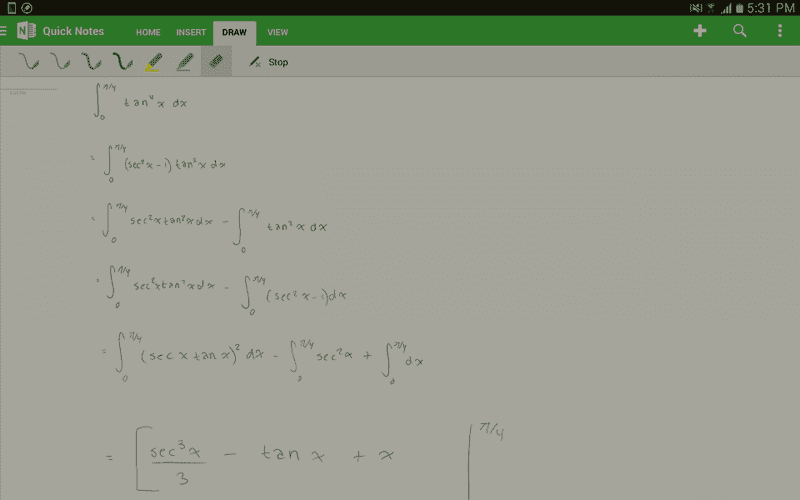

Your textbook is correct. The attachment of your work is too small and blurry for me to read, so I will not even try. I will look at it if you type it out.

Well, it is correct, but the textbook uses the fact that [itex]\frac{d\tan x}{dx} = \sec^2 x[/itex]. If you use [itex]\frac{d(\sec x \tan x)}{dx} = \sec x[/itex], then the first part of integration will be
[tex]\int \sec^2 x \tan^2 x dx = \int \sec x \tan^2 x d(\sec x \tan x),[/tex]
which is not that easy to calculate. However, when you use [itex]\frac{d\tan x}{dx} = \sec^2 x[/itex], then
[tex]\int \sec^2 x \tan^2 x dx = \int \tan^2 x d(\tan x) = \dfrac{1}{3} \tan^3 x + C_1.[/tex]

Thank you! I just went over it again and realized I forgot about the chain rule.
Mark44 said:
Yes, but I don't see how this fact applies to your question.
I just realized as much myself:-p I forgot about the chain rule, so I intgrated (sec x tan x)2 to be (sec3 x)/3.
