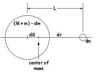

I think you're getting warm, but I think that the upper limit should reflect the amount of water moved, not the total mass of the tank+water.
When a small bit of mass dm is moved to a position L away from the center of mass of the tank, the remaining tank+water must move so that the overall center of mass occupies the same place as before (the center of mass of the system must remain fixed). So in the diagram above, the tank has moved distance dR from the old center of mass, while the bit of water dm has moved a distance dr from the center of mass. Then, if M is the tank's mass, m is water's mass, then
##(M + m - dm)\;dR = dr\;dm ~~~~~~~~~ dR + dr = L##
Solve for dR in terms of dm, then integrate to sum up all the dR's to find the total shift.

ok so dR =(dr*dm)/(M+m-dm)
But then how would I integrate that??
doesnt it have to many terms in it?

You didn't take advantage of the fact that L = dr + dR in order to eliminate dr. Take the initial expression and replace dr right away.

Ok so I have dR= ((L-dR)dm)/(M+m-dm)
So integrating
R=∫((L-dR)dm)/(M+m-dm)
But how do I integrate that?
I still have to many terms?

You haven't isolated dR. It still appears on both sides of the expression.

I am aware but from the eqn's
dR +dr = L & (M+m-dm)dR=dr(dm)
You can't isolate dR without introducing dr...
am I missing something?

It's just algebra. Replace dr using dr = L - dR. Move everything to the L.H.S. Expand and collect all the dR terms together. Rearrange with dR alone on the L.H.S.
  • #36
Rethinking it a bit, a simpler approach would be to let M be the total original mass of the tank plus water. You want to move a quantity m of that total mass (representing the water) through the pipe. Then
##(M - dm)dR = dm\;dr ~~~~## and as before, ##~~dr = L - dR##
##dR = L \frac{dm}{M}##
Integration is trivial, with limits 0 → m
##R = \frac{m}{M}L ##
Ok so now the eqn for the distance traveled x = R=∫m/M *L with limits 0 &m
and final velocity =0.
Thanks!

I've decided to add some confusion back into the mix. Upon rethinking the rethinking, I've decided that the previous form of the integration makes more sense :frown:
At some time partway through the emptying of the tank, let's say that an amount x of the water has already gone down the pipe. That leaves the tank plus remaining water with mass M-x. It's this remaining mass for which we need to find the dR associated with the next dx that's moved.
##((M - x) - dx) dR = dx\;dr##
##((M - x) - dx) dR - dx (L - dR) = 0~~~~~## because ##dr = L - dR##
##dR = L \frac{dx}{M - x} ##
Integrate that for x going from 0 to m, the mass of water drained. M is still the mass of the tank plus the initial amount of water.
EDIT: Changed variable dm to dx in order to have it reflect that it's affecting x, the water that's being shifted.

ok so I have R = ∫L(dx/M-x) = ∫L (M-x)^-1 dx.
But then I have R= -L
Or could it be,,
R = -L(ln(M-x) + c
  • #42
Or could it be,,
R = -L(ln(M-x) + c
You need to plug in both limits (0 and m, the total mass of water drained).
  • #43
ok...
so x = R = (-L(ln(M-m)) - (-L(ln(M-0))
  • #44
sg001 said:
ok...
Pull out the L and combine the ln's.
  • #45
Finally...
x = R= -L(ln(M-m)-(M-0))
  • #46
sg001 said:
Finally...
You need to check your log manipulation math. ln(x) - ln(y) ≠ ln(x - y).
  • #47
Ohh yeah My bad simple yet stupid mistake.
x= R = -L(ln(M-m)-ln(M-0))
  • #48
Still review your log math operations; Those logs can be combined into a single log.
  • #49
woops
R = -L(ln((M-m)/(M-0)) = x
  • #50
sg001 said:
woops
It can still be cleaned up some. Drop the zero and use the fact that -ln(b/a) = +ln(a/b).
