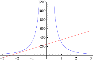

So I have pretty much finished the question, trying to determine "B" this is where i am at.
294/B^2 = 102.61B + 250.47
I found a very similar question in a book and they just skipped straight to answer saying trial and error was used.
Using trial and error I got approximately 0.92, however I'm not sure if this is a sufficient method to get full marks.
Any other way this can be solved that isn't trial and error?
Regards Callum.
If you plot the lhs and rhs on a common graph, you will find it has only one (real) solution.
Then, you can use a numerical method to find an approximate numerical solution, which seems fine because the coefficients are also given with finite precision. Specifically, you could use the iterative method. Solve for the [itex]B[/itex] on the lhs:

Take an initial guess [itex]B = 1[/itex] (the rhs is positive then) and use the iterative procedure to get successive approximations:
[tex]
B^{(n + 1)} = \varphi(B^{(n)})
[/tex]
We get:
[tex]
\begin{align*}
B^{(1)} = 0.912508894 \\
B^{(2)} = 0.924335701 \\
B^{(3)} = 0.92271007 \\
B^{(4)} = 0.922933009 \\
B^{(5)} = 0.922902426 \\
B^{(6)} = 0.922906621 \\
B^{(7)} = 0.922906046 \\
B^{(8)} = 0.922906125 \\
B^{(9)} = 0.922906114 \\
B^{(10)} = 0.922906115 \\
B^{(11)} = 0.922906115 \\
\end{align*}
[/tex]
In just 10 iterations we arrived at the numerical solution with 9 decimal places! You can use this solution to see that the original equation is satisfied.
