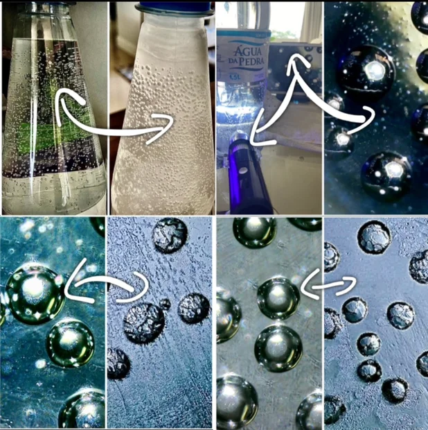

The water can dissolve a quantity of gas based upon its temperature and the external pressure. If the pressure in the liquid is decreased, some gas will come out of solution as bubbles.
Water turning into Ice is purified by expulsion of dissolved gases. This happens at the boundary of ice crystal formation where tiny bubbles form. Rapid ice crystal growth surpasses the tiny bubbles entrapping them and the ice will look cloudy.
The structure seen is the ice crystal formation and structure outside the bubble. Whether one can call that internal bubble structure is debatable, but what is seen is the surface of the bubble/ice interface rather than anything else.
Is it possible to break a gas -- I am not sure what you mean,

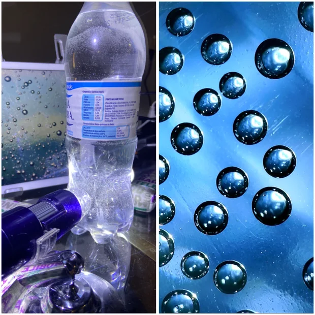

Yes — the mechanism is different, and that is precisely what makes it interesting, not what explains it away. Still water, no added CO₂, cap opened only to equalize pressure — and yet spherical gas bubbles form slowly over 30 minutes, survive ice formation, and show altered internal structure. If the mechanism is different from standard degassing, then what is it? That is the question.

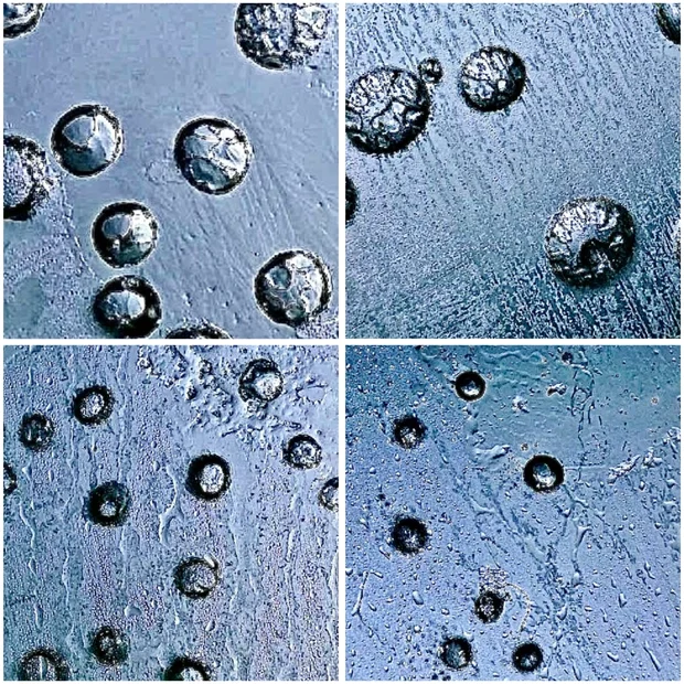

Mineral water with bubbles adhered to the plastic.
You say the structure seen is the ice/bubble interface — not the inside of the bubble. But the microscopy was done using only refracted light, which reveals internal structure, not surface. And the structure changed after freezing. If it were just the outer interface, why would freezing fracture it? Something inside the bubble was altered.
Mineral water showing fractured structures in the bubbles.
Hence the question: "is it possible to break a gas"?
Because or it is possible (which doesn't make sense), or that's not gas.
If it is gas, then, there must be an explanation to why previously dissolved gas molecules arranged themselves into spherical bubbles attached to the plastic, which would be a direct contradiction to the second law of thermodynamics, and there must be an explanation to why these gas bubbles inside water resist to the volume expansion of ice formation, and, at last but not least, there must be an explanation to why gas can have shape and can break.
Or, if it's not gas — what is it?

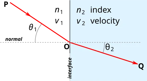

swissgirl1999 Refer said:
refracted light
Isn't that where light bends when passing from one medium to the next?
Quite the contrary — this is still water (no added CO₂). The bubbles are not dissolved gas escaping; they are forming where there should be none, surviving ice formation, and showing fractured internal structure under microscopy. That is what needs explaining.
While the images of carbonated mineral water are highly informative, note that even 'still water' can have a lot of dissolved gas (air) present- cloudy ice cubes are proof of that. You can de-gas tap water by first boiling it and then, after it cooled, carefully pouring it into your container of choice and then leaving that container open in a well-ventilated area for 24 hours or so.
Also, the bubbles in ice do not have a 'fractured internal structure'- what you see is the ice-vapor interface.
...which has deformed due to compression of the vapour as the ice expands.

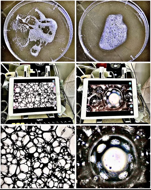

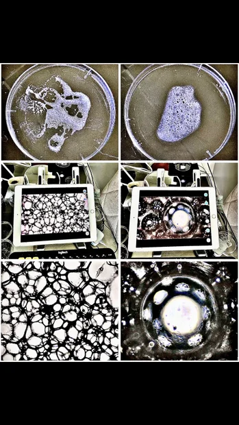

Yes, I'm an independent researcher with access to a functional kitchen, a bunch of thermometers, and several different types of microscopes.
My “laboratory” is as sophisticated as it can be.
I also do not expect the community to do the work for me.
However, when the observations from an outsider contradict the textbook, even with precise quantitative data, it is not taken seriously by the academic community, because "challenges to mainstream results are especially difficult, precisely because they already went through that careful effort."
Nevertheless, that effort took place inside institutions, with peer review, with labs, with grants and prestige.
I do not have any of those.
That’s why my focus is to present qualitative observations that are robust, cheap, and visible enough, so that it could raise curiosity.
The gas bubbles that form in still water and survive freezing.
The structures that fracture under microscopy.
Or, like this comparison between these two apparently distinct types of vesicles (i.e., bubbles):
One type seems empty, as one would expect from empty voids filled by air; the other presents 5 recurrent patterns.
I couldn’t find official literature about the second one, which is much more frequent, at any magnification from the most type of fluids.
Here, again, however, I refrain myself from presenting any conclusion, because my goal is for others to go look for themselves.
At the end of the day, I’m an independent researcher without theories, but with observations.

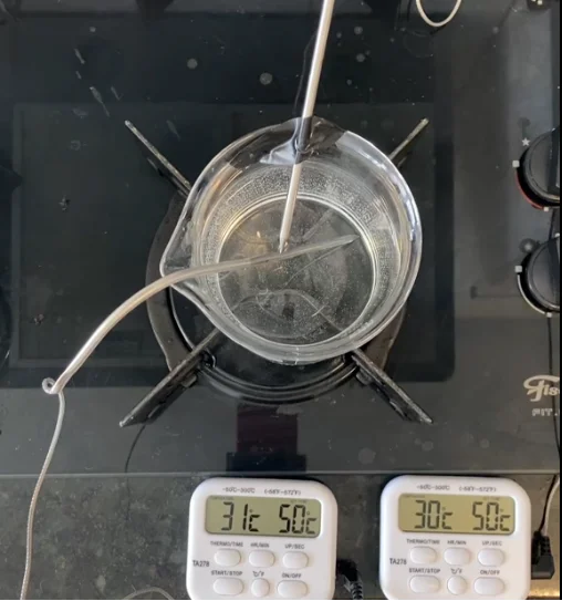

“so many complexities” — ok, take this experiment, for instance:
a beaker with 500mL of water at 31 Celsius, two probes, as in the picture, one at the bottom and the other inside the water near the surface;
add 5 ice cubes (approximately 50mL of frozen water);
the ice cubes will, obviously, float until fully melted;
first question:
until all the ice cubes melt, which portion of the water volume will be cooler — the surface (where the ice cubes float) or the very bottom, why?
second question: do you have two thermometers at hand to replicate such a complex experiment?
Water + frozen water inside a recipient — thermodynamically speaking, I can’t propose a simpler experiment…
