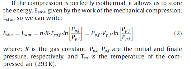

For an Isothermal compression process of air in a vessel with constant volume, I found the following expressions
Typed text giving the stored energy W as work to compress air in a vessel of volume VB from pressure PA to PB, with the formula W = PB VB ln(PA/PB) + (PB - PA) VB and assumed values PA = 0.10325 MPa, PB = 2 MPa, VB = 60 m3, giving W = -95.4 MJ = -26.5 kWh.
and
Text slide giving the exergy of stored compressed air: B_HP-air = (p0 x V_store) x (r log r - (r - 1)), with definitions of r as pressure ratio, p0 as ambient pressure, and V_store as stored high-pressure air volume.
and
Text with an equation: Estor = Lstor = n·R·Tca,f·ln(Pp,f/Pp,i) = Pp,f·Vp,f·ln(Pp,f/Pp,i), equation (2), with definitions of R, Pp,i, Pp,f and Tca = 293 K.
The first two give the same result, meanwhile the third gives another solution and I don't know why.
For adiabatic compression I found these two expression which also give different answers. Can someone please help me with this.

  • Printed equation (2) for isothermal compression energy: E_stor = L_stor = n·R·T_ca,f·ln(P_p,f/P_p,i) = P_p,f·V_p,f·ln(P_p,f/P_p,i), with definitions of R, P_p,i, P_p,f and T_ca (293 K).

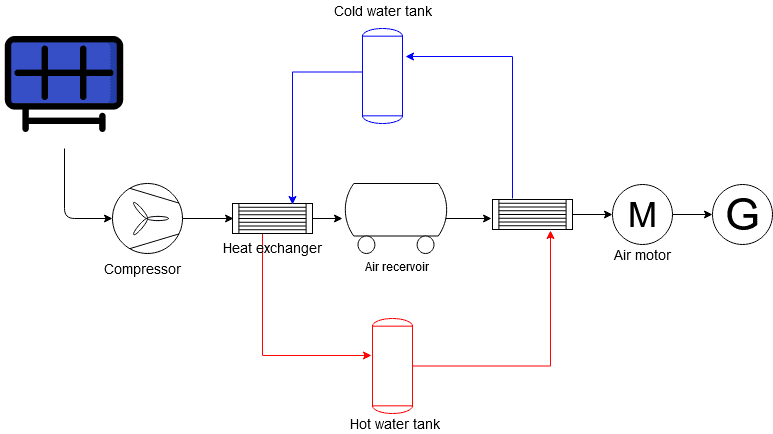

In my original post, I wrote that I have 11 kWh to be stored in compressed air and I want to know the required tank volume.
The compressed air will be used to run an air motor at 6.3 bar. Therefore, the minimum air pressure inside the tank should be 6.3 bar (Pm or P1 = 6.3 bar as described in the 4th and 5th expressions)
The maximum air tank pressure is 10 bar (P2 = 10 bar) and of course P0 = 1 bar and T0= 298 K. What would be the required air vessel volume?

As @anorlunda mentioned, I consider the system shown in post #7.
My question is simple.
When I have 39600000 J (11 kWh) energy used to compress air where the minimum pressure is 630000 pa (6.3 bar) and the maximum pressure 1000000 pa (10 bar) and pressure ratio = (10/6.3).
The first and second equations in my post gives the same 430.3 m3 required tank volume while the 3 equation give a 86 m3 ! the 3 equations should represent isothermal compression. What is the cause of this ??
My second part of the question about adiabatic compression which should be presented by equation 4 and 5 in my original post.
When I use the same inputs of compression energy 39600000 J, K= n = 1.4, P0=101325, T0=298 K, P0 (pressure outside the vessel) = 101325, minimum pressure = 630000, maximum Pressure = 1000000 pascal. The required volume = 50 m3 and 46 m3 using equations 4 and 5. Why this difference ?
Please bring me up to speed. How is the system in post #7 supposed to be operated? I don't want any numbers. It's supposed to be a temporary energy storage facility by somehow running the compressor during peak times and transferring some of the energy via heat to the water. Then, later it is recovered from the water and input to the air to run a generator. Please provide qualitative details on the operating procedure for such a system.
As you mentioned, extra electricity from the PV plant will run the compressor to compress air to the receiver to be used offpeak. The heat generated during compression will be saved in the hot water tank to be used during air expansion in the air motor. Cold water from the air expansion will be used to cool the air during compression.

The first two equations given in your post #1 for an adiabatic compressor and tank assume that the pressure coming out of the compressor is always equal to the final pressure that will be present within the tank at the end of the process, while the pressure in the tank during the process gradually builds up to this final value. To operate in this way, there will be a throttle valve between the compressor and tank to drop the pressure from that emerging from the compressor and the current pressure within the tank. This type of compression results in a dissipation of mechanical energy and a lowering of efficiency.
On the other hand, the analysis in post #12 for an isothermal compressor and tank assumes that the instantaneous pressure coming out of the compressor is essentially equal to the current pressure within the tank at all times during the process. So the pressure within the tank and the exit pressure from the compressor build up gradually during the process, and there is no throttling with accompanying loss of efficiency and dissipation of mechanical energy. It is possible to analyze the adiabatic operation under this same mode of operation, which I will now do.
