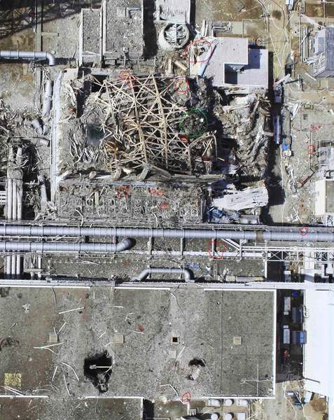

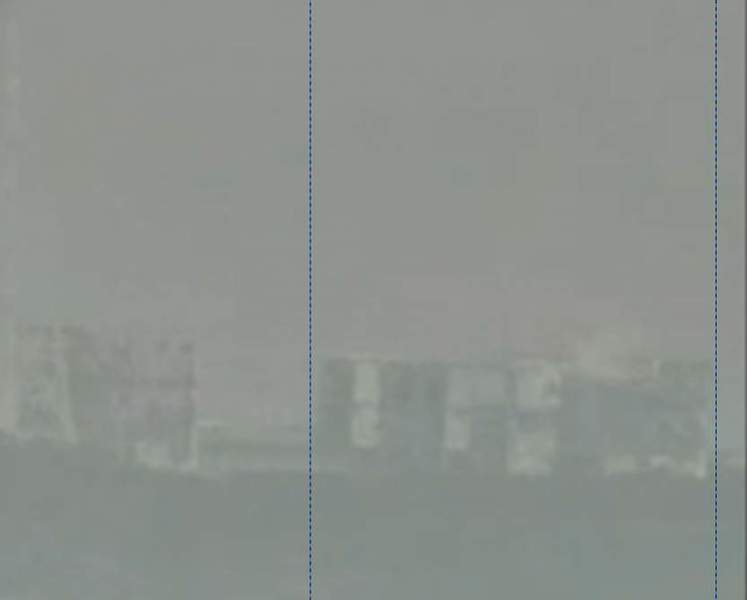

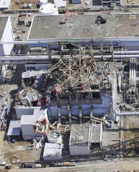

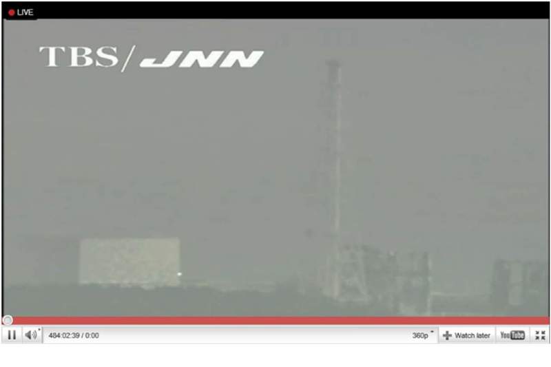

Emreth said:
You are a new poster here and i understand you haven't gone over the thousands of posts. All the things you mention were discussed here a while ago and debunked basically.
Reactor 3: The big blast is not directly related to the destruction of the top parts of the reactor, there were images posted here that show it's still there, with a crane collapsed over it, and steam escaping from the connection chute between that and the SFP. Also notice that the truss structure over the containment is intact unlike over the SFP. The thermal imagery, somehow surprisingly paints a rather rosy picture, with nothing substantially warm. A lot of seemingly hot spots arise from changes in the range of the IR measurements, with debris lying around at essentially ambient temperature. There are hot spots (70degC) over the SFP and the leaking parts from the PCV but that's about it, the rest are more or less cooler than a human being (less than 36degC), if a person was there it would be glowing red.
I've been with this discussion pretty much since the start and the possibility of the No.3 explosion originating in the primary containment and blowing off the containment plug has NOT been debunked; it has been debated with no clear consensus so far.
Cire said:
I don't believe this occurred. At the time of the explosion TEPCO was pumping in water using a fire engine. You don't overpressure a massive pressure vessel and not have a nylon fire hose still attached to the feed line not burst. If the RPV over-pressurized then every pipe, fitting, connection to the reactor with a lower pressure rating would have gone first, followed by the RPV assuming it didn't depressurize fast enough.
The RPV is approximately 6 inches thick. The pressures required to yield a 6 inch thick piece of steel even at elevated temperatures is huge. I understand the reactor has an operating pressure, but the failure pressure is much higher.
The failure mode of an over pressurized reactor with a corium slag at the bottom would be to fail the bottom of the RPV. This is the same failure mode you see when a water heater fails. It looks like this..
If that occurred with the reactor we'd be looking at the reactor vessel sitting somewhere outside of the building.
This is why you design the system to fail anywhere but the RPV.
I'm not going to dig up the maths again but under reasonable assumptions the explosion that destroyed building 3 had enough overpressure to exceed the RPV operating prerssure by 2-3 times.
Corium melt dropping into the drywell is NOT the same failure mode as a water heater. The steam and Zr-H2o explosion would cause a pressure rise outside the RPV and the explosion could bypass the RPV, which does not fully occlude the primary containment.
The mechanism of the building 3 explosion remains open, but any explanation MUST explain why it is clearly different from the explosion in builkding 1.
