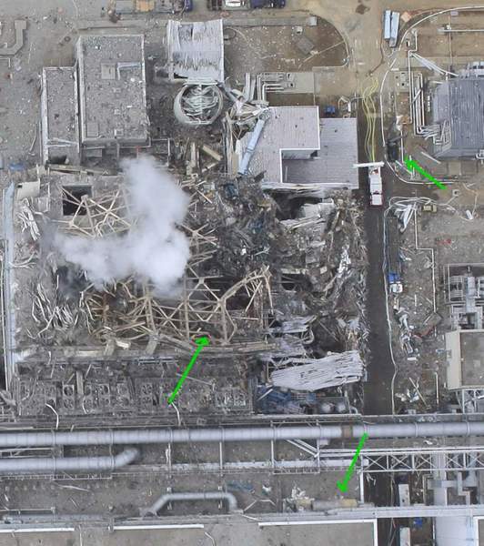

AntonL said:
and these solve the mystery of the "ballistic" fuel handling machinery in unit 3, submerged in SPF3

From the latest cryptome images, http://cryptome.org/eyeball/daiichi-...hi-photos8.htm
Is it just me, or does the semicircular item with a stepped edge look a bit like the half of the concrete plug that usually sits over over the reactor?
It is of course difficult with possible perspective and scale unknowns
Edit1... AntonL you beat me to it !
Edit 2 the actual plug appears to be approx 6.5m radius. Can anyone identify something to scale from in the photo?
The white roof panels - aren't they 70cm wide? Not sure anymore.
I have problems to correlate this pic with the other areal pics of R3.
