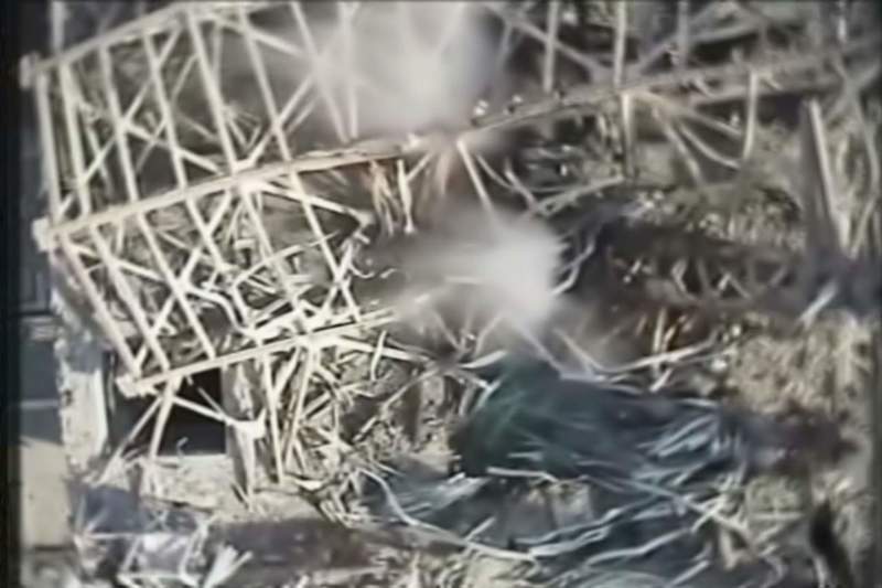

SOMETHING FOR CONSIDERATION: DID THE EXPLOSION AT UNIT 3 SUCK?
Suppose, just for grins that something like this happens . . .
1) SFP3 and SFP4 are boiling and fuel is beginning to be exposed. Hydrogen is building up above the service floor of both Bldg 3 and Bldg 4
2) a large blast (pick your origin, mine is the primary containment, through the fuel transfer gate), epicenter SFP3, southeast corner of Bldg 3 occurs
3) the initial strong shock wave not only blows the blank out of Bldg 3's southeast corner, but also damages the structural integrity of the north face and NE corner of Bldg 4 perhaps not readily apparent in the satellite images that seem to show Bldg 4 intact, but let's speculate -- cracks in the concrete at the northeast corner. Bldg 4 is no longer air tight at the northeast corner.
4) a large Vesuvial plume of steam shoots straight up from SFP3, making, yes, Ross Perot's "giant sucking sound" at ground zero, between Bldg 3 and 4.
5) the vertical blast sucks the air from Bldg 4, through the structural cracks and perhaps through the fuel loading access tunnel. There aren't many doors or windows in Bldg 4, after all.
6) the accumulating hydrogen gas originally inside the upper level of Bldg 4 is not ignited, but instead, is sucked downward, perhaps toward the northeast corner of Bldg 4, by the secondary negative pressure.
7) after the blast at Bldg 3 subsides, any residual hydrogen gas still in the lower levels of Bldg 4 again rises, forming pockets of trapped hydrogen gas along the ceilings of the various compartments in the building surrounding the primary containment. Someone in an earlier post noted that the internal doors closed during operation might be open during "cold" service of Reactor 4, with fuel off-loaded.
8) SFP4 continues to churn out hydrogen, eventually re-filling the upper portion of the building with more hydrogen gas.
9) at some point, something ignites the accumulated hydrogen gas in Bldg 4, probably something hot in SFP4, and then,
10) the resulting blast propagated throughout the entire building, blowing out the upper and lower portions of Bldg 4, and in particular, finishing the job started at the northeast corner and north face of Bldg 4 by the initial shock wave of the blast from SFP3.
How's that for a SWAG? Also . . .

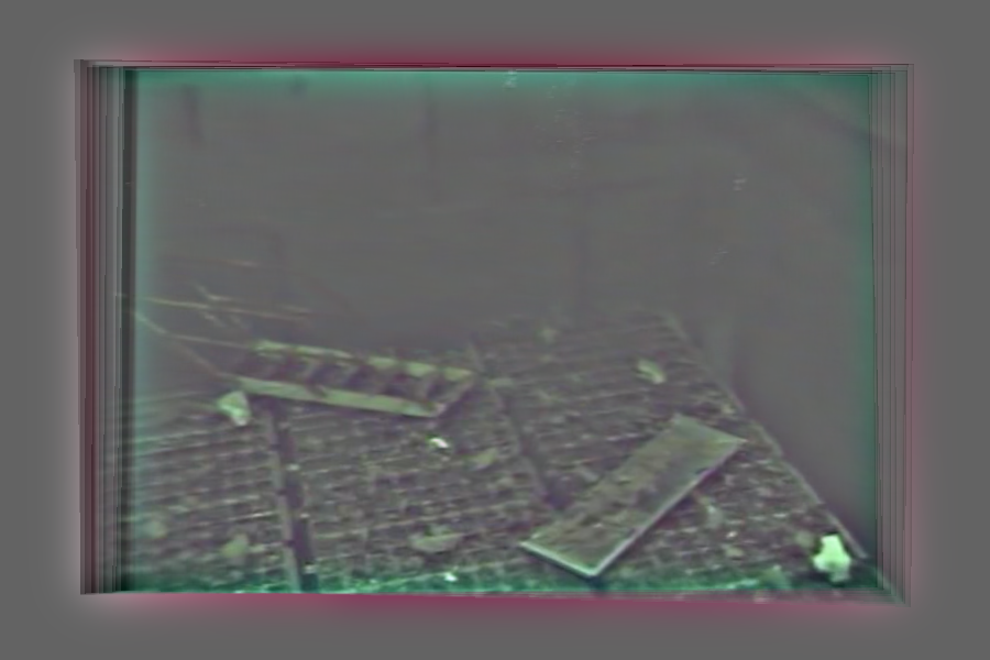

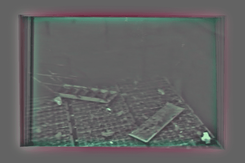

TCups said:
The thermal image originally posted was this one. I have recombined the window/level scale and annotated what I see as Bldg 4, Bldg 3, Tower, and Pipe (darker = colder = water in pipe?). The pipe just to the east of the tower is near ambient temp (empty). The only hot spot between Bldg 3 and Bldg 4 (circled) is relatively small, east of the pipe next to the tower, and only somewhere near 25ºC.
Agreed except the position of the hot spot, where I think the perspective may be cheating you. The thermal camera is looking down from the east at the hotspot, in a line that goes towards the foot of the tower, but under the pipe.
If the thermal image pre-dates the "cleaned up" image <..>
It doesn't, I should have made the date-marking clearer. The 'before cleanup' image is from March the 20th, the 'after' from the 24th, and the thermal image with the hotspot is from the 25th.
I see nothing on the thermal image even vaguely resembling a truck, blocking activity or otherwise.
Neither do I -- I see just about what I would expect if there were a fuel rod there. :-) Someone else said that it probably was just heat from the cleanup truck, and that would explain why we see no hotspot on the later images.
However, what I said is, the later thermal images indicates that a firetruck has taken station under the pipe, obscuring the view to the position of the hotspot. This _too_ would explain why we don't see it on the later images...
(A third explanation could be, someone removed it, but that's too simple :-)).
I have attached a photo making clear where I think the hotspot is.
