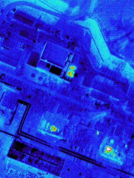

Giordano said:
Concrete truck?
No, the resolution is actually pretty good, but there is "blooming" of the heat signatures. The hot object is probably about 25ºC and looks to be about where debris have been cleared and a new "plate" of some sort is now on the ground, near the center of this photo.
In the thermal imagery, you can see the pipe, the tower, and actually, a fair amount of ground detail in the blue scale.

Giordano said:
Concrete truck?
I don't think so. The thermal image with this clear hotspot in the yard between unit 3 and 4 was taken somewhere between 6.34 am and 07.19 am on March 25th. It was a cold morning, as you can well see from the image, only about 2 deg. C. The location is right under some huge pipes, not exactly where one would think to place a concrete truck. Anyhow, Tepco states clearly that the concrete pump was not used at that time for doing anything to unit 3.
'Today's work for cooling the spent fuel pools
- At approximately 5:35 am, we started injecting seawater into the fuel
spent pool of Unit 3, using Fuel Pool Cooling and Filtering(clean up)
system (FPC) and finished at 4:05 pm.
- At around 2:35 pm, spraying to unit 4 by concrete pump track and
finished at around 5:30 pm.
- We are considering further spraying at other units and others subject
to the conditions of spent fuel pools.' (Tepco press release on the morning of March 25th)

Giordano said:
Concrete truck?
Something big, hot - and mobile, that's for sure. The other thermal images shows no hotspots at the same point.
But: there are earlier aerial photos (I could not find the date, but here is a link: http://cryptome.org/eyeball/daiichi-npp/pict6.jpg), showing a broken pipe of the venting system and some debris near the hotspot: and on later images the same pipe is near the reactor building and the area is clean from debris.
So: I think the thermal image shows the truck which cleaned up the area.

MadderDoc said:
The pixel-resolution of the thermal imagery I've seen spares about 0.2 m/pixel on the ground. With dispersion and such the real resolution must be worse, I'd reckon no better than 0.4 m/pixel and I think I am being generous.
Anyhow, what is that thing we see glowing -- all alone by itself :-) -- between unit 3 and 4, on the imagery from March 25th (attached thermal image and scale)?
? Are we talking about the same thermal image?
https://www.physicsforums.com/attachment.php?attachmentid=34365&d=1302808699
If so, then I don't see anything even near the size of a concrete truck between Bldg 3 and 4.
Are you referring to this thermal image attached to the original post asking about the object between Bldg 3 and 4?
If so, something is way off. Nothing remotely resembling a truck is in this thermal image.

Giordano said:
Concrete truck?
I do believe the area had been cleared for passage already by March 24th. See 'before and after 'cleanup'' attached. The position of the hotspot is at the far foot of the exhaust tower.
On later thermal images, it appears that the pool has been regularly douched from a firetruck about at the time of thermography, and the truck blocks the view to the hotspot.
OK, understand, but - - -
The thermal image originally posted was this one. I have recombined the window/level scale and annotated what I see as Bldg 4, Bldg 3, Tower, and Pipe (darker = colder = water in pipe?). The pipe just to the east of the tower is near ambient temp (empty). The only hot spot between Bldg 3 and Bldg 4 (circled) is relatively small, east of the pipe next to the tower, and only somewhere near 25ºC. If the thermal image pre-dates the "cleaned up" image, then the hot spot is about where a large square of metal plate or plywood has been laid. I see nothing on the thermal image even vaguely resembling a truck, blocking activity or otherwise.
I have rotated your before/after clean up image to match the orientation of the thermal image, though the angle is different, and I have indicated the approximate location of the small hot spot between Bldg 3 and 4.
