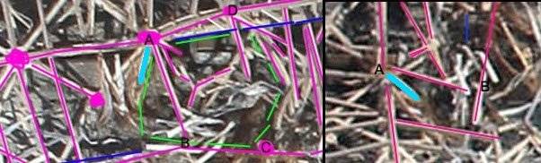

The northeast corner of Bldg 4 is odd, for sure. I don't believe it was the whole roof that lifted -- maybe the northeast corner might have had that effect. But if so, why?! What happened in the northeast corner of that building.
@liamdavis:
Maybe you could lend your expertise here, sir. Also, can you comment on your assessment of the possibility that the concussion and shock wave from the Bldg 3 explosion might have done structural damage to the northeast corner of Bldg 4 that wasn't readily visible from the outside. Perhaps after the blast at Bldg 3, the northeast corner of Bldg 4 was simply the weakest link.
From the picture you attached I think nothing from inside the building has damaged the roof. Something has landed on top of the roof. It hit not directly from overhead, more a bit from the side, so it bend over the wall.
If you take a closer look to the object it is partly above the roof skeleton and the main part stamped into the building construction.
Where did you find this picture? I could not find any other images of this part of the building.

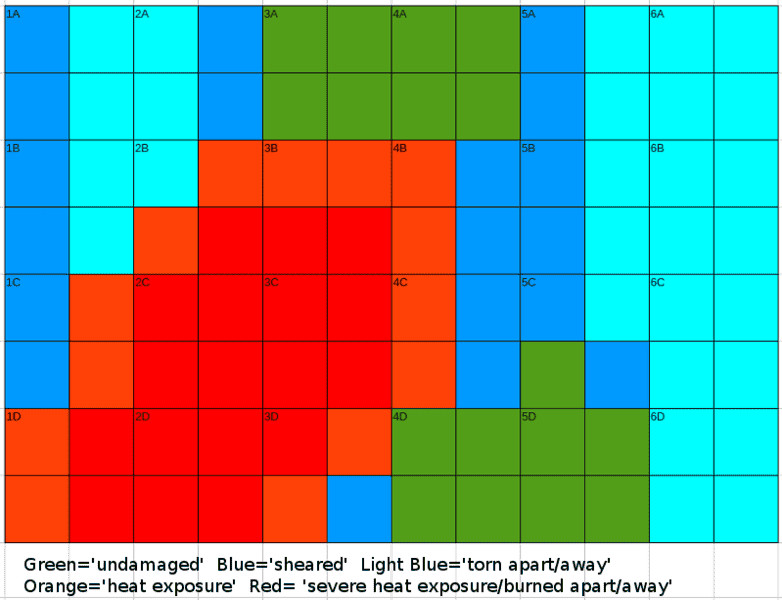

How this is possible ? Unit 4 core location is 5C more than SFP, how empty core can be so hot ?[/PLAIN]
Unit #4's SFP is almost completely covered by the fuel handling machine that crashed into it. Then there are roof beams etc. above it. So it is possible that the infrared image is seeing the water in the reactor, but not that in the SFP.

And my new image of #4:
[PLAIN]http://img535.imageshack.us/img535/3165/gggss.png

Well whaddya know . . .
Nullpunkt may be right. The damage to the northeast corner of Bldg 4 does look like an impact from something that fell on it. That would explain the north wall collapsing inward, except . . . what fell on it? If it is something from the explosion at Bldg 3, it must have had one long "hang time", or there was another explosion we missed. I guess you don't look for something if you don't think it could have happened.
@|Fred
Your the skeptic, Fred. What do you think? Does a falling object pass the "|Fred Test"?

Isn't the simple answer: Parts of the roof.
There must have been an explosion inside the building, including in the upper floor, everyone would agree. Both the walls, and the roof must have been affected by that explosion. The wall pillars and panels must have been pushed outward by it, the roof however must have been blown upwards.
So, in the moment after the explosion we have had a weakened pillar and wallpanels structure still standing below, and -- 100s of tons of roof in the air some distance above it.
What goes up must come down, so the roof did, and some of it incidentally on top of the north wall. And since the wall had already been buckled outward by the explosion, the next powerful hit from above could leave it only even more collapsed, and even further pushed outward.

RE: MECHANISM OF DAMAGE TO BLDG 4 (AND PROBABLY BLDG 3 ALSO)
Nullpunkt has it right. A careful look at the reasonably intact roof of Bldg 1 and the girder structure of Bldg 4 shows that the roof is in "patchwork" square segments that vary slightly in their shades of gray. The same patchwork is present on the north surface of the portion of the roof that fell into Bldg 4. Looking carefully, I believe an explosion (perhaps steam?) over the SFP 4 could have neatly peeled the roof off the building like the lid off a sardine can. Once the south end of the roof was lifted sufficiently high, the north end slid into the top of the building like a giant knife. It looks like a large slab of the roof was involved. A small portion of the roof has also impacted over the southeast corner of Bldg 4 doing structural damage there as well.
And PS: There is a second green crane or some type of machine inside the service floor of the north end of Bldg 4 clearly seen through the second open panel from the right.
And that said, I think all of the damage at Bldg 3 has to be re-assessed in terms of not the FHM going ballistic (perhaps portions did, perhaps not), but instead, the entire roof itself slicing down in a similar fashion on the north end of Bldg 3 as well.
Good call Nulpunkt!

GJBRKS said:
(Very OT , but if you would have seen just this picture 1 year ago without further info ,you would not have believed this could happen...I'm still amazed ...)
Odd lighting, for sure, and really poor resolution, but I believe the damage was already done. The photos are at different angles (about 45 deg vs 90 deg overhead), but I believe I can see the larger pieces of debris on the roof (small arrows), the X structure of the roof girders (rectangle), the inward bowing of the north wall, and the odd angle at the northeast corner (long arrow), even so.

MadderDoc said:
Isn't the simple answer: Parts of the roof..
Checking some pics:
http://cryptome.org/eyeball/daiichi-npp/pict10.jpg
http://cryptome.org/eyeball/daiichi-npp/pict12.jpg
http://cryptome.org/eyeball/daiichi-npp/pict13.jpg
http://cryptome.org/eyeball/daiichi-npp/pict46.jpg
Your explanation seems to be the only viable one if there was no late explosion in #3. However, I understand that the roof truss of #4 (still largely intact) was covered with narrow sheet metal strips (plenty of them around, some of them still in place) and then with a layer of tar/concrete. Your theory seems to require a continuous layer of thick sheet metal (or something that looks very much like it), covering at least a large fraction of the roof. There seems to be no such layer in unit #3 or its debris.
The object in question seems quite heavy and hard, since it bent several thick steel beams without itself shattering or crumpling. Would a concrete sheet behave that way? It also seems to have a couple of shallow grooves or ridges parallel to its topmost edge.
It could be an exploded boiler or tank from the lower level of #3, perhaps? Or a piece of #3's drywell dome?
On the other hand, I can believe that such a large piece of debris, falling sideways onto the roof truss, could have pulled the steel beams down, and they in turn could have pulled the concrete beam inwards.
The object is heavy -- yes, hard -- no. Isn't the flat roofing structure of most commercial roofs is something like corrugated metal with a thick layer of tar and pea gravel sprayed onto the metal substrate to form a heavy, watertight roof slab? Someone here must know commercial roofing, but I am betting the roof was fairly flexible, but heavy. And if the mass of the whole roof were lifted, peeled upwards largely intact and put in motion by a pressure wave from the explosion and then gravity, then that slab of roofing would have plenty enough mass and kinetic energy to do some serious damage IMO.
