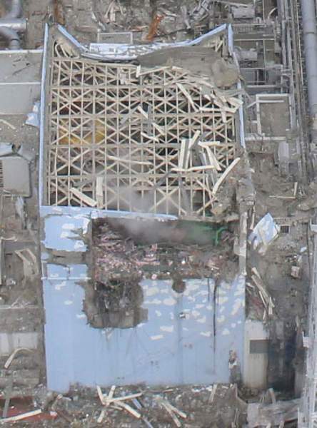

bytepirate said:
something else is very hard to explain:
if the hydrogen was produced by a zircaloy reaction, this means the assemblies must have been exposed to the air. right?
but there was no water added to the pool until 4 days after the explosion.
actually, they put big efforts to spray water on the #3 SFP, before they started with #4.
questions to be answered (find my answers in {}):
- was fuel in #4 exposed? {no}
- if not: could enough hydrogen have been produced (radiation decomposition, steam)? {no}
- if yes: why was the fuel covered after the explosion (why did TEPCO obviously did not worry about exposed fuel, + #4 was [only] INES 3 rated after the explosion [weak evidence though]) {i have posted a thesis on this before, but it is too weird to be true}
if the reason for the destruction of #4 was *not* hydrogen:
- could #4 has been damaged by an explosion in #3? {no}
- as no damage to #4 has been observed: was there a second explosion in #3? {no}
- if yes, what kind of explosion in #3 could have an impact on #4 as observed (must have been very directed, no damage to #2...)? {no}
- what else could have exploded in #4? {nothing}
if all my answers are correct, unit 4 has not exploded at all...
Cryptome.org has an assesment from the NRC where they say the fuel in the #4 SFP might have been partially uncovered , producing hydrogen :
http://cryptome.org/0003/daiichi-assess.pdf
  • #4,112
TCups said:
OK, but I meant what do you think about something having fallen into the northeast corner of the roof of Building 4?
I know I hadn't formulated answers to your question yet.
I like to speculate when I have some form of intimate conviction, and right now I do not and I'm not sure I clearly grasp the things that I'm seeing.
There is a second green crane or some type of machine inside the service floor of the north end of Bldg 4 clearly seen through the second open panel from the right.
I though I made this point 18 days ago and a fact two days ago :p
Once the south end of the roof was lifted sufficiently high, the north end slid into the top of the building like a giant knife.
Could you please clarify this , I don't picture it right
Odd lighting, for sure, and really poor resolution, but I believe the damage was already done. ...
agreed
simply from being superheated
how do you suggest this happens?, why wouldn't the watter just boil

The vertical position of the fuel handling machine of unit 4 appears to me to be about right, judged from the apparent spatial relationship between the hockey stick, the overhead crane, its rails, and the concrete pillars (taking into account that the hockey stick has been distally somewhat bent, see attachment)
Indeed. By the way, the "hockey stick" is not bent. Look closer.
However this seems to be the other end of the machine, which has a taller structure rising above the hockey sticks.

the lower part of the crane is (should be) about 2.5 m above the floor , it is not at present. The lower part or the crane is may be 70 cm above the floor.
I suspect the hockey stick to be slightly bent
edit: no I was using the crane from reactor 3 for reference and not the one on unit 4, I believe you are about right, the fhm crane is probably about where it should and no more than 1 m bellow where it should be

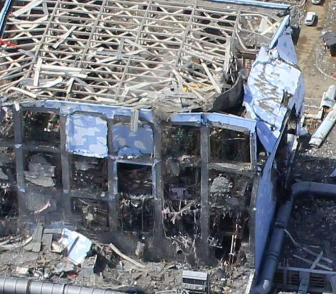

jmelson said:
Without some mechanism to force the water to remain still and not convect, I just don't see how this can happen.
After re-racking, the fuel assemblies are packed tight against each other into crates (each containing perhaps 7x7 assembles), and these are packed tight too. That is essentially a 4m thick fairly solid slab of metal, weighting several thousand tons. Water circulation is still possible through the fuel assemblies, in the space between the rods. There is some space below the layer of assemblies and along the walls of the pools.
I do not know whether convection through such long and narrow channels would be effective without external circulation pumps; http://www.irss-usa.org/pages/documents/11_1Alvarez.pdf" seems to address this question but its estimates seem rather crude,
Does someone know the disposition of cooling water pipes in the SPF? I recall a SFP model shown on NHK which showed two round pipes. One entered near the top of the wall, horizontally, made a 90 turn and continued down for a short distance. The other pipe entered vertically through the bottom, near the wall; went all the way up, then made an U-turn and went back almost to the bottom, siphon-like. I couldn't figure out which was in and which was out.
if that SPF model was correct, then perhaps the earthquake (which included strong and lasting horizontal shaking) shook loose the entire pack of fuel assemblies, which snapped the second pipe and perhaps created a leak through the pool's bottom. It may also have bent the supports that kept the fuel away from the bottom, causing it to settle and thus cutting off convection.
It is actually the same hockey stick, just seen from the opposite (reactor) side, see attachments. I've looked and looked, it still looks bent to me. But perhaps it's the perspectives fooling me.

Jorge Stolfi said:
I do not know whether convection through such long and narrow channels would be effective without external circulation pumps; http://www.irss-usa.org/pages/documents/11_1Alvarez.pdf" seems to address this question but its estimates seem rather crude,...
Yes, natural circulation through the assemblies is sufficient to remove the decay heat. I have seen such calculations for PWR fuel and I'm pretty certain that it is true for BWR fuel as well. In fact, in the typical design, the SFP cooling system removes heat from the bulk fluid while the assemblies are cooled by natural circulation (in other words, the cooling loop flow is not 'pumped' through the assemblies at all).

Fred's picture gives me an idea about what that thing is that landed on #4's roof:
[PLAIN]http://k.min.us/ikzpLE.jpg
From the coloring and shape, I am beginning to suspect that it is concrete wall panel from #4's own wall, that somehow got blown upwards to land on its own roof. Imagine, for example, a 2-3 "cells" high by one or two "cells" wide section of exterior concrete panelling being blown off the east wall, but still attached at the top for a while, allowing it to hinge up and over to land on the roof. (In fact, is that the pivot point below the capital "C" in Fred's "2: SFP Crane" label?)
The section could also perhaps have come from the west wall.
If true, might be supporting evidence for a below-decks (below the refueling floor level) explosion in building 4?...

  • #4,139
No, the simplest explanation is the correct one. It is a piece of the roof, right down to the little square holes than can still be seen in the roof. The roof has been blown upward on its south end, billowed outward, and crashed down into the top of Bldg 4.
Pre-explosions of the top of Bldg 4 confirm a pattern of the small squares -- whatever they are. Bldg 1 had a few as well. The curve of the slab exactly matches the damage to the underlying girders. The underside (to the south) is irregular from being blasted and torn from the underlying girders. The topside (to the north) still has its pattern of smaller square sections, as do all of the flat roofs at Fukushima.
https://www.physicsforums.com/attachment.php?attachmentid=34557&d=1303159967
https://www.physicsforums.com/attachment.php?attachmentid=34558&d=1303159967
No big green machines to confuse here -- that is a big slab of asphalt (or something like asphalt) roof lifted up and dropped on end, on the north side of Bldg 4, and it brought the north side face of the building inward with it when it cut in and downward.
See, for example:
http://www.gaf.com/Roofing/Commercial/Products/Modified-Bitumen-Roofing/Ruberoid-Modified-Bitumen-SBS-Membranes/Documents/Commercial_Full_Line_Brochure-13-719-v5.pdf
Oh, yeah, the drawing of what happened . . . well, think of it this way. Have you ever had a convertible with a folding top? Goodnight.
