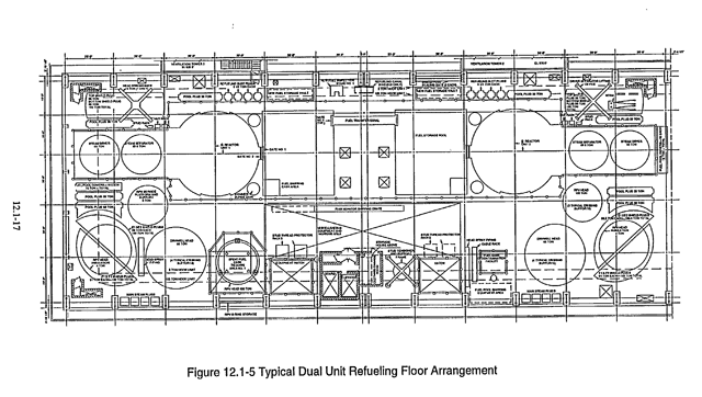

It does take a long time to search and you need some luck also. Many older documents have not been scanned into PDF format yet, and all you get for results are small 320-byte references to physical document numbers. I don't have the time or inclination to actually go in person to the NRC's reading room to look at physical documents :smile: or worse (microfiche), but if I did there are a few plants' drawings I would like to have a look at. You listed a few. Vermont Yankee and Millstone I are another two that I think are close to the Fukushima Daiichi designs.
There is a search option that's not listed there for minimum document file size that I worked out through trial and error (I think it's called $size:xxx) but it times out on most searches I tried. An option for "only downloadable PDF documents" would be very handy, but alas, it does not exist. Additionally, you are supposed to be able to check the boxes for several files on the left and download a .zip file that contains your selections. That doesn't work either; you have to download each one individually. It's got some bugs and quirky behavior, but overall I think they did a good job with the web-ADAMS search site. I'd rate it a solid 8 out of 10.
I suspect someone needed the Oyster Creek drawings in PDF form for some task in recent years and that's why they are available online.
After 9/11 many plant and site drawings were removed from ADAMS and were considered as Safeguards information. These drawings may have been missed or a mistake. Or maybe somebody finally figured that this wouldn't really help a terrorist.

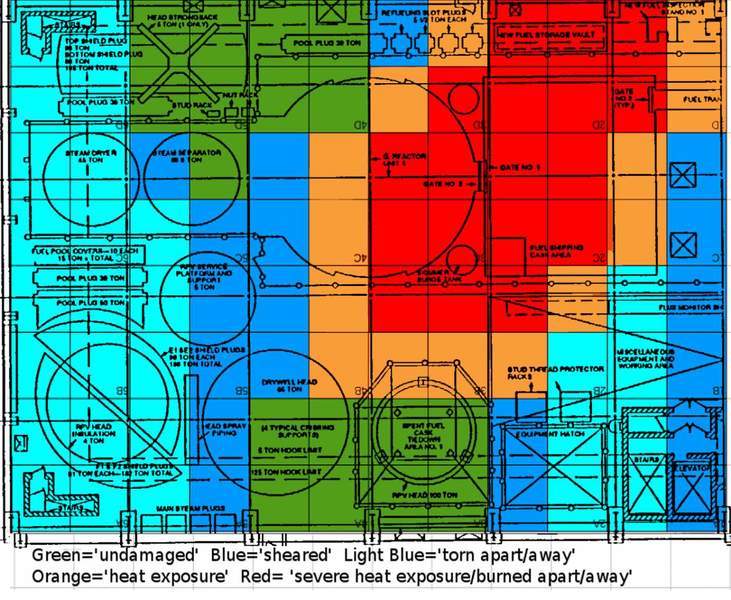

RE: THE EXPLOSIONS AND PATTERN OF DAMAGE AT BLDG 3 & 4 -- SIMILARITIES AND DIFFERNECES
@Fred:
M. Bachmeir did extensive analysis of the sound frequencies and concluded that Bang 1 and Bang 2 were similar and were explosions and that Bang 3 was fundamentally different from the first two, as I recall. Maybe he would comment again about the possibility of one of the audible bangs being a mechanical transient from a large falling object.
If FHM 3 is in the pool, (yes Fred, mea culpa, my initial scenario proposal was wrong and I do believe the FHM is mostly in the SFP), then the blast still had to be strong enough to lift it, de-rail it, and let it fall with enough force to hit and submerge completely in the pool, else part of it would have been visible above the water level. And if it is in the pool, then something either had to break or bend significantly on one or both ends for it to fit.
There is a lot of complex-looking green equipment in all of the reactor buildings, though, and fragments and various damaged parts of them are tough to identify visibly.
OBSERVATIONS ABOUT THE EXPLOSIONS AND DAMAGE PATTERNS
Whether FHM 4 is in its normal position or down by a meter or two is really less the point than that the overriding fact that the explosion at Unit 3 was much more powerful than the explosion at Unit 4. Whether it was none or part of the FHM3 that went ballistic is also not strongly relevant at this point, because, whatever it was that went ballistic, a lot of stuff did go ballistic, both vertically and horizontally, much more so at Bldg 3 than Bldg 4.
If one accepts the possible scenario of the damage at Bldg 4 being due to the asphalt roof, then it follows that the same mechanism was likely in play at Bldg 3, given a similar epicenter of the apparent explosion, over the SFP.
I am not so sure it was reinforced concrete, having red a bit last night about commercial industrial roofing. I believe the roofing material was flexible and water proof (concrete is neither), and that it was laid on corrugated metal which peeled off the roof girders, partially lifted, and then from a more vertical position, plunged into the north end of the building. Actually the analogy of the mechanics of a folding convertible car top coming up and over the interior of the car before folding back into the trunk space is a pretty good analogy, if you have ever had a convertible. Something very similar might have happened at Unit 3 with some variations.
The stronger explosion at Bldg 3 initially blew more of the roof apart and straight up. The stronger explosion more forcefully blew the more northern section of the roof higher and further back. The more northern portion of the roof, instead of crashing in a more or less large, intact slab, just into the norther end of the building as at Bldg 4, took out the north-facing upper wall completely, and much more extensively damaged the north end of Bldg 3 and the building below.
Step back and take an overall "big picture" look at the pattern of damage done to the roof and upper structures at Bldg 3 and 4. I believe that there are some pretty strong similarities in the damage patterns, except that, again, the blast at Bldg 3 was much more powerful.
Though I can offer no credible technical explanations for the "why and how" of hydrogen and steam explosion being involved at both Bldg 3 and 4, I can and do offer my revised scenario that the difference in total energy at Bldg 3 vs Bldg 4 was that of a hydrogen explosion coming from the primary containment at Bldg 3, and then, for whatever reason, to a much greater degree, the water in the SFP at 3 turning to steam than at Bldg 4, and that the visible damages were due in significant part to portions of heavy roof segments, not falling machinery.

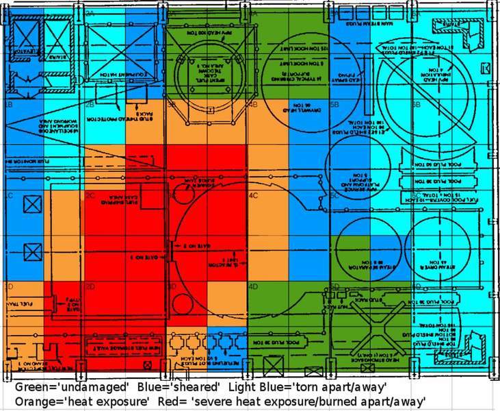

Could you please clarify I did not understood that scenario .. I'm probably failing at English there
@Fred:
You are testing my Illustrator skills perhaps like I am testing your language skills.
Think of the roofing material as a large, thick, heavy but flexible sheet of material backed with corrugated steel resting on top of the building (A)
The explosion rips off the roof from the southeast corner, and probably blasts some fragments of the roof upward (B)
The expanding gas from the explosion continues to lift the roof slab off of the girders and billow it like a sail full of air. More fragments of the roof are blasted away (C)
As the gas escapes, the weight of the what is left of the roof slab is borne by the north wall of the building. It begins to fall back into the building, dragging part of the north wall inward and downward (D)

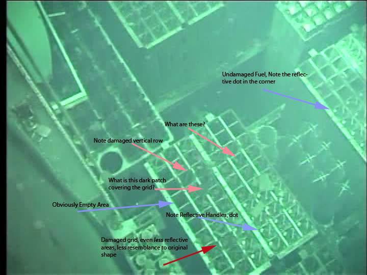

From the photos taken by the sampling camera, it looks as if the water in #4's SFP is hot and stirring. Could it be boiling? (The infrared pics show rather low temperatures --- but perhaps the IR camera does not have a direct view to the liquid?)
If the water is boiling, and the pool water is slightly acidic, wouldn't the iodine evaporate as I2 or HI? (I suppose that the cesium would remain in solution in any case).
Boiling doesn't mater. CsI may get attached to droplets carried off with steam but most will remain in the water. The use of seawater to keep the pools full should prevent acidic conditions in the pool.
If operators were able to get close enough to the pool to take a sample it must be well short of boiling.
If you've ever brought a large pot of water to a boil (e.g., home brewing) you see a lot of motion and stirring well before bubbles start to form. That is convection. When bubbles do start to form on the hot surfaces they may grow and break off but don't reach the surface because the bulk temperature is still below boiling. That is the onset of nucleate boiling (ONB). In a reactor when the surface reaches a high enough temperature a layer of steam covers the surface of the fuel and heat transfer is cut drastically. This dryout is the Departure from Nucleate boiling (DNB). That is the big difference between a PWR and a BWR.

And the containment part of the drawing is square shaped, with the core at the centre. The Unit3 has the RPV on the side closest to the turbines.
I don't KNOW, but I seriously doubt that this is about Unit 3.
http://translate.google.hu/translat....futaba.fukushima.jp/05-20000519/index41.html
At the foundation level, in the basement (where the torus is), the reactor is centered in the square. The upper elevations of the reactor building are not centered on the reactor, though. So the diagram probably shows the foundations.

Look closely at the horizontal debris tracks, the impacts on the front and rear facades of the turbine buildings, the horizontal debris tracks on the west side of the buildings, the damage to the buildings on the west side of the reactors, and the pieces of the wall slabs still laying about on the photographs. ALL of that came from horizontal outward blast of the wall panels. None of the wall panels went upward.
The only good candidates for vertical "ballistic" objects, IMO, were the FHM directly over SFP3 (now disproved) and portions of the buildings roofs (which seems a likely scenario at least for now).
Go way back to around to posts in the low #600's a few weeks ago and you will find lots of pictures and analysis.
OK, then if it's the basement where the torus is, where is the torus on the picture?
